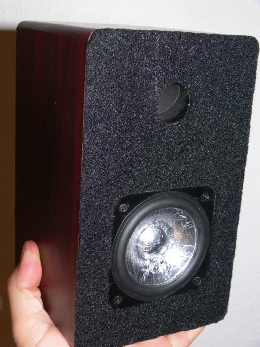

I had some very good results with four small fullrange drivers in a line array - this has really some advantages because the cylindrical wave.

I used four small fullrange drivers as you can see in the foto - same size like FRS8M but different ones. I really liked how they were listenable - I never built a line driver before but now I understand why it is so popular in public adress systems - often used as curved line array.

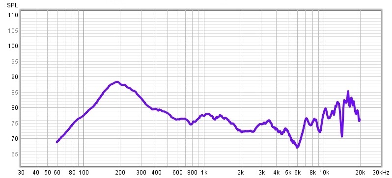

UPDATE: How did it work out?
I build a tall (190cm, 6'4") narrow box (12 by 17 cm, app. 5" by 6" )) with the 8 drivers in the upper end, hoping to make use of the boxvolume below.
I made measurements outdoors with REW (https://www.roomeqwizard.com/) and various vents - with no success.
I came to conclude, that the long narrow box dimensions made it impossible to avoid standing waves.
I sawed the lower part of the box off and made a satellite array instead.
I have used it for one small gig so far, and everyone was satisfied with the sound.
Only the male singer used it, so it worked without a subwoofer, which I am planning to build.
It rolls of at around 190 HZ. An outdoor narrow field measurement with REW and a reasonable soundcard and mike (Focusrite Saffire6 and Audio-technica AT2020)
looks like this (SPL not calibrated):
I have no explanation for the dip at 6kHz. It doesn't seem to correlate with any of the dimensions of the box. I'm to old to care about the dip at 15 kHz ;-)

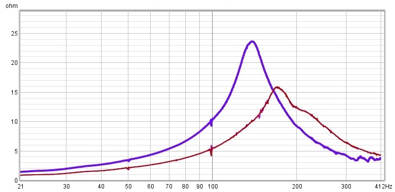

Impedance, closed box (red) and backside removed (blue):

For the record, impedance and the wiring (counting the drivers from the top downwards) is like this:
│8│ │8│ │ │ │1│ │6│ │
┌┴┐ ┌┴┐ │8│ ┌┴┐ ┌┴┐ │4│
│8│ │8│ └┬┘ 6.9Ω │2│ │7│ └┬┘
┌┴┐ ┌┴┐ │8│ ↑ ┌┴┐ ┌┴┐ │5│
│8│ │8│ └┬┘ │ │3│ │8│ └┬┘
1 1
ΣR=──────────────── = ─────────────── = 6.9Ω
1 1 1 1 1 1
R1 R2 Rn 24Ω 24Ω 16Ω
