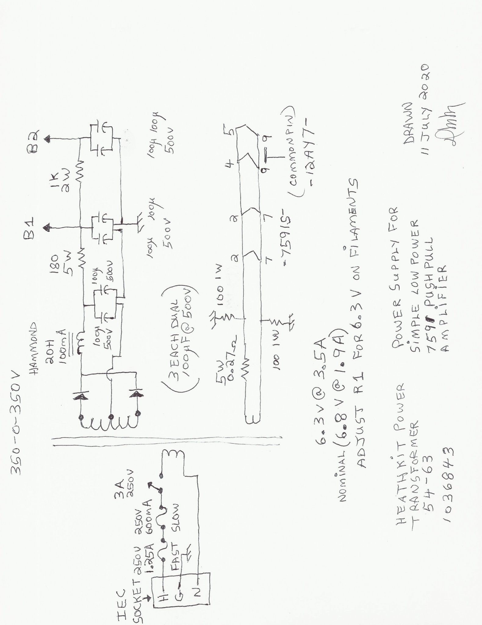

A Simple Low Power 7591 Push Pull Amplifier
I designed and built this amplifier.
Quite a while ago, I mentioned it to one of the members of this Forum.
He was interested in seeing the schematic.
I apologize to him, it took me so long to document it on this forum.
I am not a software geek.
You will have to print the schematics out if you want them.
Then you can rotate them so that they are easier to read.
Warning / Caution: This amplifier has Dangerous Voltages, both at the Mains Power side, and at the B+, tube plates, tube screens, and output transformer primary, etc.
Changing parts for different ones may cause fire, etc.
All building, using, and modifications are at your own risk.
I am not responsible for your actions.
If you see an error in my schematics, please let me know; ask a question, etc.
I am subject to making human errors.

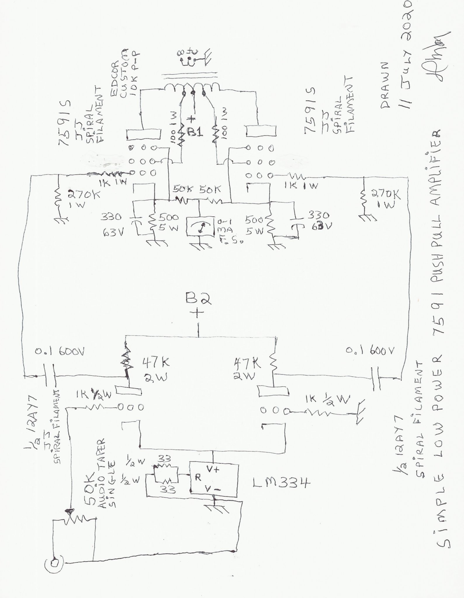

I believe it is an indicative representation of a current measurement point.
Initially I assumed cathode current, but it appears to be to measure Suppressor grid current.
I'm not entirely sure why you would want or need to measure G3 current/current balance.
There may be a very good reason, especially in PP output stage, but I have exactly zero experience of PP, so I can only guess hehe.
Maybe the OP can explain?
I wanted to monitor the total cathode current (plus hopefully very low Beam Former currents) of both output tubes.
I already did Individual tube measurements when I bench tested the amplifier.
(I am very careful to make sure the currents in the OPT are very well balanced).
A simple switch and two 25k resistors would have allowed individual measurement.
But it would have violated my idea of making this a Simple Amplifier, including easily looking at the total current from across the room (no button pushing/switching required).
If there are any changes in one or both tubes, I will easily see it.

Note: I gave up drawing "glass" envelopes around tube symbols decades ago.
The 7591 does not have a Suppressor Grid. And I gave up drawing Beam Formers decades ago (Sorry, I can see how I caused confusion in my schematic).
The 7591 Beam Formers are Internally connected to the Cathode.
You can not measure the Beam Former current by itself (not unless you open the tube, disconnect the Beam Formers from the cathode, bring the Beam Former connection to an unused header pin, have a glass factory, a special welder, a vacuum pump, and an RF Diathermy heater).
Oh, I forgot you need the proper substance to re-fill the "getter trough").
I do not re-build or modify vacuum tubes. I only build and/or modify amplifiers. Ha Ha

Nice.
Damping of 1.5 is definitely low, but I'm sure you expected that from a UL output with no NFB applied. Have you listened to it? What kind of speaker is it intended to drive?
I suppose the normal way to finish this up would be to add some NFB, probably global. Were you planning to add some?

I fully expected the low damping factor when I designed and built the amp.
I did not want any negative global feedback, negative Schade feedback, etc.
I only wanted to use either Ultra Linear negative feedback, or Triode Wired negative feedback.

That's pretty unconventional, but hey, I believe you! That's a wide variety of speakers. EPI 100? I remember those. That's pretty small, but speakers had higher sensitivity back in those days.
The only UL amp I tried without gNFB was a Dyna ST70 that I rewired to a 6SN7 LTP into push-pull 6L6GCs. I had originally intended to use it triode-wired but gave UL a whirl. The UL wired version sounded too brash to me. I added gNFB and then it sounded like pretty much every other PP tube amp, so I lived with it triode-wired for a while. Then I tried a couple other things which didn't really float my boat, so now it's on a shelf, waiting for the next experiment.

Removed Negative Feedback, left it UL (damping factor about 1.4), the pentode driver struggled with that, at such low self bias voltage, and no negative feedback to push the cathode voltage up when the 8 Ohm output went positive (lost dynamic range).
Triode wired it, the pentode driver was too wimpy for that.
In that order.
Then I removed the output transformers, separated the Es and Is, and used an air gap,
and one EL34 per channel in single ended, with cathode feedback from the 16 Ohm tap (and the primary was connected out of phase to make the cathode feedback negative).

I re-opened this thread, because I performed some modifications to the amplifier.
1. Triode Wiring the 7591 using 100 Ohm resistors from plate to screen (the amp is no longer Ultra Linear).
2. I changed the B+ from a strict choke input filter to a "motor start" capacitor input filter (2 uF).
That raises the B+ voltage, and because it is now Triode wired, it increases the plate current. That increases the cathode current which increases the self bias voltage. The gain of triode wiring is lower than Ultra Linear, so a little higher bias voltage gives a little more power output than lower bias and lower B+ can give.
Perhaps I will do some re-measurements; It will have lower power than Ultra Linear, but it will have a little higher damping factor than Ultra Linear.
I am attaching rotated schematics, I hope you can read them easier.
Note: I did not change the schematic, the screens now go through 100 Ohm resistors to the plates; they do Not go to the Ultra Linear taps; and I did not draw in the 2uF cap input filter that is right after the rectifiers.

Yes, I'm curious... Why not apply 6 to 10dB global NFB to the ultralinear wired version, rather than rewiring the outputs to triode?
Of course, you might just prefer the sound of the amp with the outputs wired triode, which would make sense to me! 👍
The problem may be that the bigger input swing and a high gain 12ax7 may push the LM334 outside its voltage compliance range. Maybe a current mirror would be needed or the grids lifting, or a bit of negative supply from say from the heater supply.
