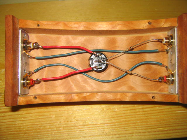

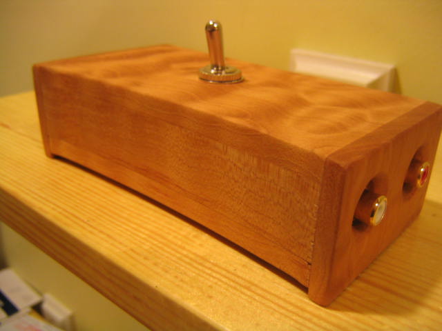

The primary reason I built this switch was to test separate speaker prototypes, but I think it would work very well for A/B testing of amps by simply adding a Y-cable to the outputs.
The inputs take the L/R channels from any source. Each then passes through a 10k Ohm resistor (mine measured an identical 9.83k Ohm) and connects to a SPDP toggle switch, with the output going to two RCA's at the output. All RCA's maintain a common ground.
Since the inputs are combined at the switch, the signal is in mono, but if you test using reference music or somthing you are very familier with, you will at least hear the entire recording, not just what is on the left or right channel.
All parts are from Radio Shack. Parts ran about $7. They assured me the switch was a "make before break" design. In actual use, the switch adds absolutely no pops or breaks in the sound whatsoever.
I hope everyone finds this useful.
Doug
ps: I will cross post this to the Full Range forum.
Interior shot:

Newbie questions: May I ask,
1. What is the purpose of the resistors?
2. Why did you made it with solid wood?

Senderj,
I'll leave #1 to far more qualfied people than myself.
As to #2: I like wood, I had the wood, I know how to work with wood. I do not believe there are any RFI or grounding issues involved. I don't think it makes any difference what enclosure you use.
Hope this answers your question.
Doug
