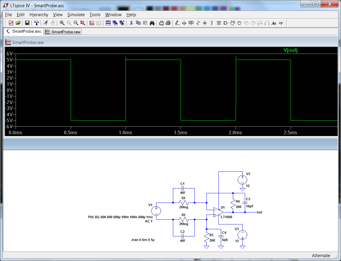

I also include the sim file:

Now let's talk about performance.
Here is the 10KHz squarewave response:
It is somewhat rounded, but perfectly recognizable. The measured -3dB bandwidth is 1.5MHz, with a LF356 as opamp and the crude compensation shown on the schematic.
The behavior is almost identical with a LF411 or a TLO71.
This means that the bandwidth is primarily limited by the compensation, not the opamp itself, and before upgrading to a faster type, the compensation should be refined.
The compensation relies on the self-capacitance of the input resistors; this capacitance is not only very small, but it is also "impure": because of the distributed coupling to the opposite side, the PCB and the ambient space, it cannot be compensated by pure, lumped capacitors.
If you want to exploit the full bandwidth of the opamp, you would need a number of RC networks instead.
I didn't take the time to tweak this aspect, because it was not needed for the application in mind, but it is probably possible to gain one order of magnitude with some patience.
On my prototype, the LF CMRR is about 60dB. It begins to degrade as of ~25KHz.
The LF figure can be improved with a tighter resistor matching, but it will be difficult to improve the HF performance: the degradation is caused not only by the opamp itself, but also by the layout: it is very "open" for safety reasons and the insulating case makes it sensitive to proximity or hand effects.

This probe would also be perfect for work on tube power amplifiers: its limitations would not be problematic there.
For preamp work, the impedance is too low, and 10Meg or higher should be used.
