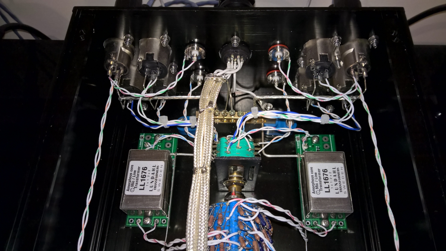

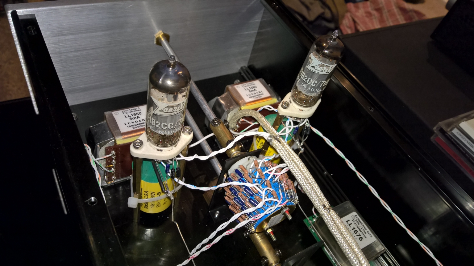

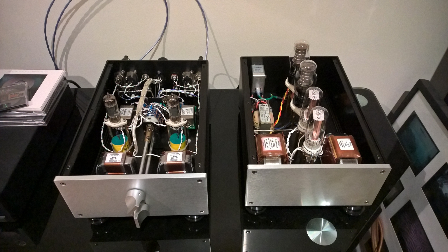

Hello,
A project nearly three years in the making, half of that convincing myself to invest in lundahl iron. But definitely worth it!
I spent more time planning the layout and sourcing hardware for the final layout than on the construction itself. That said, a simple looking circuit on paper turns out to be an exercise in good signal and power wiring layout.
I used the CCS from the Impasse preamp which works well, and have been swapping OD3's to match each channel's voltage regulation (not a big deal).
This is my 3rd valve preamp (have built a Nuvistor (tnt preamble) and a balanced 6SN7 in the past) and I have to say that this is a big step ahead in sound quality (which I thought I had found in the 6SN7 preamp).
It's dead quiet, and going through some old albums I'm hearing a lot more.
To me, It just sounds GOOD.

Hi Shane,
Yes, copied straight from lynn olsen's schematic:
http://www.nutshellhifi.com/Raven-MarkII.gif
6CJ3 rectifiers take about 15-20 sec to ramp up. The E182CC's have a seperate heater transformer configured for 6.3vac.
I haven't tried 7119's yet, so I'm keen on the ones you have. 7044 are close in spec, I'm keeping an eye on ebay but exchange rate dependent.
Also haven't tried 5687's but interested.

Can you tell me more about the umbilical connections?..
I've being using Neutrik but they seem limited to three pole in the higher power rating (but very good).
Shane
I had trouble as well but settled for these including the panel mount connections (Hirschmann brand):
Plug Hirschmann C16-1 6 Pole + PE Line Plug - Jaycar Electronics
I had some shielded, 5 core cable from a work installation that's 300v, 80ºC and 3A current rated. 2x 150v rails, heater, sig gnd and mains earth.

I've received the valves, and I'm running the 7119's.
They sound good just like the e182cc's. They also didn't need bias adjustment in circuit, correct cathode bias and even HT through the primaries.
Haven't tried the 5687's yet, I want to listen to the 7119's for a while.
