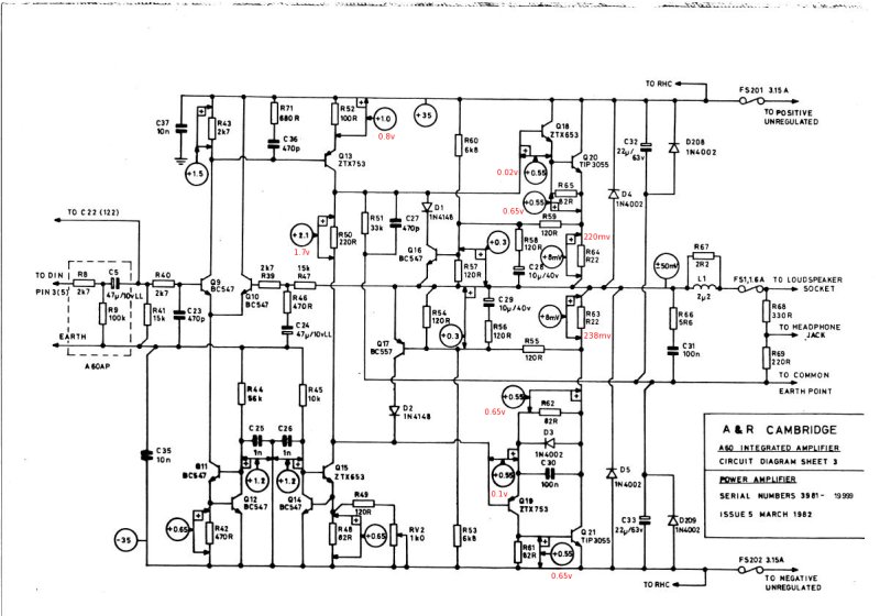

Have replaced blown output transistors, placed 15R resistors across rail fuses as per service manual but the quiescent current is far too high.
Seems the culprit is still there...
Anyone wanna take alook at the schematic and give me some pointers?

If the outputs blew it's likely that the driver transistors are damaged too. Check these - Q18/19 on left, Q118/119 on right.
You will need to adjust the quiescent current whenever you fit new transistors. This is done by adjusting RV2. Honestly, I don't like the way the bias circuit works on this amp, but thats how it works as stock!

it still looks like there is a fault with Q18/Q19 - there is not enough Vbe voltage for these to conduct if they were working normally
Check the 2 current sources are working (Q11/12 and Q14/15 probably OK)
Also the voltage across R43
Also voltage to gnd at R50 ...
My guess is that Q13 is toast maybe taken your replacement Q18/19 with it 😕

Q9,10,11,12 replaced (I had plenty of bc547s lying about).
Fire it up, everything seems normal, quiescent current bang on the book 🙂
20 seconds later back to square one :-(
I replaced Q13 at the same time as Q18/19
I assume this is a thermal issue as if I leave it off for a couple of minutes I get a repeat performance.

Either a dry solder joint or a leaky electrolytic ?
Are any of the signal transistors getting noticably hot ?
At this age its probably worth replacing the 3 small electros on each channel anyway, they won't see much polarising voltage and may well be leaky by now. Still, i can't see how thay could cause the problem you are seeing
