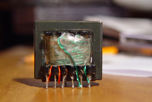

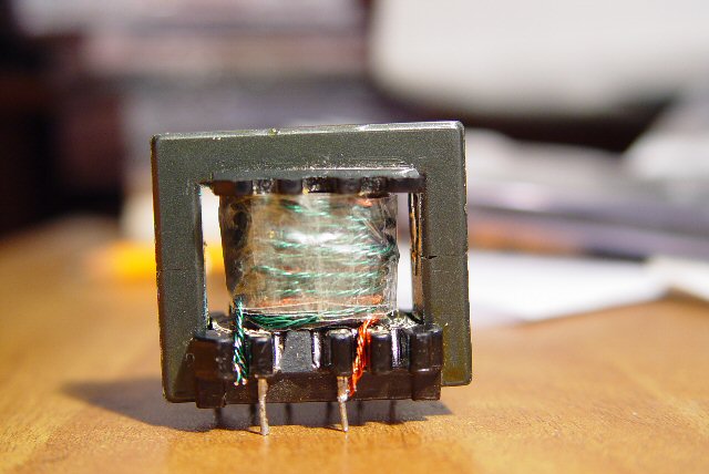

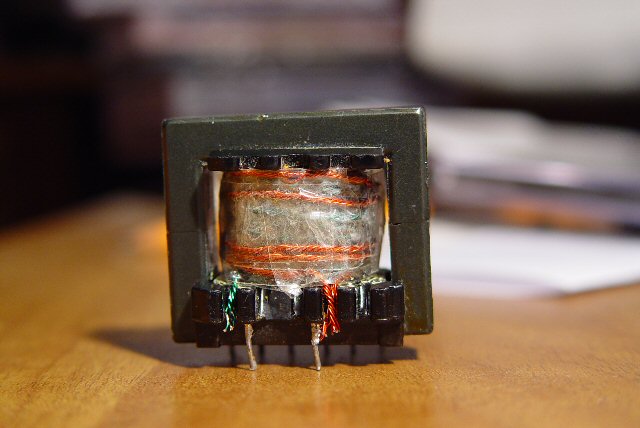

What's R12's purpose? Its commonplace to tie the secondary CT to ground.
Given the output is significantly higher than what you were expecting, it sounds like the turns ratio is off a bit.
If the output isn't symmetrical with respect to the CT, are you sure it's really in the center? If so, it sounds like you don't have a good square waveform. I suppose a crippled rectifier could also cause asymmetricality, but certainly it would overheat to cause that much difference. Are the diodes fast enough to work at your switching frequency?
I don't know much about PWM controllers, but that looks like a heavy load for it to drive directly. Is the SG3524 capable of that much current?
Have you tried the circuit without regulation?
The big question: do you have a 'scope to snoop around with?
