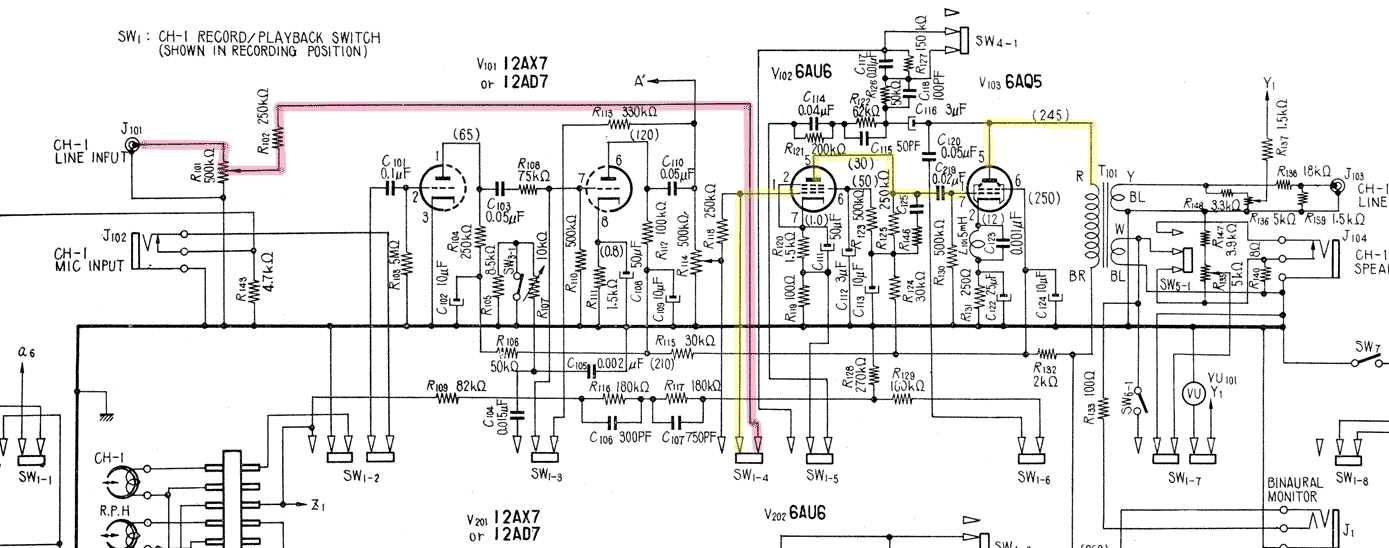

It may be heresy, but i want to run my iPod through the Aux IN.
I can't get any sound out.
What could I be doing incorrectly?

It can only be one of a couple things,
Make sure you have "AUX" selected on the TC500.
Are they DIN connectors on this or phono ? If DIN make sure correct pins used.
Whatever you should be able to "buzz" the inputs with a screwdiver etc to prove they work and identify them.
If that's OK then what output are you using on the IPOD (I have never used one 🙂) Make sure you turn the volume up if you are using headphone out.
Can you get any other device to work correctly through the AUX inputs ?
Do you have to turn the record level up or put it into record mode ?

Have I misunderstood?
It occurred to me since I posted that I've just asssumed that it has an ability to amplify an external (AUX) source.
In fact it could be that it is just an AUX in to the record heads.
If that's the case then I may have to run a dummy tape on record.
Not what I was trying to do!

Doug,
It may have to be in record mode. IIRC, when i was running (one of) mine before disassembly i had to jumper the switch to avoid this.
Attached is a snippet of the map. (i have the whole thing (big))
dave
So ... to modify the deck to make it capable of being (optionally) just an integrated valve amp I need to install (ganged?) switches to disable power to the motors whilst enabling power to the amp section?
Doug
PS I also have the complete service manual, incl the circuit diagram.
IIRC there is a small switch activated by a lever from the tape transport switch that you need to jumper
dave
dave

Hi is it possible to post a more complete image of the circuit diagram? I need to see valves 12BH7A and 6CA4 but preferably the whole diagram.
