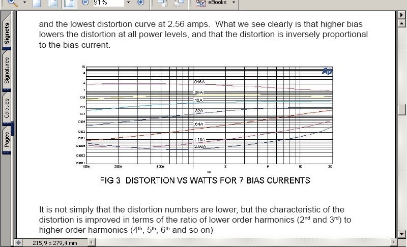

Hello mr Pass
In your PDF document; "leaving_class_a", to do the tests for the fig 3 graphic, which mosfet did you used ?
Btw, have you done an update of this document ?

I don't have that it my notes, but from the curves I can
tell you they were FQA12P20 and FQA19N20C.
And no updates.
