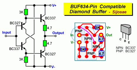

Recently (since this morning actually) I got very interested in diamond buffers and found several schematics. I understand the principle for the Walt Jung version and some derived ones but not this one for which I post the schematic. I may be a dumb question but how is the second stage correctly polarised? To me it looks like a class B or even C stage... Probably I'm missing something in the design...

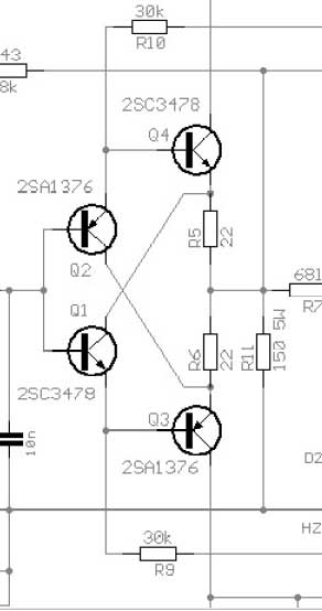

And I wanted to share the Accuphase one which I find very interesting with the autobias acting like a faint NFB too.
Very elegant...

I would be curious of the results obtained with the Accuphase circuit.

I read the circuit (1) like this: -
The circuit is symmetrical and collector voltages in the first stage will be equally offset from the supply rails when the Hfe of the transistors is equal.
Since the bases of the input transistors are at the same voltage (connected), the differential voltage between the collectors is Vbe(337) + Vbe(327). This is insufficient to bias the second stage into conduction, because of the voltage drop across the 2*4R7 emitter resistors and because the transistors used are identical to the ones in the first stage.
So this is a class B push-pull amplifier and will have pronounced crossover distortion.
Sorry
I was about to go to bed when I wrote that. I went to sleep and woke up thinking about it.
In both instances this should read emitter, not collector.
This is 2 cross-coupled emitter followers, so voltage gain < 1. It's purely a current buffer.
Since the Vbe's of the stages are likely to be close, the xover is probably fairly smooth.
If you wanted to run it AB, you could do this:-

The accuphase circuit is interesting indeed, harmon kardom uses it as well. I think this type of circuit is mentioned in hawksford paper | Reduction of transistor slope impedance dependence distortion |, but i cant remember if it was that exact circuit. Maybe someone here has already compared it to the jung circuit in some thread. Ive only seen one diy guy here use it, maybe it has issues like stabilty. Hawksfords circuits perform well but suffer from oscilations.

OK, I had another look at this. I guess in matched transistors at the same temperature the Vbe's in the first stage at about 4.8mA have sufficient drop across them to cause a mirrored current in the output stage of 4.8mA except this is reduced because of the emitter resistors.
Only took about 12 hours for the penny to drop.

Sorry but I don't totally get it even now. As I understand it, the bias is extremely low at the best in the second stage. Even if we consider "the finite transconductance" of the first transistor, we get a collector voltage of 0,6 plus a very small fraction of percent of it right? This very small fraction divided by the value of the emitter resistor of the second transistor will be the idle current at the output, let's say it's very very tiny. And that's if we tightly match the Vbe so the first transistor has one equal or superior to the one of the second transistor or it will end in class C right? So much trouble for that! Better go class A no?
I think almost all Head-Fi:ers use emitter resistors on the input stage in their diamond buffers, inspired by designers like Amb, PPL and Tangent. Even Sijosae used emitter resistors in his first version. There are many versions out there. Maybe the one above was intended for long battery life since it was designed several years ago when rechargeable batteries were expensive and with a lot lower energy storage than the ones we use nowadays.darian said:Thanks for your answer,
