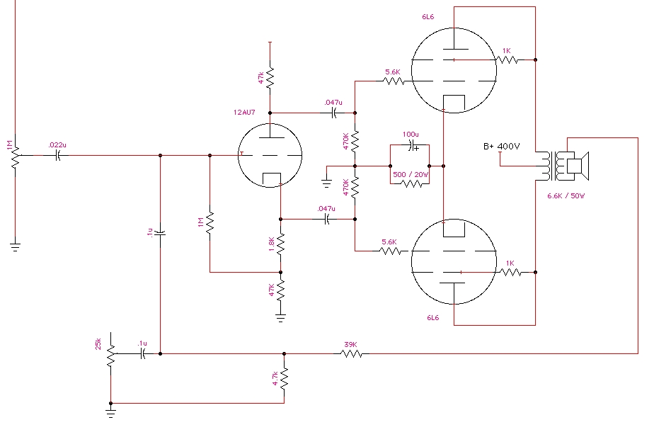

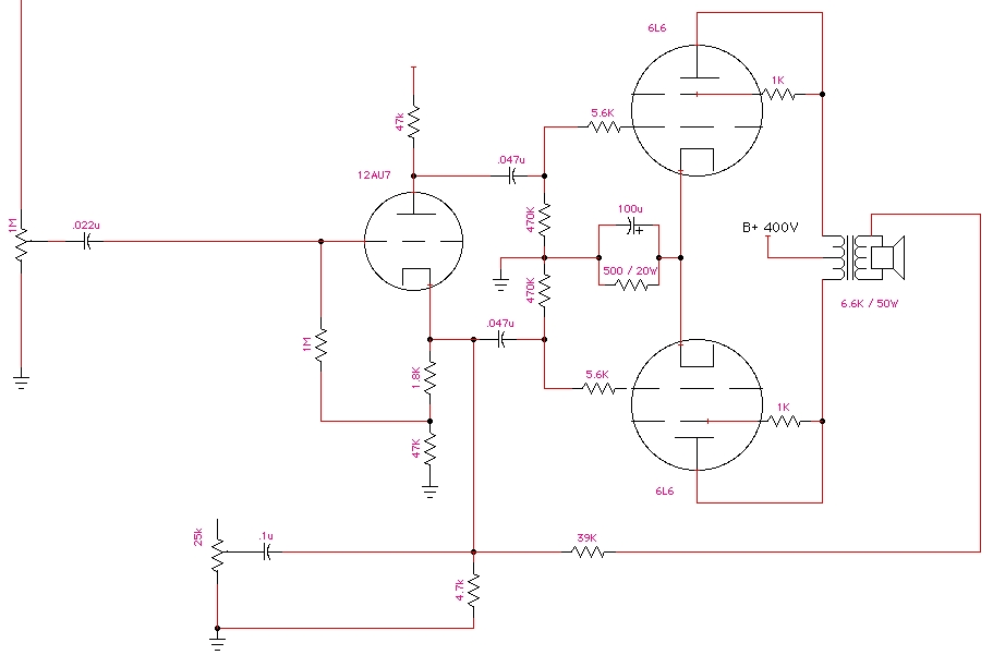

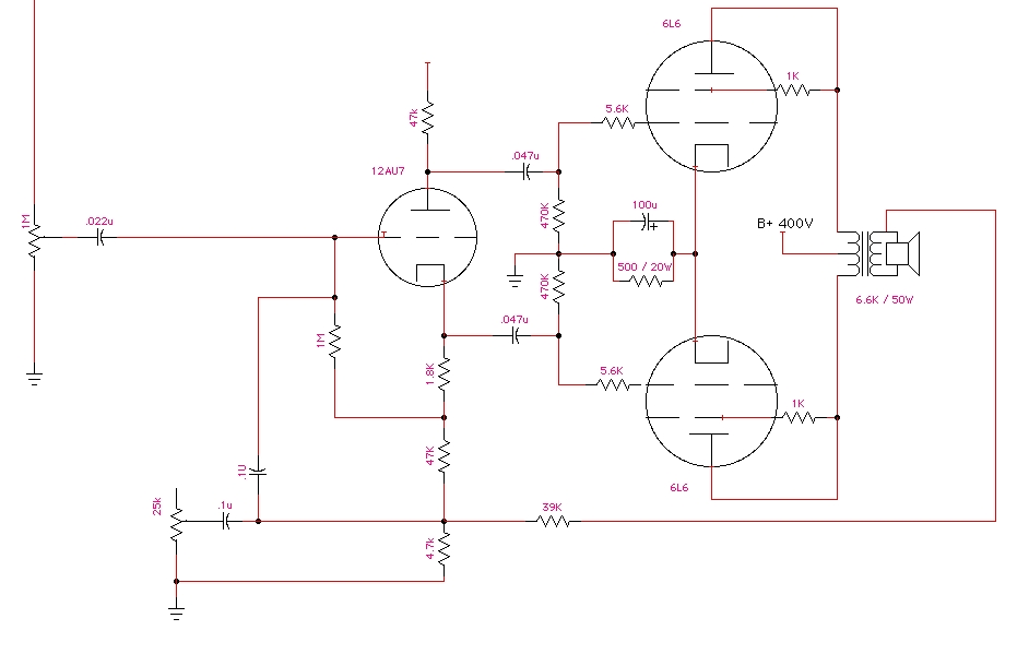

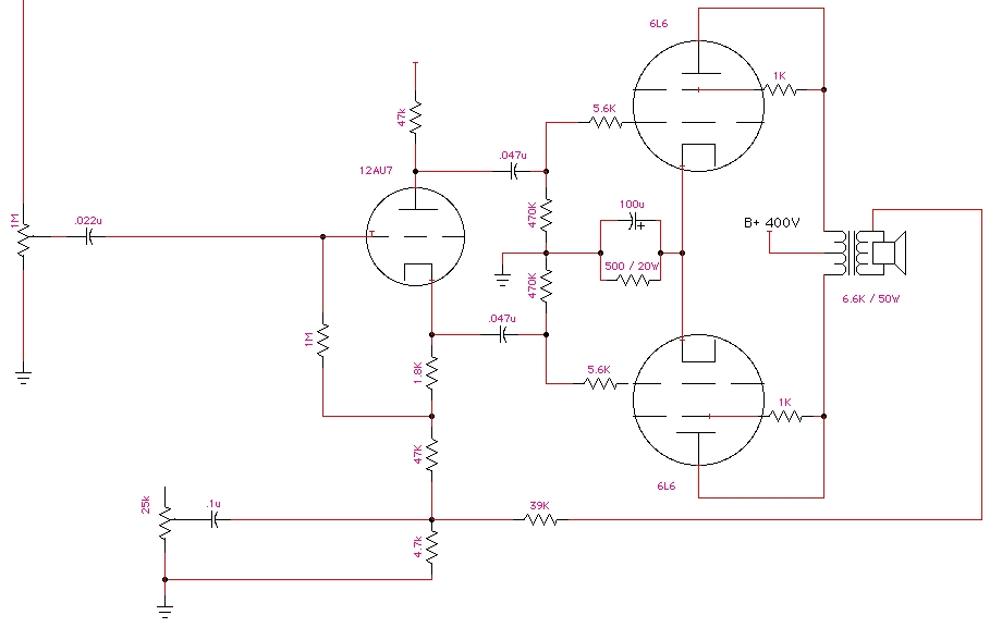

I am trying to design an output stage with a minimal tube count. I have settled on the concertina splitter since it uses only one tube to so it's dirty work.
My problem is: I am having trouble visualizing I can inject NFB? Preceeding the splitter is a tone network that is fed from a cathode follower, and then a volume control, so I don't want to inject it into that stage since it will alter the foreward gain in the loop as the tone and volume controls are altered.
So I assume that I have to inject it into the concertina itself. I have drawn up a few variations. The .1uF capacitor I suppose is the culprirt in question.

Negative feedback works by trading off gain for distortion/bandwidth/impedance. The problem is that your circuit has no gain to start with...
It's difficult-to-impossible to feedback to a split-load; generally, the split-load is driven by a gain stage and the feedback is brought back to that stage.

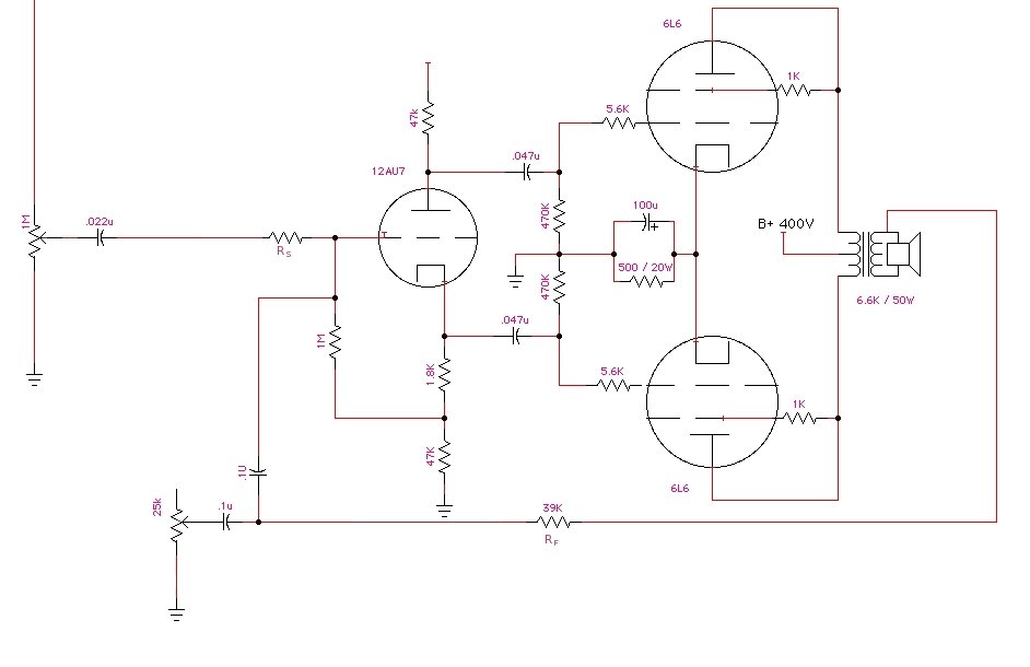

If you have to go with the cathodyne, then your best bet would probably be something like what I attached. With the cathodyne, you really don't have a second input for the NFB summing node. So try something like the inverting connection that you'd use with an op-amp. In this case: Avcl= Rf/Rs (or close to it).
BTW, when you revise the circuit, make sure that the lower output is taken from the top of the load resistor, not from the load plus cathode resistor.

Miles Prower said:If you have to go with the cathodyne, then your best bet would probably be something like what I attached. With the cathodyne, you really don't have a second input for the NFB summing node. So try something like the inverting connection that you'd use with an op-amp. In this case: Avcl= Rf/Rs (or close to it).
Sweet, thanx for that one.
I am seeing the issue now with the lack of gain in the cathodyne. Maybe I'll rethink the output stage... possibly using a self-split conficuration for the output tubes and using that half of a dual triode as a gain stage /driver and return the NFB there.
Balance. Think of the current flow. There's no path other than straight down from the B+ to ground (the grid draws no current). So any ac current is multiplied by the resistance to ac ground (which is the B+ rail and ground). The cathode bias resistor adds an error to the bottom drive voltage.
So since you need symmetry to achieve balance, you can either take the lower signal from the top pf the load resistor or you can take it from the cathode and bypass the bias resistor with a big ol' electrolytic cap.

The concertina has one hi-Z input and two odd-Z outputs. The obvious way to take feedback, as Miles says, is like you wire an op-amp as an inverting amp.

BTW: what is this pot-cap hanging on your feedback loops? Is this a gitar amp? It may help to know what the amp is supposed to be: a hi-fi amp and a gitar amp suggest very different choices.
Oh: in Mile's suggested plan, the "obvious" place for the pot-cap stuff is across Rs, not grid to ground. But coming off a pot wiper, it may not have much effect. Taken to ground, it won't affect gain much, it will reduce NFB at high frequencies (which may have use in screamin-gitar work).
