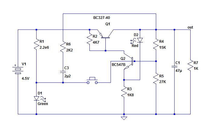

This PSU handles a number of functions for battery-operated devices:
It is basically a LDO regulator, but it also performs the ON/OFF function with a single push-button, the power indication, lo-bat indication and short-circuit protection.
It is absolutely minimalistic, comprising only 2 discrete transistors.

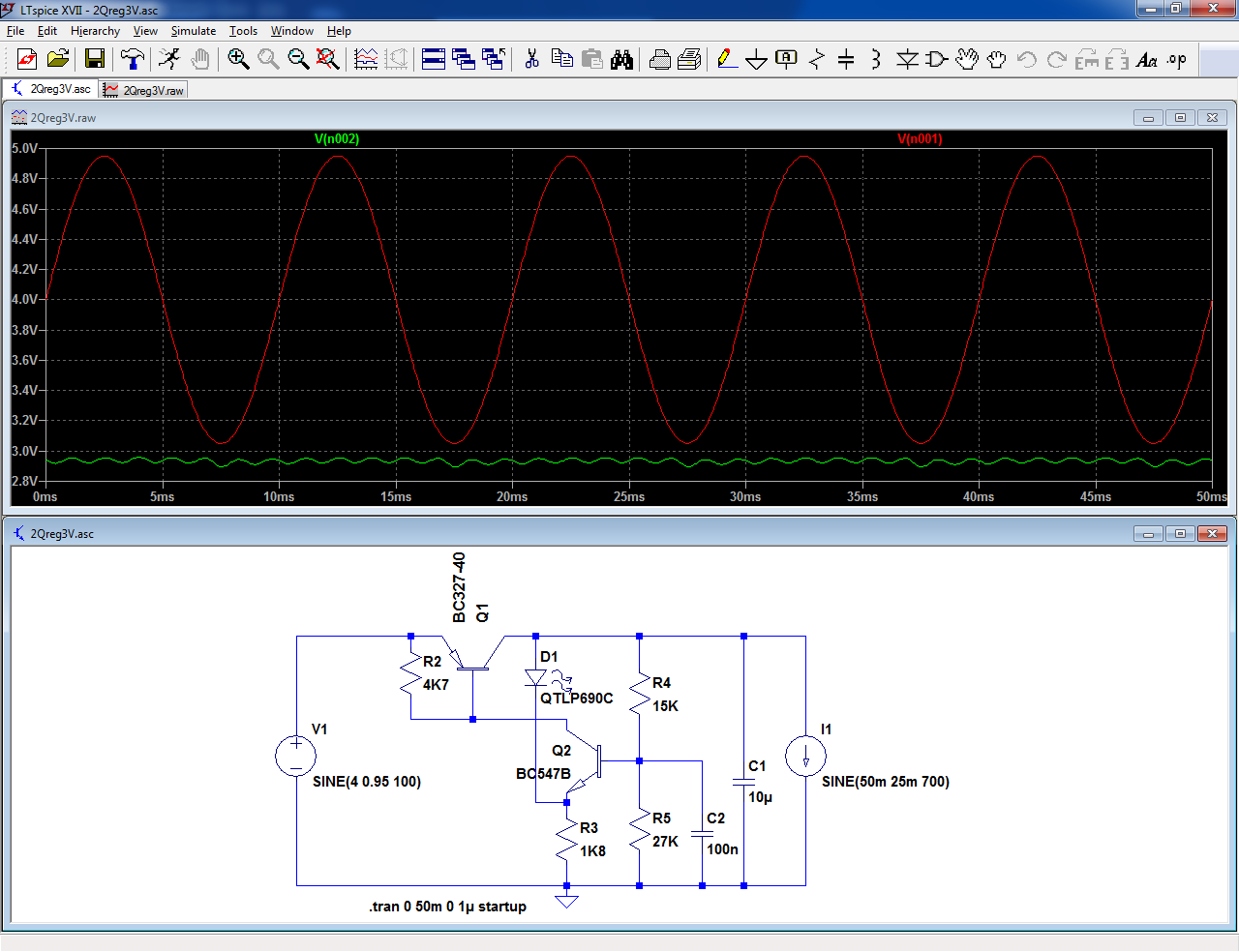

This pic shows the core of the circuit subjected to simultaneous input and load ripple:
attachment.php

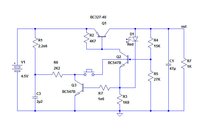

To create the toggle function, a few components are added:
attachment.php
When the circuit is off, the current consumption is ~1µA.
The component values are suited for an output current of 50~100mA, but by scaling the resistors values, any value can be obtained: multiply them 100 times, and you have a micropower regulator.
The reference voltage is generated by the red LED: its tempco compensates the Vbe of the transistor.
This LED also serves as a power indicator (use a low-current type), and as a lo-bat indicator: when the battery voltage is too low, Q2 steals all the available current for Q1's base.
The circuit is short-circuit protected because it is based on regenerative action: if the output current exceeds Q1's capability, the circuit trips and turns off, and cannot be turned on again until the short has been removed.

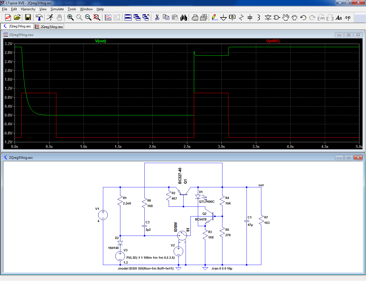

The following pic illustrates the toggle operation:
attachment.php

Nice and simple. Only for turn-off you have to push long enough specialy with low or no load.
How about like this ? No current ( exept transistor leak ) after turnoff.

You are right, of course:
a)The time constant of the <output load> times the <output cap> cannot exceed ~60ms without an adaptation of the pushbutton RC network.
I opted for 2.2µF because it is easily available as a MLCC format, but higher values should be possible (with the caveat that ON/OFF actions will have to be separated by at least a few seconds).
This regulator was designed for a small portable GM-counter, consuming a few milliamps in the idle state, thus the RC time constraint was easily met, even with larger values of the output cap and smaller values of the pushbutton cap, but I published a more general version, however you are right to point out the fact that it won't turn off for light- or no-load conditions.
b)Yes, I am perfectly aware that an additional active element would considerably ease matters, but I opted for the bare two-transistor version simply because of my silly manly pride: real men can do it with just two transistors....
Obviously, this is for leisure only: when I did that kind of design as a paid work, I prudently left my pride aside.... I can imagine you are more or less in the same situation.

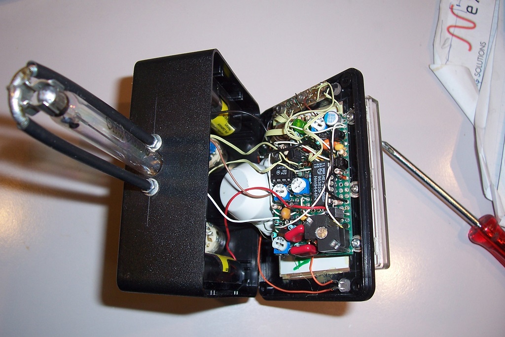

Here the PSU in its environment:
attachment.php
(just 1 or 2 square centimeters on the top right; the rest is the HV converter, pulse amplifier & processor, integrator, etc)

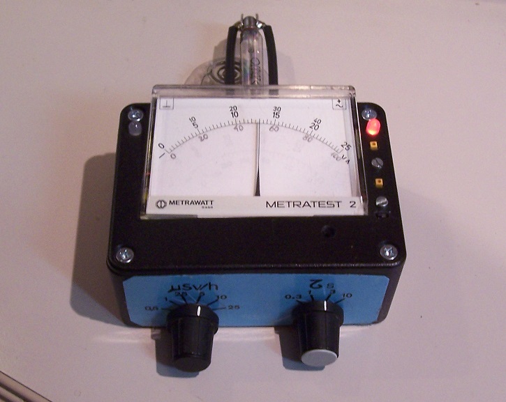

This is the finished GM detector: the current drain is ~5mA from 3 AA batteries:
attachment.php

Impressively simple. C2 (100nF), first schematic, is that added to slow down the loop?
No, to speed up.The emitter is connected to the +rail via D1=reference voltage and the base with C2 to the minus rail.
As Mona hinted, it does rather the opposite: it increases the loop gain of the regulator in AC.
I had to drop it in the final version: it interfered with the ON/OFF circuit
A "Geiger Counter"?
Here's a clever (no range switch) compact job from long ago.
A neat shortcut indeed, but I wanted to reuse as much as possible the (linear) scales of the salvaged galvanometer, and anyway I preferred explicit controls of the sensitivity and integration time for this one
