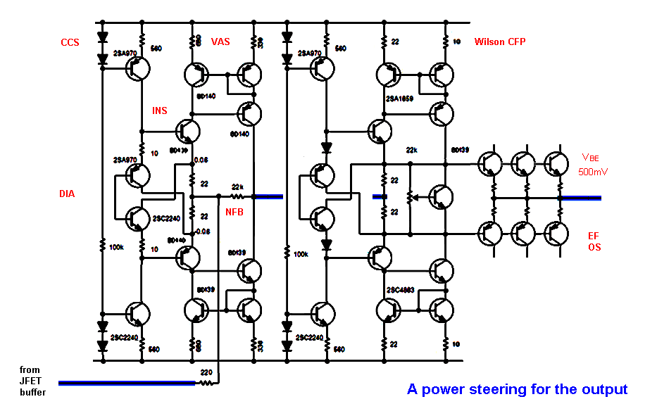

A power steering for the output
I chose the guide with common base to achieve greater symmetry between the two half-waves
In fact, the current that stimulates the signal through the two complementary bipolar is the same
thus was born a particular configuration in the output stage
it is a CFP as a stage driving multiple EF
