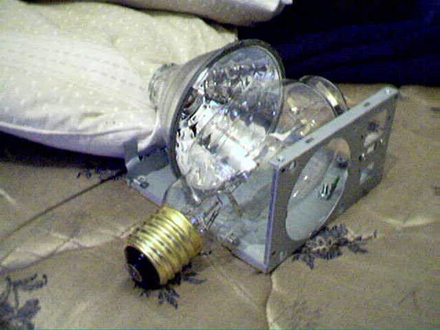

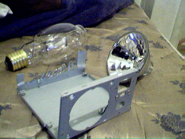

your bulb's burning point is too far away from the focal point of the reflector. your would be better off with a tubular lamp and stick it through like I_eat_flower and Ace did.
If you are going to stick with the bulb you have, you should try a much larger reflector. they are probably used in green house or that sort of places. I remember some people using those to grow weeds...
