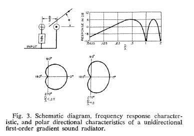

Bob is right that time-alignment by delaying signal to one of the sources will not make them work together as one the way physical alignment will. It can provided identical results for one point in space (like the listening position) which can improve things, but not all points in space. Taking your thought experiment in post#3 a bit further...think about what the signal phases would be like in the reward direction once you had them delayed for in-phase arrival in front of the speakers. Adding delay to correct things in the front will actually make things worse toward the rear! Fortunately, as has already mentioned, the physical misalignment is a small fraction of the wavelength at your low crossover frequency so not a practical concern.
BTW using electrical delay to compensate for physical separation may not be ideal for your situation, but it can be useful for creating directional speakers…in particular subwoofers. Basically, you separate two monopole woofers by a distance and then invert signal to the rear woofer and delay it by the separation distance. The result is a cardioid radiation pattern with a null toward the rear. See attached excerpt from 1972 Olson AES paper. Internet searches for “cardioid bass array” will uncover more details if interested. This is becoming a popular pro-audio solution for steering bass.

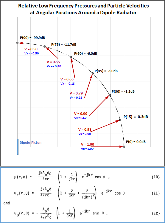

Bob is not correct about the null.
See attached plot of pressure and particle velocity trends around a dipole speaker. It is interesting to see the direction of the particle velocity flip around as you move from in front to along side the woofer. If you happen to have a ribbon microphone, you can actually measure its magnitude and direction.
Notice that although there is a very clear pressure null to the side of the dipole piston, the particle velocity(what is exciting your ESL diaphragm) does not. In fact, if you look just at Vx, the X-axis component of velocity (ie the velocity normal to the plane of the ESL diaphragm) you can see that it would actually be slight larger when your ESL is in perfect physical alignment with the dipole woofer pressure null than if it was a bit forward or aft. It’s a really shallow trend though, not at all like the distinct pressure null. One big thing to note from the equations is that at low frequencies the particle velocity will fall as the cube of the distance from the dipole source. So small additions of separation distance can make a big difference in how much the woofer is exciting the diaphragm.
One further thing that interested me, was that at a 54.7 degree off-axis angle from the source Vx = 0, so that is where you would need to place the ESL to find a null, or minimum in excitation. The reason this interested me actually has nothing to do with ESLs or Acoustics, but antique radios! Back in the 1920s the “magic” 54.7 degree angle was patented by Hazeltine (US 1577421) for use in cascaded RF amplifiers in early unshielded radios.

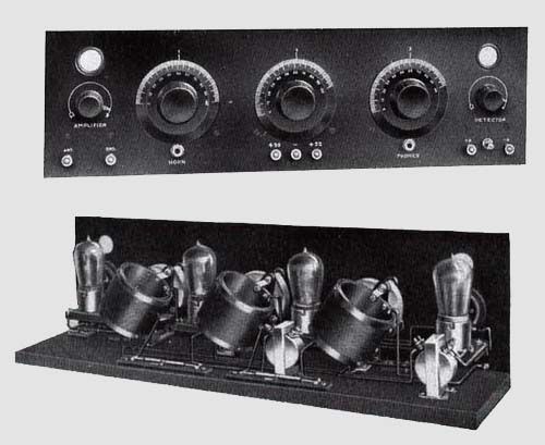

Bob is not correct about the null.......
Thanks for the excellent info. I'm not sure I entirely follow your extrapolations from the theory?
It seems to me that for an ESL membrane to be excited by air there needs to be a pressure differential. A pressure differential can obviously created by air movement creating a negative pressure via a differential laminar flow, or positive pressure with eddies. However the membrane movement force created by velocity of air flow across a panel is surely directly related to pressure effects. It seems to me your positing that air flow can move or excite the diaphragm in a pressure null. That appears to be logically inconsistent over a diaphragm? It seems the theoretical basis is modelling free air effects rather then what will occur over a diaphragm?
Practically the design issue with the OB driver adjacent to the ESL membrane seems to be that the membrane becomes part of the dipole baffle with clear pressure and velocity effects impinged on the mylar. However most of the pressure and velocity effects can intuitively be expected to occur close to the driver down low and rapidly dissipate with distance leaving most of the ESL membrane relatively unaffected. This would explain the sound quality.
Still it appears to me the ideal design would have a slot between the OB bass driver and the ESL to allow for unimpeded air flow under the ESL, allowing the dipole pressure null to fully envelope the ESL panel?
Being excited by or sensitive to pressure differential, pressure gradient, or velocity are all ways of saying the same thing. Like ribbon microphones, ESL membranes are velocity sensitive. The velocity field and pressure field are related to each other. If you are mathematically inclined, most acoustic texts(ie Beranek, Olson, etc) provide examples of how to calculate one from the other for a variety of source types. Keep in mind that the pressure at a location in space is a scalar quantity whereas the particle velocity has both magnitude and direction.
That is exactly it, but think air particle vibration rather than flow. Take a pressure sensitive microphone and move it forward and backward past a dipole woofer and you will easily find a null or minimum pressure point(your ear is pressure sensitive). Do the same thing with a velocity sensitive microphone (oriented parallel to woofer piston) and you will find that there is no null as you sweep past the woofer. In fact the velocity is slightly higher at the point of the pressure null than at positions just in front or behind it. Since ESL membranes are velocity sensitive, as odd as it may sound there will NOT be a null in the excitation by the dipole woofer even with the ESL positioned at the location of the pressure null. Since the velocity vector is parallel to the woofer motion, rotating the microphone(or ESL) 90 degrees with respect to the woofer while at the null location will effectively remove the acoustic excitation from a velocity sensitive device.
If you are interested in measuring the velocity field but don’t have a ribbon microphone, a small magnetic planar like the BG Neo3 or Neo8 can be used as a microphone in a pinch. You can also use the ESL itself as a microphone to measure exactly what is happening. Peter Walker first suggested this in his AES paper and after a little prodding from golfnut I can say it works rather well for quantifying what is going on at low frequencies. On a related note, standing waves in pipes produce maximum particle velocity at pressure nulls/nodes.
It seems the theoretical basis is modelling free air effects rather then what will occur over a diaphragm? Practically the design issue with the OB driver adjacent to the ESL membrane seems to be that the membrane becomes part of the dipole baffle with clear pressure and velocity effects impinged on the mylar.
If you can model a woofer’s velocity field covering the location of the ESL diaphragm without the ESL in place, you will find the velocity imparted to the ESL diaphragm is nearly identical to what was calculated. Borrowing words from Peter Walker, the ESL diaphragm is for all practical purpose acoustically transparent. Peter Walker demonstrated this during AES talk by holding up a stretched diaphragm in front of his face while continuing to talk. For low frequencies, you can demonstrate it to yourself by testing a small dipole woofer in 3 ways:
