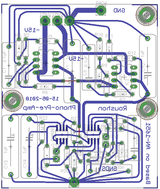

Here is a single-sided pcb-design (with two jumpers) for a phono pre-amp circuit based on the National Application Note AN-1651.
I request for suggestions and corrections in the design.

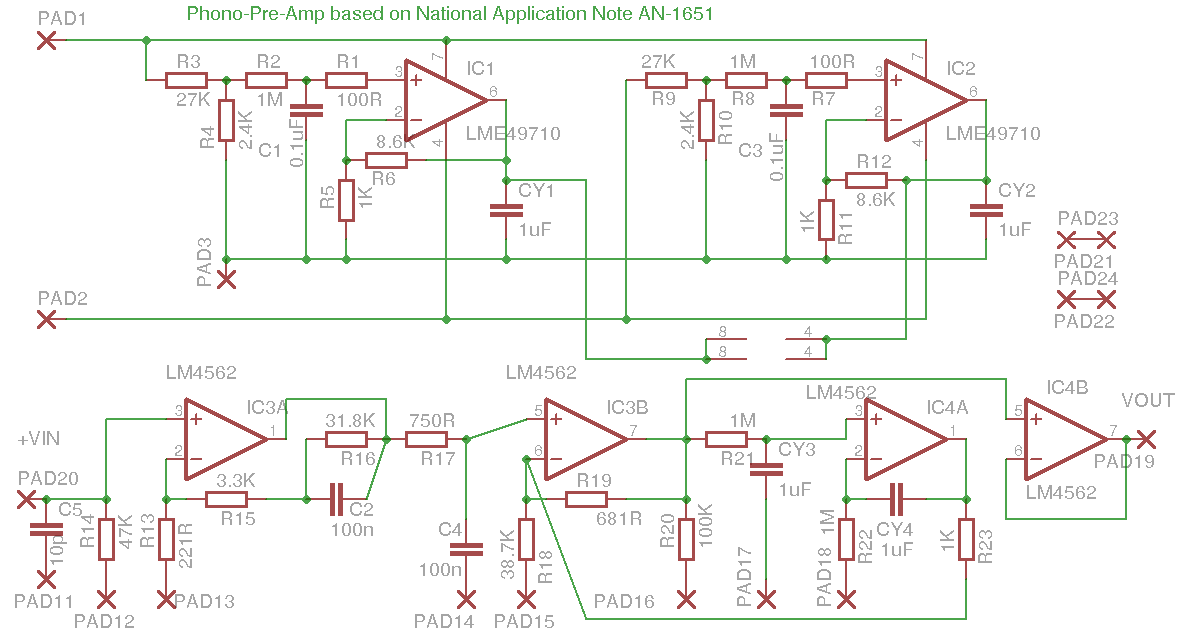

Thanks Joachim. R18 is 38.7R. I corrected it now. I am following the Topology 2 (Active/Passive) in the application note. Half of IC4 is not used, so
I made a unity gain buffer out of it. I know it is not required, but it is not of any harm if added I hope.

Putting a buffer in my sound better when you drive long and demanding cables, so yes, it does not hurt. You could also build a switchable subsonic filter.
That is a very good idea. Thank you very much. I will work on to convert the
unused opamp into a subsonic filter.
Best regards
Roushon.
On the pcb: do not use 90 deg. anles on traces. In the etching process (especially home-made boards) undercutting at the anle could happen). Use only obtuse angles (135 deg. or greater). The star grounding you are employing is not required here. It is used in high power systems where a ground lead could be modulated causing hum and feedback. Not using star grounding can reduce the pcb size. E

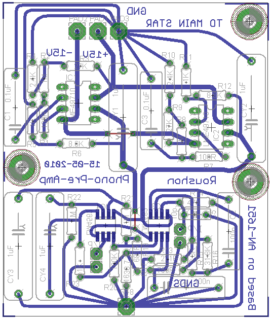

Thanks a lot for your suggestions. I will make the angles smooth. About the
ground connection can I make only one ground connection from the board, meaning, is fusing all the ground end from both upper and lower parts of the
pcb to a single point OK?
Regards
Roushon
Regards
Roushon

Re: Grounding
You can safely connect your PAD11-18 to your main ground or common through a single point to point trace. The traces are to short and the currents to small (and balanced out) to matter. As a personal rule I make the supply traces wider (as you did) and double them for the common.
E
E
Our posts overlapped! I would add a second pad to PAD3(?) GND to take a wire from your new star ground to there and than to the raw DC supply. As you did star grounds all around there is no need for increasing the common trace sizes. Good luck!
E
Thank you again. I will do that.
