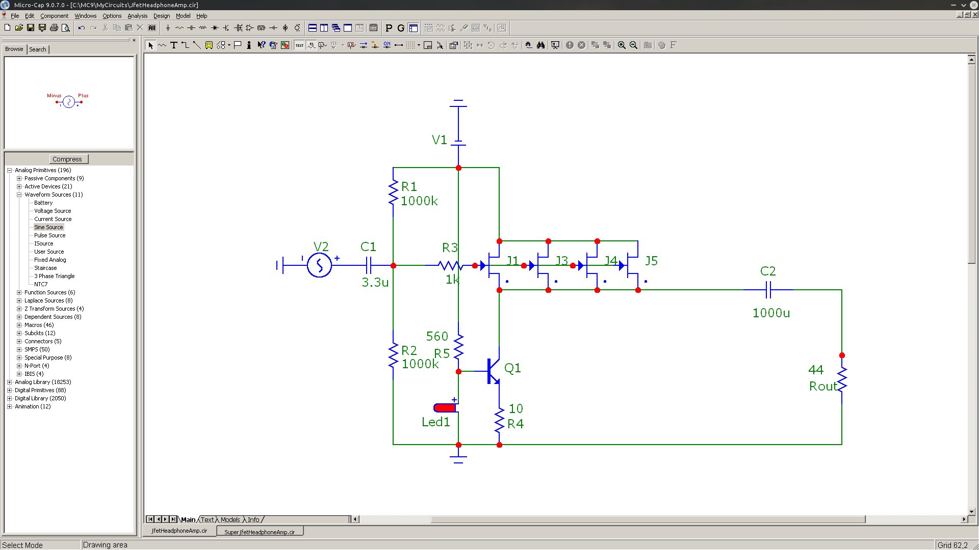

So here is the first prototype i came up with in simulation. A Jfet common drain current buffer. Distorsion seems ok in simulation, but testing a prototype channel with some cheapo earphones distorsion seemd a little highher. But in general, great sound even with the elko.
So where to go from here? I could bias the Jfets even higher als long as i stay probably up to 3000mw dissapation per jefet, add more jfets maybe up to ten, but i will need more bc550 in the current sink because the single one is already at its limits.
And there is one problem i have. When powering the unit or connecting the headphones i get a quite loud pop in the headphones, i guess the elko cap is discharging through the headphones, what can i do about this?

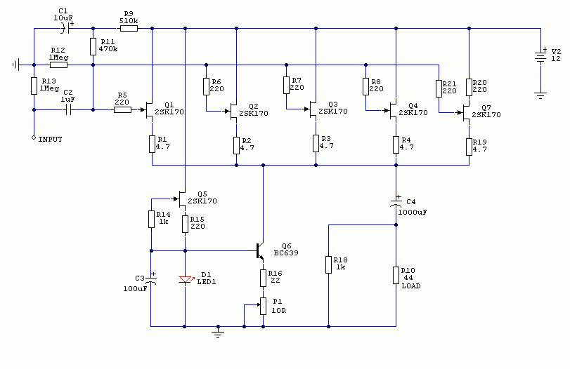

A few Pass designs over here as B1 and few others are a text book example circuits, so you have nothing to be ashamed for. My advice is to insert say about 4.7 Ohm source resistors at each of the jfet sources so you could measure how`s the current sharing between jfets It could be important if they`re not matched. Also you could try lower value R3, let`s say 100-220 ohms because of paralleling jfet`s Cgd-s and you could also lower input coupling cap, for a 500K input impedance (run the AC analysis in MCAP, All that things you could check in simulator with the good accuracy.) but It` won`t change the sound if the capacitor type is the same.
I guess you ment 300mW per jfet, that`s ok but don`t go over that, 200 - 250mW is a better choice. BC550 should be thermaly coupled to LED etc and you could change it to BD139 to be on the safe side. . Everything will work even the wat you draw but better to do it right and it`s not so complicated.. Cheers! 😉 Try bypassing output elco with film cap for sound tuning etc...
Razor,
That won't work very well. To prevent oscillations you need a gate stopper on every JFET's gate, and to prevent current hogging you need a resistor in every JFET's Source. You need a resistor to discharge the output and input cap. Also, you need a fillter on voltage divider at JFET's gates - battery is not so clean as one might think. Also, the CCS (Q5) to supply the LED Vref should be used. Five instead of four Source Followers JFETs is better (10 is even better).
You don't write what is the grade of your JFETs (GR, BL or V) but use the highest Idss parts you got and set the P1 so that you get about 80-90% of Idss through every Source Follower JFET (measure the voltage drop on 4R7 Source resistors).
If you got, for example, JFETs with Idss=10mA you'll wan't to run about 9mA through each of them, so the Q6 CCS should supply about 40-45mA (if you use 5 JFETs as in my sch.). The LED used should be nothing fancy, ultra bright etc., just plain old, 3mm red one. If Q6 gets hot, use the bigger one - BD139 or similar.
Viel Spass !
Edit: there's an error - the resistor in Q7's Drain shouldn't be there, that Drain should connect straight to +12V

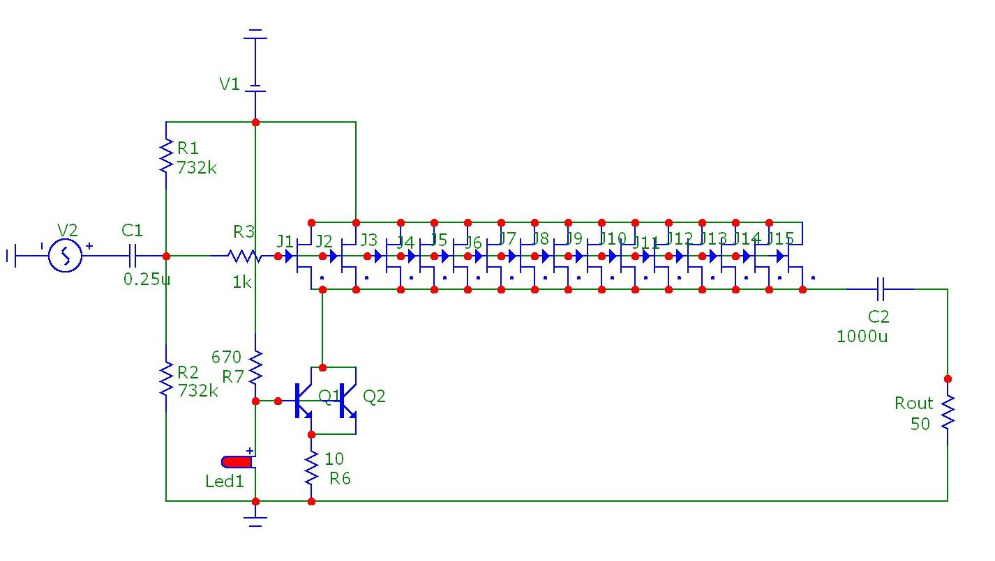

So,
after one night of Jfet matching I found 30 Jfets wirh an Idss from 7.0 to 8.0 ma, so here is the new Schematic:
15x 2SK170 per channel
2x BC550 and one red Led as current source
THD should be in the 0.1X percent range for 1Vrms out
Bias is at ID 5.6ma and Vgs: -75mv.
A fresh piece of Sripboard is ready, have to do some university stuff and will start building the Prototype this night. I dont think a PCB is needed for this project ... but what could we do with 20 BF862 in each channel .... first things first, smd monsters later.

add source resistor for each Jfet
keep dissipation for bjts in sane level
put bleeder on output
bootstrap R1 (divide in two , put cap to gnd)
etc.
PD is 250mw for BC550 they can handle up to 500mw that should be safe
Bleeder was reconmendet earlier just forgot to put in in the schematics
Biggest question: why the source resistors, just gimme a hint or a value so i can start figuring it out myself.
Bootstrapping is a good idea, i will add that.
Thx for the input.
