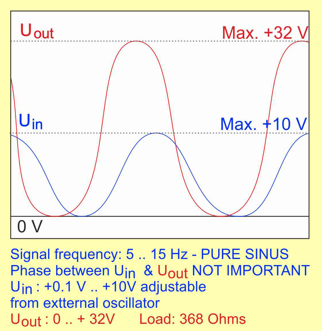

Dear Members,
I need to amplify a very low frequency pure sinus signal 5 - 15 Hz sinusoidal
Signal is comming from a signal generator as in attached picture: 1mVpp - 10Vpp, adjustable, ALL POSITIVEI need an output of the signal POSITIVE only,
phase related to input not important.
Load resistance 368 Ohms,
Power Max.: 10W
Power Max.: 10W

Yes the requirements doesn’t make sense. Please correct it. If voltages should be 32v at peak the power would be 2.78w peak. If that is the case the DC coupled amplifier will do this. Nothing special.
While it is easy to get the output to be always positive that might not be the full story.
Does the lower part of the output sine always have to reach to zero volts no matter what the overall amplitude may be? In other words the DC shift is not a constant but has to change automatically with amplitude.
If so then I can't just see an easy way to do that.
There´s a few problems and contradictions in your request:
1) A direct coupled single supply amp will always have 1/2 Vsupply present at the output, even without signal, over which the sinewave will ride.
So, no datasheet suggestions apply, some have single rail amps but capacitor out.
2) the bottom peak will just meet Ground (what you show in graph) ONLY at full power
3) generator/signal source can easily do that because its level is fixed, but amplifying that to various levels means DC idle voltage must ALSO vary with signal ... is that what you are asking?
4) as a side note, 32Vpp means 11.3V RMS which into 368 ohm mean 0.35W RMS.
Not sure where "10 W" came from.
Clear these important doubts and we´ll be glad to help.
OkI need to amplify a very low frequency pure sinus signal 5 - 15 Hz sinusoidal
IF signal is what you show, single supply amplifier suggestions above do NOT apply.Signal is coming from a signal generator as in attached picture: 1mVpp - 10Vpp, adjustable, ALL POSITIVE I need an output of the signal POSITIVE only

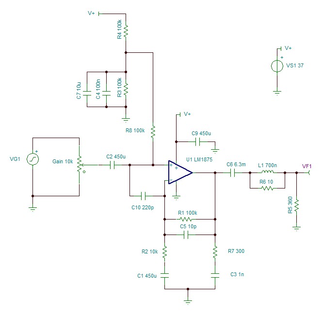

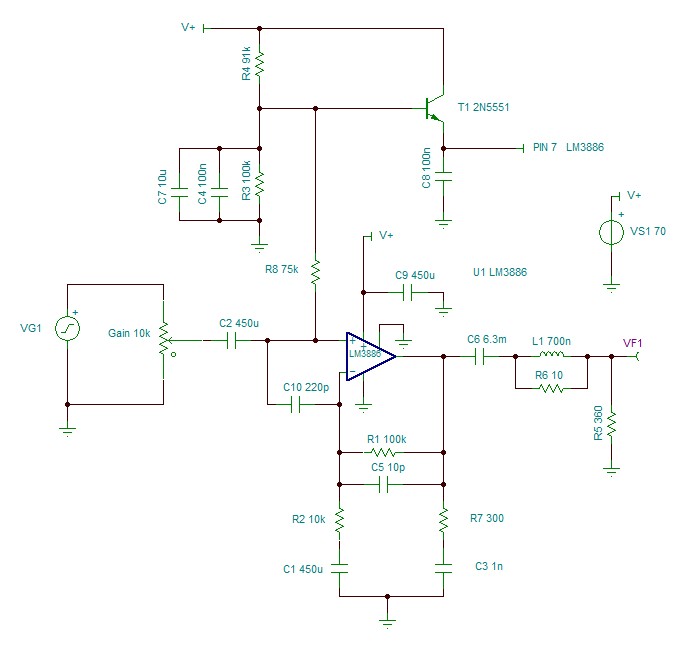

Dont care to over think it.
Just use a single supply LM3886.
input/ output Coupling caps just need to be large to go down to 4 Hz
If the load is only 680 ohms
then the output cap needs to be around 4700u to 6300u
to have decent THD down to 4 Hz
you can figure out how you wanna do pin 7
and the pin 8 mute function
LM3886 needs min gain of 10 to be stable
so your 10 volt input signal would drive it into distortion
Just use a 10K pot at the input to set the needed output voltage.
Amplifier has to be a gain of 10
just use simple transistor like the data sheet for pin 7
I show a 70 volt rail...technically it only needs to be 35 to 37 volts.
probably could just use a LM1875.
wont have pin 7 or pin 8 mute function like the 3886

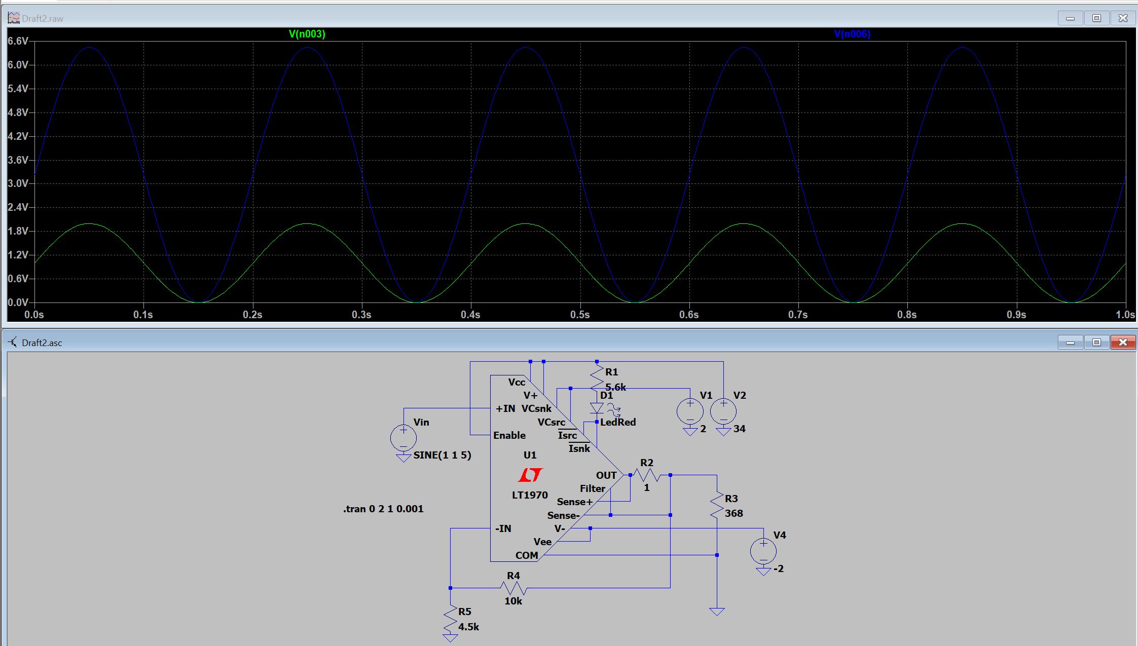

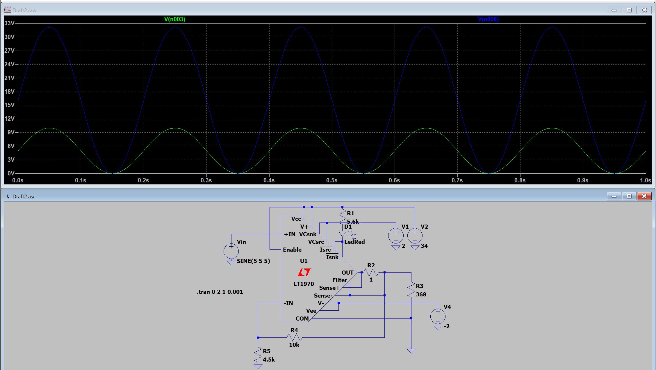

If the input signal is as shown (varying from 0V bottom to 10V top), then wouldn't a DC coupled opamp with a gain of 3.2 automatically give the required offset above ground (output of 0V bottom to 32V top)? Example attached using random high current opamp. Used a V- supply of -2V to allow 0 volts output (won't do rail to rail)
How would that work with varying input voltages as shown in post # 1 (1mV to 10V)? Can you show this sim with different input signal levels and no other changes?

Yes, and you changed the input DC to track the input AC.
That's not what the OP showed I believe; he mentioned the output of a function generator. But maybe he can set the function generator to track the offset, in that case it becomes a no brainer.
