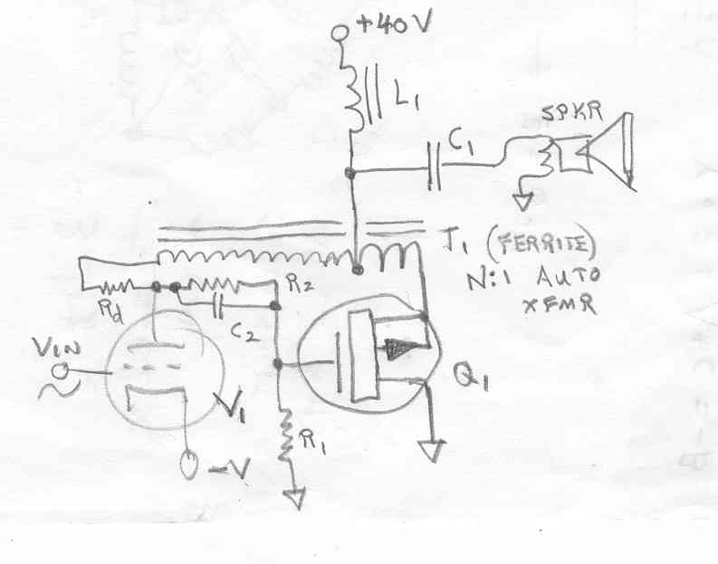

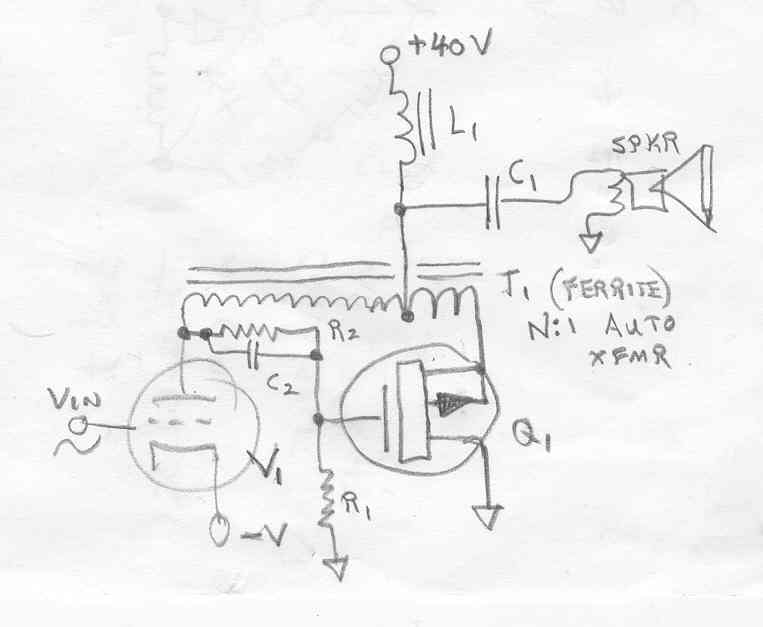

A possible simplification below using a Ferrite auto-xfmr (low turns, only Mosfet gate drive V signal handled within xfmr, teeter totter operation):
The current ratio should be close to the (inverse) turns ratio on the auto-former. Xfmr should be reasonably DC balanced, just AC gate drive voltage on it. (assuming the winding resistances are in similar proportion to the turns ratio.) (Option: could put a token resistance between the tube plate and its xfmr end, so the 1st order gate drive signal is automatically generated in the resistor without any teeter totter "V motion" required in the auto-xfmr. Auto-Xfmr only has to handle the "distortion" in the gate drive signal then, for really low turns )

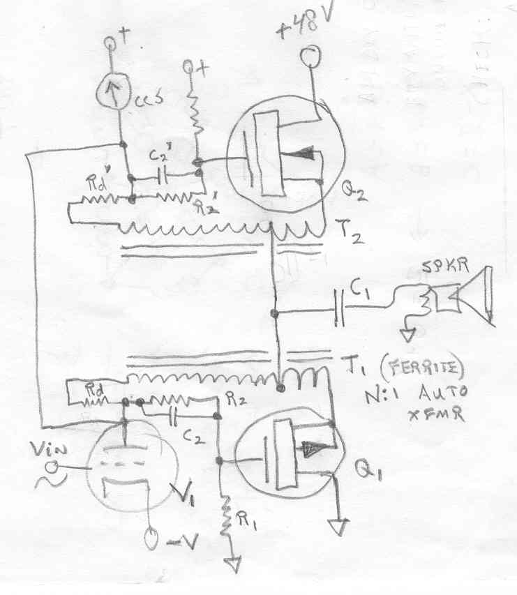

Now to come up with a totem-pole P-P version...

Fixed the simple version for ultra reduced xfmr turns:
N is turns ratio.
Rd provides 1st order linear gate drive signal for Q1, from V1 current across it.
Rd = N / gm_Q1
And a P-P version. Woops, a coupling cap or Zener needed between V1 plate and the top CCS to allow for the steady state gate drive DC offsets.
Some more work yet to eliminate C1

Michael, I prefer simpler power gyrator topology like below. Loading of tube can be tailored by varying R2. A buffer with low 4H and above distortion to avoid buffer stage dominant spectra. I have not yet found any solution other than class A bias. Comments?

Yes, there is definitely a huge circuit optimization to be had by modulating the gyrator element to produce the current feedback.
I like the ratiometric current mirror approach where a modulated current source drives a small current feedback signal to the gyrator, maybe around 1mA, which scales it up to the tube load current (10-20mA or more).
The big advantage using a modulated gyrator vs. the separate parallel anti-load is saving about 1/2 idle current in the output stage for the same tube operating conditions.

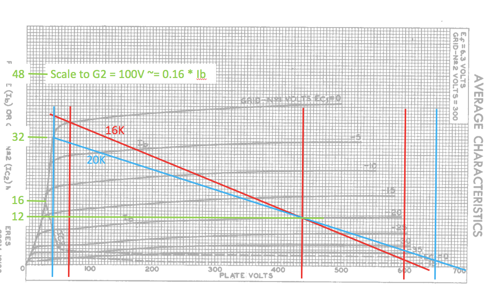

For push-pull topology and low quiescent current I am thinking class Ab (Big A, little b) with pentodes where each tube doesn't cut off but gets into the way low gm operating region. I also have a circuit design for a "Differential Gyrator" which works like the (idealized) coupled inductance of a tapped primary.
I will look into a modulated differential gyrator which may be able to present the scaled current feedback correctly to a push-pull pentode pair operating in asymmetric class A.
Note that the design using a parallel load can substitute an actual (iron and copper) choke for the gyrator.
PS since I am building mostly guitar amps now, and I have an immediate personal use for this, and discussion of instrument amps is not allowed on this list, I will probably take up this discussion over on the instruments and amps board.
Scaled bigA, little b, asymmetric pentode load line
Here is a 6L6GC scaled down to 100V G2 to illustrate the idea of a push-pull output stage operating point, using this basic idea. We don't need to be a aggressive in biasing toward cutoff because we're operating at 12mA due to the scaled down Vg2 and scaled up load impedance.

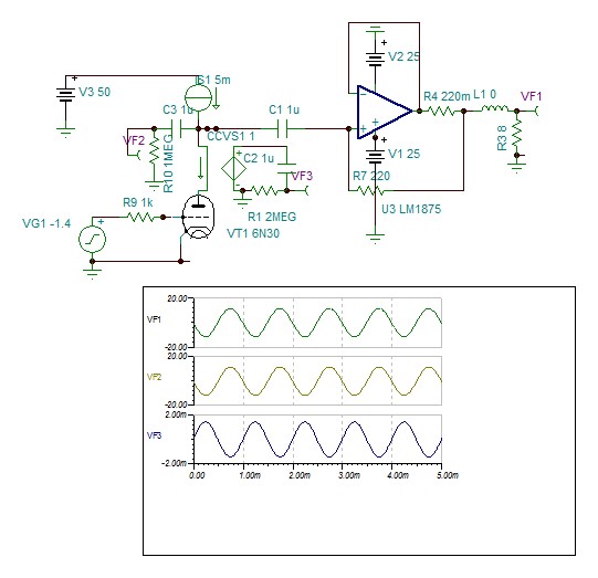

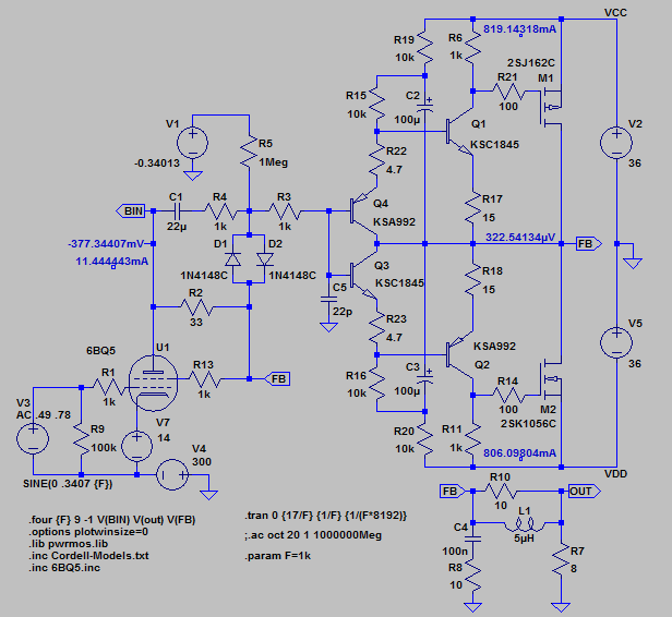

Floating Interactive Current Multiplier
The power opamp multiplies by 1000 the input current, reflecting the tube 8k ohms load. The load sees the impedance of the tube 1000 times lower 2.76 ohms. The multiplying ratio is R7/R4+1.
Hayk
Hayk
The circuit is stable on simulator. The feedback is not only unity voltage also current. If stability is a problem,22k feedback resistor and 2.2k shunt resistor makes the amp stable with unity gain.

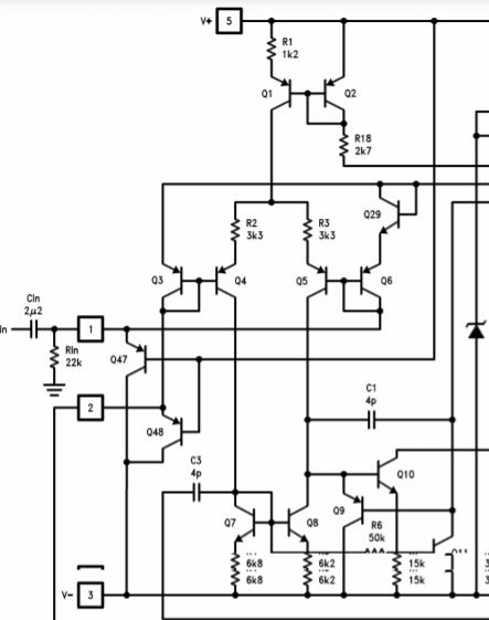

Hi Indra. What makes you think as such. The datasheet doesn't speak anything particular about it. The circuit diagram shows diodes on each input constraining the inputs to the rails as well a limiting diode between the inputs.

Hi, with max supply at +- 30V and stability at gain >10, there was little need for the inputs to handle > 3V swing. Of course the real limit needs to be tested, but no surprise if distortion starts to jump at a relatively low voltage swing at the inputs. Perhaps it is more rewarding to bootstrap an op amp driving a follower, then add the current multiplier and other desired enhancements.

Indeed most opamps distort when reach rail voltages to see if the dropout 4v is sufficient to maintain the input transistors biased . The Michaels purpose is to reflect the output and plate impedances to each other so that the speaker sees the nonlinear character of the plate and the plate sees the reactive and resistive elements of the speaker. By this you can use a small triode and make it resemble to a high power SET, ingenious idea, Thank you Michael.
Lm1875 is not unity gain stable
Av greater then 10 to be stable.
