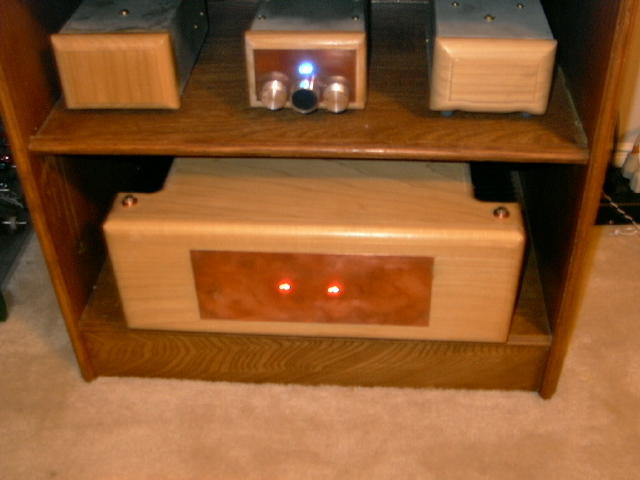

Put together an amp for the summer. It genreates almost no heat. Sounds great, but with 13 volt rails and a bias on each section of 300 ma, it limited to high efficiency speakers.
Here a picture of it in operation. Above is a Tao line stage, thanks to Steve Eddy, a line power supply, and the raw supply for a Passdiy Pearl phono.

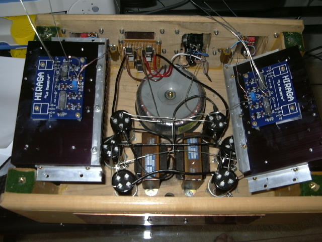

Boards are from PCB-Design, thanks Kristijan!
Stuffed with modern transistors, and for now all values are close to the suggested values from KK. The resistors are mostly hand matched Allen Bradley 1/4 watt carbon comp. The power resistors are Dale LVR-5, special low inductance, non-magnetic current sensing.

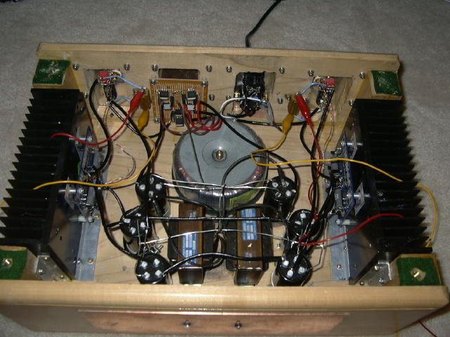

Power Supply
A 250 watt, 10 volt dual from Victoria Magnetics. Two rails recitified with 20 amp, 100 volt Schottkies.
Capacitors are all 25 volt, 47,000 ufd 4 pole Jensen. Gives 288,000 ufd for a 5 watt amp.
The 4 pole caps place a little isolation into the ground plane. The ground plane is split into three sections. The first has the rectifiers and input to first cap. The second has the output of the first caps, the chokes, and input into the second cap. The final ground loop is the output of the second caps and the actual circuitry.
The two boards and the raw suppply all go to ground through a double diode to provide a little more ground isolation.
Details on these four pole caps is listed on the Jensen website, they are very trick.

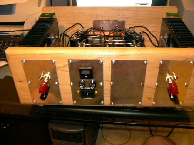

Business end
El Cheapo 5 ways, same for RCA's. 15 amp Schurter input, dual amp amp switch with sides tied together. Extra panel is for fan if needed.
Switches are to select either output or 25 watt 15 ohm power resistors. The power resistors allow hooking up for runnig in playing without disturbing anyone.

The chokes are 2.7 mH, 6 amp. Found surplus at a local parts store. The four pole caps are why there is so much wiring. It is like connecting 12 caps instead of 6.
Got crooked on the LED's. Bin said difused blue, they are red. But looks nice on the copper faceplate.
