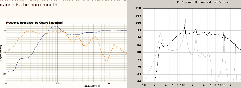

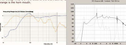

Right. Well, first thing to point out is that the Decware graph is 1/3 octave smoothed (unknown gating), so it looks even flatter than TB's own published plot (which isn't half bad, albeit already somewhat smoothed). More to the point, I can't see a combined response plot on that page. I can see the driver & terminus response plots, but not a combined one. Why not? Well, they might have forgotten. Or, they may be avoiding it because the combined response will inevitably look somewhat rougher than the driver & terminus outputs taken individually. Draw your own conclusions.

2. As others have mentioned, why no combined driver / terminus trace? Many back-loaded designs have a very deep (and sometimes wide) notch somewhere in the neighborhood of ~100Hz (plus or minus) when the terminus and driver are combining out of phase, although room problems can end up being much more significant.
2. He says the FE103EZ (he means FE108E-Sigma) is "frankly horrible... Too peaky and tipped up to be taken seriously... With it's almost 10dB peaks in the treble this driver will sound deceptively loud.".
To me, that sounds like it was written by someone who looked at the graph but didn't hear it in person, because in real life it sounds nothing like that description. To me, it sounds rather smooth, warm and actually a bit rolled off for my taste.
3. He faults drivers for "poor bass roll off" but that's simply a function of motor strength, and one could just as easily argue the reverse, that higher Qts drivers don't have enough BL to sound "fast". It seems unfair to categorize drivers are bad or good based on BL alone.

So okay he could have untapped it and reached a little lower at a loss of some amplitude.
I don't have that driver or any (real) data for one. I just did a quickie ballpark with w5-1611sa data that I do have & it sorta tracks his data at least to the extent it models what he's built (albeit at lower terminus amplitudes per Bob et al).
I guess what I don't see is how you can reach that low with that many watts and not push the little cones right out into the room (underhung or not). Yeah, at couple-four watts maybe it's cool but, w/o a fronthorn or something holding the other side down more, it would seem gutsy to pump 30 cycles through there in two-digits worth of watts.

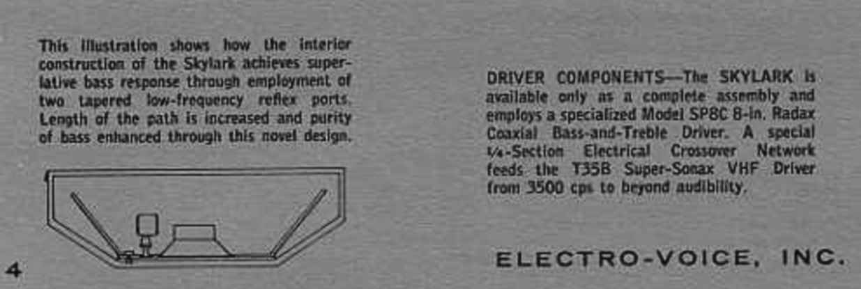

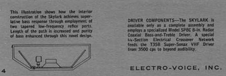

The old guys must have seen all this stuff come around 4 times if not more. I mean, Till and Scott were sorta converging to reinvent the EV Skylark...or Imperial as GM said or...whatever was like that before Imperials 😉 Can anybody imagine looking Harry Olson in the eye and saying much of anything is new?
It's all big-fun and I'm grateful that that there are communities to share the big fun.

Yeah, in reading it I was reminded of the Klipsch, JBL, Frazier, Karlson and especially B0$3, ads. What was old is yet new again. At least PWK invented the 'rubber' throat. As the inventor Tom Danley has quipped, "the ancients keep 'stealing' all my ideas".
