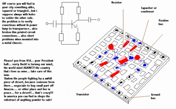

I assemble this one just to show you.
Believe that this is an amplifier.
I know capacitors are in resistor places, also that the transistor is not adequated, also the leads inverted..... this is only a picture, made as flat as possible because have no digital photo machine....not web camera too....this way i use the scanner....transistor is not show vertical because focus deepness of scanner cannot work this way.... surface must be flat.
You can see solder flux that join some copper points.... you will see (bad focus) positive bar upside..... and negative bar downside.
I will put also a scratch of the circuit....notice that is very easy....just to assemble from left to rigth and mark in the schematics the parts already soldered.... also lines of interconection and jumpers must be color marked in schematics... to have sure you do not forget something, but this one do not need that, because is easy to make and check.
Take a look and you will understand..... yes, there are capacitors in resistor place...i know that.... was the small parts i found here at home.... consider the ones as resistors.... capacitors in the assembling is red and green.

Here is the schematic used to make this assembling
This is an amplifier.... diode to not invert..... capacitor to avoid oscilations, to filter and stabilize..... colector resistor, emitter resistor.... an input resistor as a charge in the input.... two base resistors flowing 10 times expected Ib..... but do not have values, just because in the board i put component samples i had in house....only to show the "spatial" way of soldering....the circuit assembled do not works.....it is an image example... only that.
