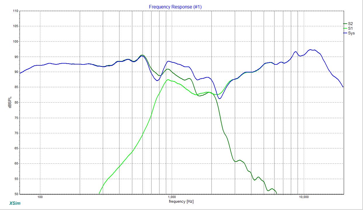

I've been learning to use XSim for the crossover circuit and analyzing the graphs. I'm still very new to this. I at least got to the point where I could input the FRD/ZMA data and at least build a simple circuit to show the simulated results in the graph windows. But when it comes to actually producing a nice crossover, I am not there yet.
I'm mostly having trouble with picking a crossover point and then targeting that and then I'm not sure how to target specific places within the graph (such as targeting treble from 8khz to 12khz and dropping only that range a little, etc). I was thinking I wanted to try to crossover somewhere around 1~2khz since this particular planar tweeter has a lot of range and let the woofer pound out the rest down to 70hz. It looks like from the info that maybe 2khz would be ok. But I can't get it to line up for the of life me yet, knowing I know little at the moment.

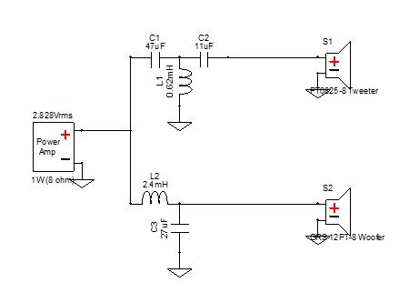

And I'll post my disaster of a design thus far. Again, just trying to understand what I'm doing and what everything does.
I'm trying to just get a fairly flat response from 70hz to 20khz, I'm ok with some things being higher than flat as they can be EQ down with room correction. Any suggestions or help appreciated. I already know that 47uF cap is just pointless, I was just adjusting value to see how the graph would respond. After looking at parts, I realize I do not want to fool with expensive caps.

Ok, re-did some things to try and do better. I kind of like this better, more like a house curve.
Can't seem to get rid of that 800hz dip though.
Edit: Bleh, just realized I didn't slop off the tweeter and it's trying to output down to 300hz. Back to the drawing board.

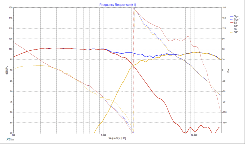

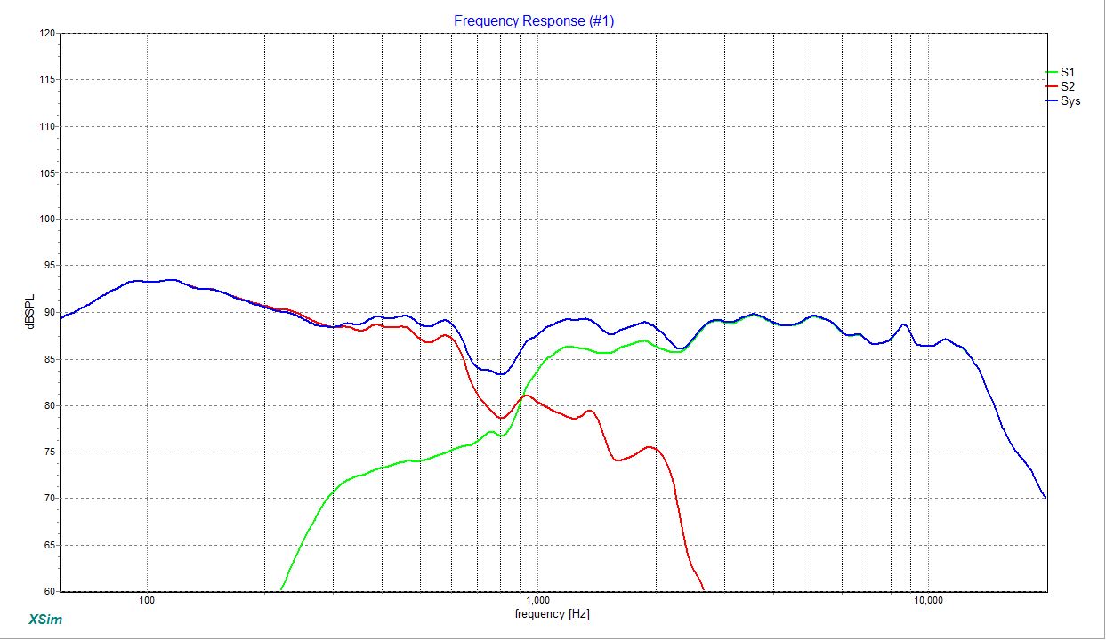

Ok, I re-uploaded with the tweeter highpass in place. I'm happier (meh) with this at the moment other than the dip around the crossover. Any ideas?
XSim project attached.
That's a soft cone resonance, and you can't remove it, and shouldn't worry about it.
I would worry about the stop band of the tweeter though, you need a zobel on it to control the response below crossover. There's also the matter of baffle radiation. If you cannot take measurements, use VituixCAD to simulate the baffle response and use that instead of the factory files, which would typically be IB or IEC baffle.
Since you can cross lower, I would move the crossover to 600 or 650 Hz. That would also fill in a bit of the woofer dip. Presently it looks like you have phase issues everywhere (very poor tracking) as the output keeps moving between the woofer and tweeter around crossover. You want something that looks closer, so always make your phase plots visible:
While there's no rule of thumb, I remember reading that you should target less than 90 degree of phase mismatch at 40dB down, to achieve coherence. While this is a very tough target, you can get close if the drivers work well together. Your situation is complicated by the very large diaphragms, but it might be workable.
I may have a look later - but it is not going to work well because the tweeter has effective output of only 85dB (the 92dB spec is not reached till 3.5kHz and is not valid for lower crossover points), and a different woofer is called for in a passive design. Likely this is meant to be used in active designs with DSP, given the poor sensitivity in the lower half of the passband and the slope of the top end. Not that it can't be done, but some choices need to be made.
