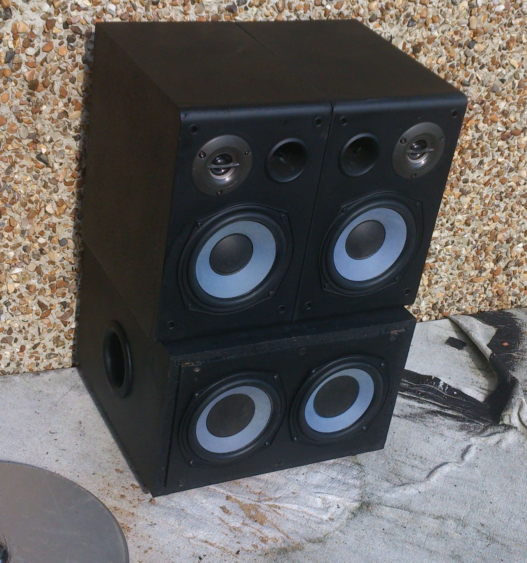

Using dumpster parts I made a remarkably system for our outdoor barbecues. I'm moving but my 2.1 amp is coming with me. Just as an exercise I want to rewire the speakers to be driven from a stereo amp.
If I convert the sub to passive stereo it will be 6 ohms. The satellites are also 6 ohms. This gives me an impedance of 3 ohms per channel. If I use a cap as a high-pass filter to limit the mains to 100hz+ will I get to 4 ohms nominal.
Yes, add a series choke on the woofers as well, keep it at 6 ohms. Is the polarity on the tweeters reversed? What is that XO?
