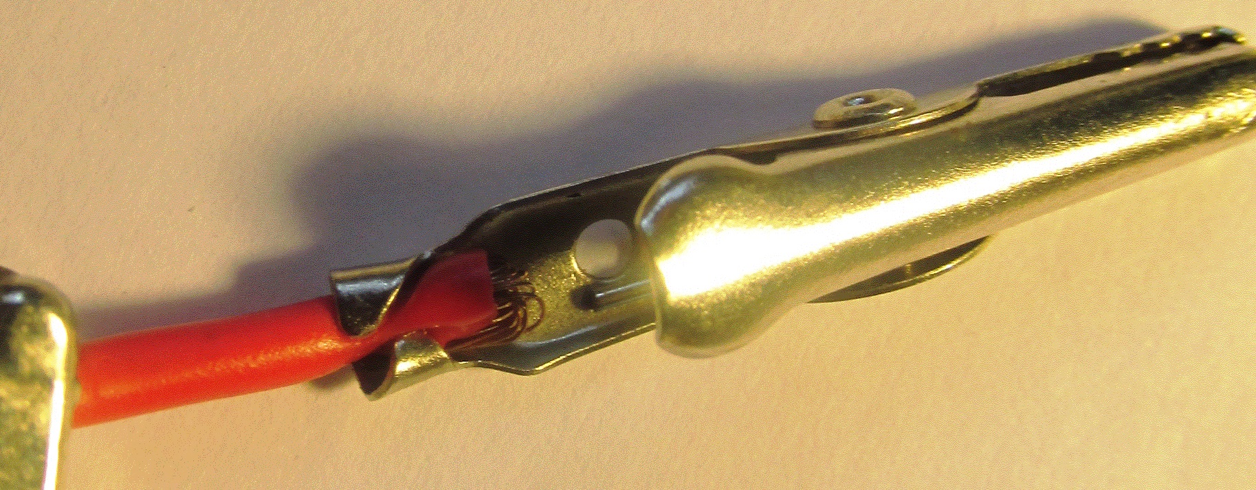

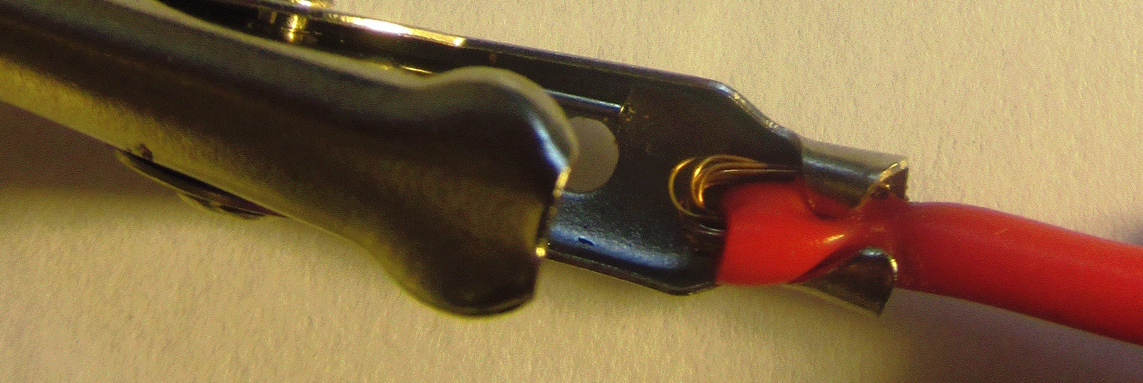

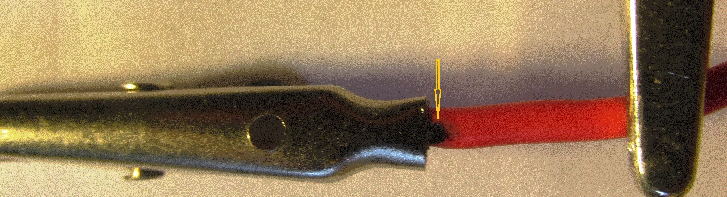

In the process of building an amp I've been using crocodile clips in the psu section.I'd been experiencing some odd behaviour when checking actual voltages on test.I put this down to house mains variation.After all it was making sound.But last night I noticed a mini thunderstorm in the jaws of the clip lead at power on.Wish I had a recorded footage of it.Amazing to see!
On pulling back the protective covering here's what I came across.The maker didn't even bother to solder the leads.Penny pinching?

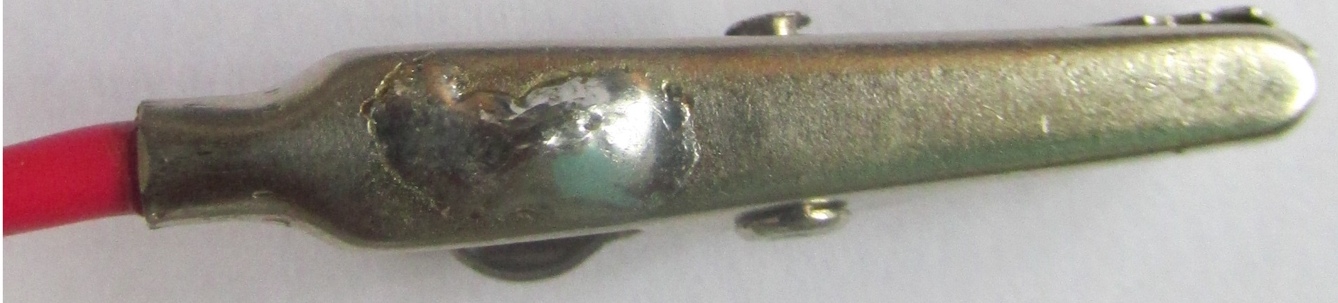

First pics are of the offending sod of a lead,the rest my repair job.
