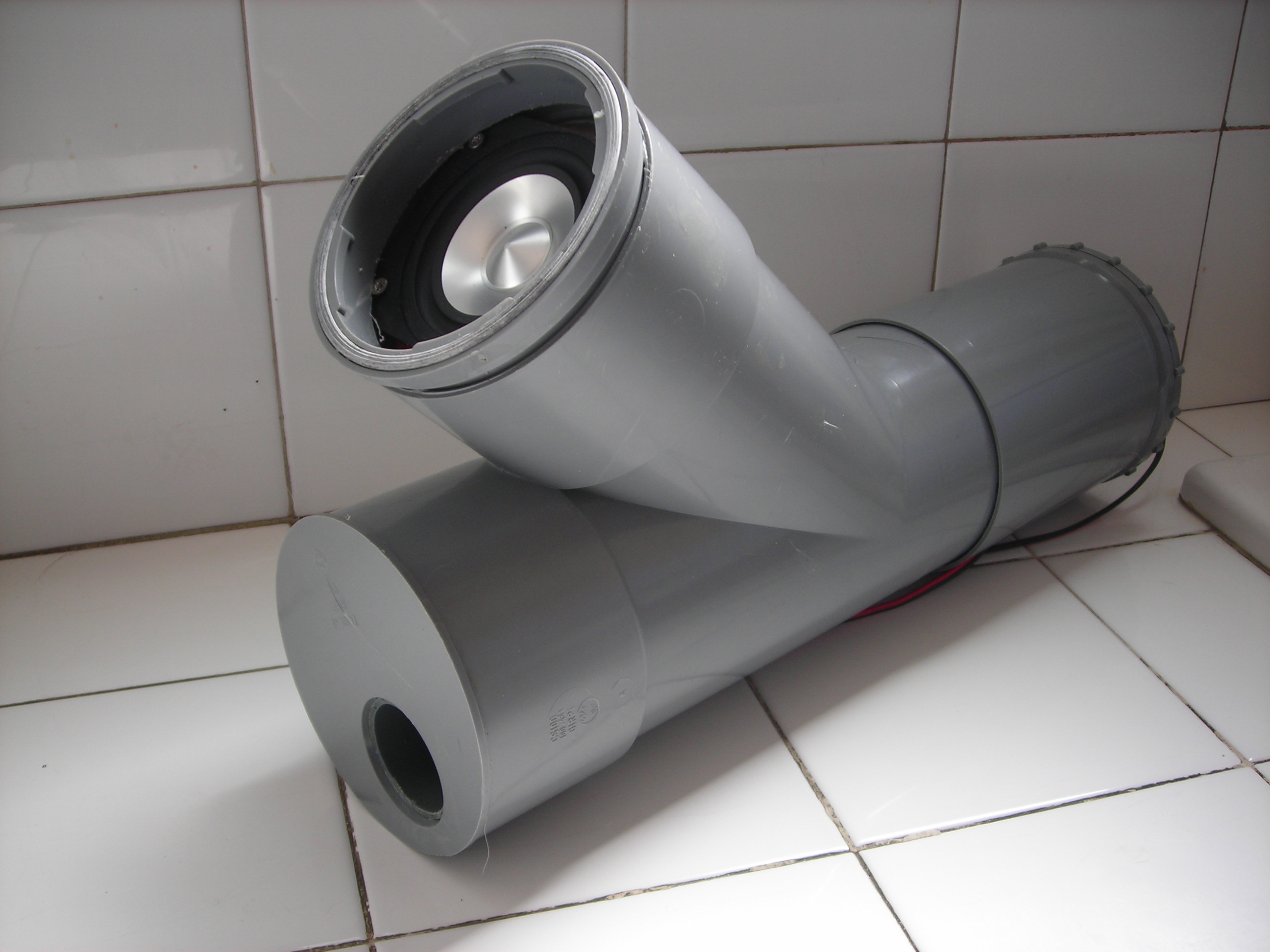

I try to know the kind of sound I can get with those bright JordanJXR6HD speakers: I want to use them as main speakers outside of my sailing boat.
I desing the box in a WC exaust hose ( have to resist storm force wheather= see attached). It is a regular bass reflex 2.8l box / 3.6cm diam and 17.7cm long vent.

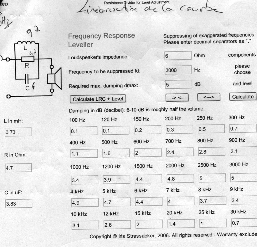

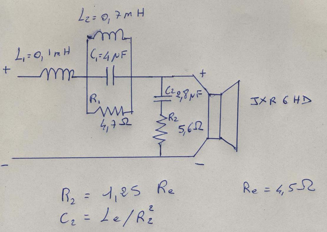

It seems to go a low as 85-90hz as shown by WinISD curve, but I found first the sound a bit "shrap" and in fact it appears on the typical response curve that it needs a slight attenuation (4-5 db) after about 300 hz. So I add:
an attenuation circuit
a 6db/oct- 10000 hz lowpass filter
an impedance correction circuit
All that could seem to be a lot for such small speaker but the fact is that I enjoy the result.Very precise , bright and not aggressive.
But I need your advises or experience about such filter for this fullrange
See fdoc attached an excuse my bad english

I hadn't realise you were using it in a bass reflex. So yes, it is very likely that - you're using it in a way which was specifically NOT recommended by the manufacturer.
As Audiosteve says, the JXR6 has ferrofluid suspension and no rear spider. It relies on the sealed box to provide the rear suspension and damping. Quite apart from the sound implications, you run a risk of damaging the drive unit. And don't forget these are now hard to get hold of so if one goes, you're looking for a pair of other-make drivers.
In my experience, whatever the computer simulations say, the JXR6 rolls off below 150Hz in whatever size box you use it (I've tried up to 4 L).

You might also want to reconsider the depth to which the drivers appear to be recessed in the PVC elbow - these have fairly wide dispersion and I'm sure would be effected by the cavity formed by the close perpendicular side walls
And keep Colin's notes in mind - without substantial efficiency cutting EQ, don't expect much in the way of LF extension or SPL from any configuration of singles, or even doubles of this driver per side.
I put a olt of damping material inside, sound rather good.

In fact I simulate with an equalizer the result of the resonant circuit RLC shown at the begining, and if you mean there could have "bad" resonances this simulation gives THE good result...

Perhaps that phrase was poorly worded - my point was that often builders will attempt to compensate for trailing LF response by aggressive EQ. Whether performed actively before amplification, or passively, and whether by boosting lower frequencies or reducing higher ranges, the results will effectively be the same - potentially smoothing the measurable and audible response adequately, but there's no magic solution to any given driver's X-Max / excursion limits - which will ultimately determine the volume levels attainable. With drivers possessing enough sensitivity and excursion capacity, this is not necessarily an issue, but the little Jordan might not meet those criteria.

again this morning ( in france ) I listen to the final system and it is really an "enormous sound" regarding to to size of the driver. ( 2.2 l closed + passive equalisation + bass pass band cabinet 50 to 150hz).
I test it last night with metallica black album and it was the first time I heard the mediator on the bass string !!!!! incredible sound up to 10w or so
