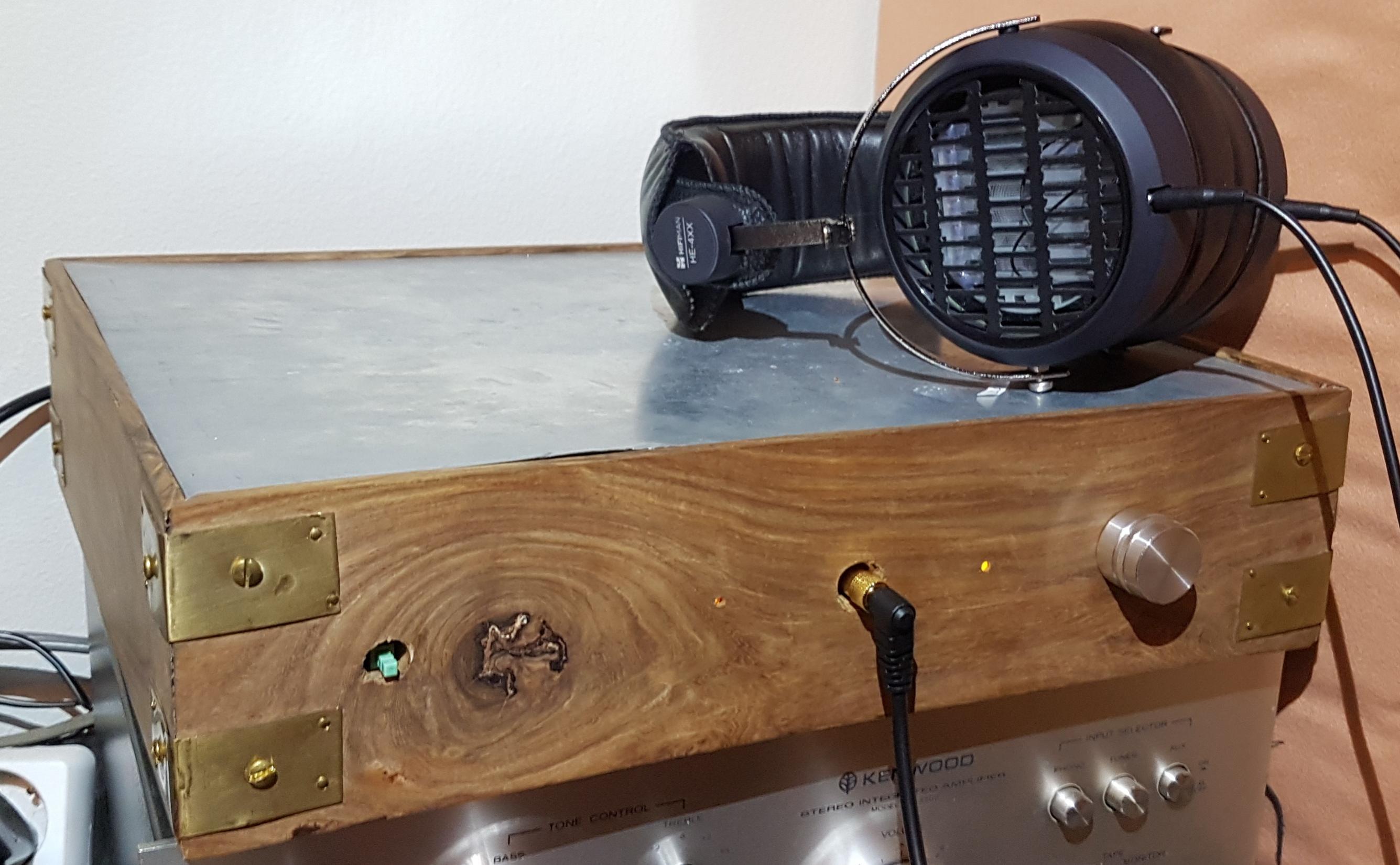

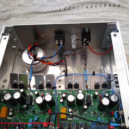

Halldor Scheving Vidarsson who lives in Iceland send me a link with a lot of pictures concerning the build process of my Headphone amplifier.
I have some PCBs available if someone is interested to build this amplifier.
Here are two of these pictures:

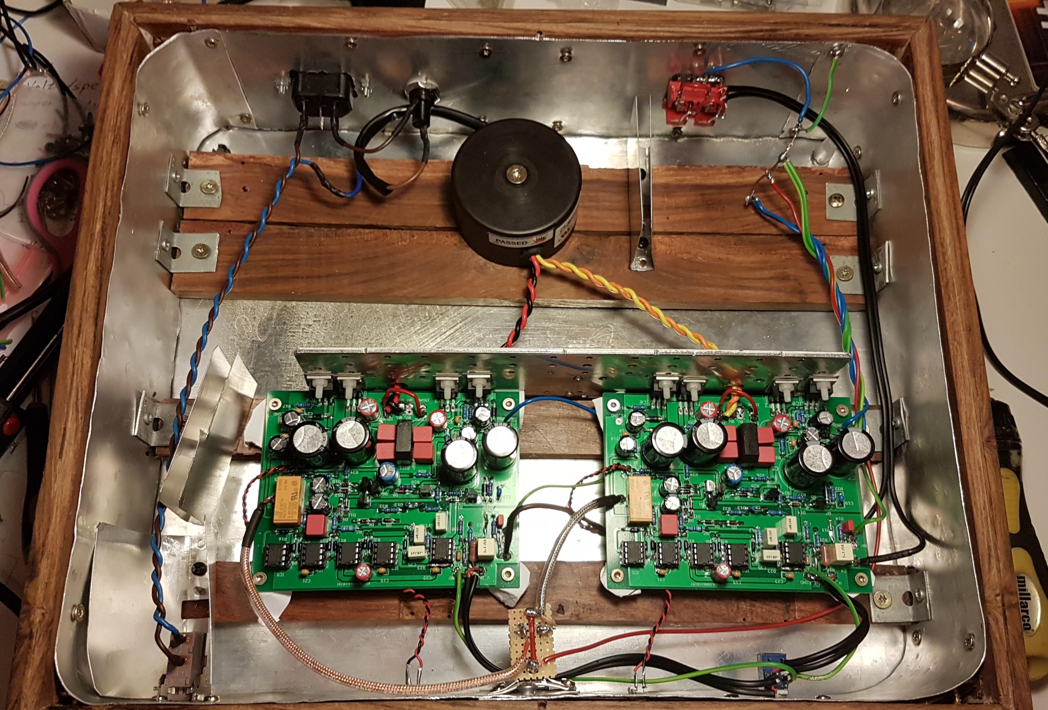

Gdan,
Thanks for bringing our attention to this amp - looks like a nicely designed full-featured HPA/preamp.
I like the implementation in a metal lined wooden case - nice!
I built a HPA using the OPA1688 in parallel, it can deliver 75mA ea, so would require only 4 amps (or 2 dual IC's or 1 quad IC) for the same power, and I think THD is slightly better. Here is a hand etched dual parallel implementation with a custom power supply using DC-DC for 24v rails and then TPS7Axxx low noise regulators for battery-like +/-18v supply. It sounds very nice - quite powerful at 150mA. I am working on a parallel x8 version.
Here is layout if anyone wants to try - super easy to make:

An construction note
The 9Volt output relay that is used in the Headphone amplifier is replaced with a 12 Volt relay which is more easily found.
Only some resistor values (R29, R35, R36) are changed for this.

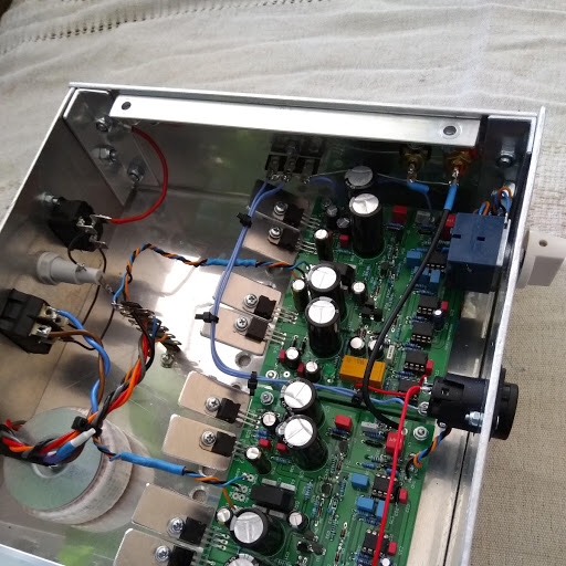

Matti Pussinen who lives in Finland build my headphone amplifier and was very pleased to send me this message:
"Dear George,
I have a very good headphone amp, yes indeed, so good, I like it.
Dead quiet, and all is there. Been listening almost my all cd collection. And vinyls."
He also send me some photos of the amplifier.
Here is the first:
"Dear George,
Here is the first:
