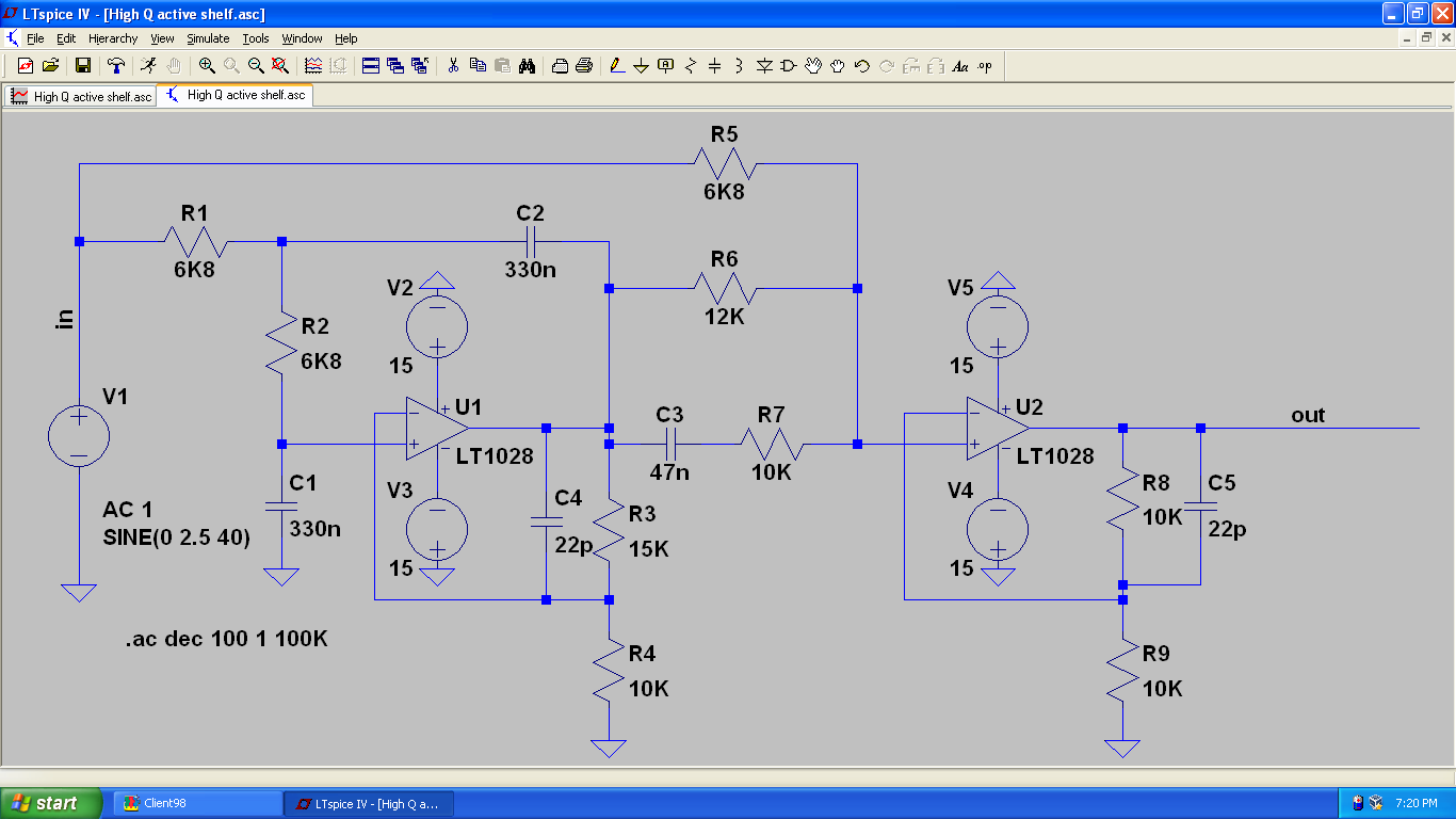

I've been EQing my transmission line speakers using a miniDSP. This is nice, as it gives me a lot of flexibility to correct the shape of the response. However I'd like to take the DSP away at some point and use an analog active EQ, because it's quite a lot cheaper and simpler, and because analog circuitry plays nice on the quiet side of the volume control.
However I haven't had a lot of joy getting an EQ with the fast second-order slope that my speakers want. The published designs tend to have slow rolloff, and the Linkwitz transform, combining a shelf and a notch, just clobbers the bottom octave of the speaker.

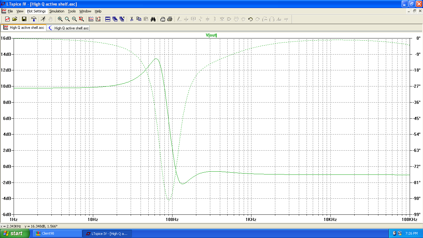

Anyway, I thought I'd experiment a bit, and think I might have a workable solution. I started with a simple Sallen-Key low-pass, with a voltage divider in the negative feedback loop to allow for higher Q (and hence faster roll-off). Then I simply used a second stage to sum the output from my low-pass with the original signal.
It wasn't ideal, as the phase shift from the low-pass still created a reasonably deep notch an octave above the cutoff frequency. I cleaned this up by adding an RC element to sum an additional further phase shifted version of the filtered component. That gives us an extra pole that we can tune to correct for the notch.
The result is as shown. R1, R2, C1, C2 set the cutoff frequency. R3, R4 sets the Q. The shelf depth is set by R5 and R6, and the depth of the notch can be tuned by C3 and R7.
The values shown give a 10dB shelf with a small 14dB peak at ~65Hz, and no gain from about 100Hz on. This should correct the response from my SB12NRX transmission lines nicely.
I don't follow the logic or lack of, in your post.
What Fc and Q are the stages in your DSP implementation of a second order filter? What alignment, bessel, bw?
I cannot see a good reason to arbitrarily increase Q Without following your design....seems like a waste of time to me. Besides....Sallen key is only stable for Q less than 3, so watch you haven't passed that point.
I've built up to a 5th order Chebyshev ish filters in Sallen Key with no issues.
List your stage Qs and Fc.'s and alignment and I'll have a look on the simbobulator

The DSP software simply asks for frequency, Q and attenuation when creating a shelf. I presume it's implementing a second order filter but have no idea what it actually does under the hood.
Increasing Q allows me to create a peak at Fc and a sharper rolloff. This is kindergarten stuff. I simply match the size of the peak to the dip in my response curve to correct it. In this case gain is 2.5, so Q is 2. I thought that was obvious.

Oh the irony.
First off....your filter transfer function wants to be the inverse of the speaker's.
I am assuming you're trying to linkwitz it.
So depending on exact TL damping and alignment you want a 2nd, 3rd or 4th order slope.
Increasing Q to 2 may help you get there but isn't the way to achieve that slope. Try another stage. And set Fc and Q based on textbook butterworth alignment.
Then you can tweak the Fc to slope match.
That is kindergarten stuff. Do that right first. This is a prefect example of bad use of DSP and misunderstanding of the task at hand.
Implement a infrastructure HP filter to stop your woofers bouncing their coils out the gap permanently.
A good DSP matches analogue design....while your volume is maxed out and you're not throwing bits away....
Peace.

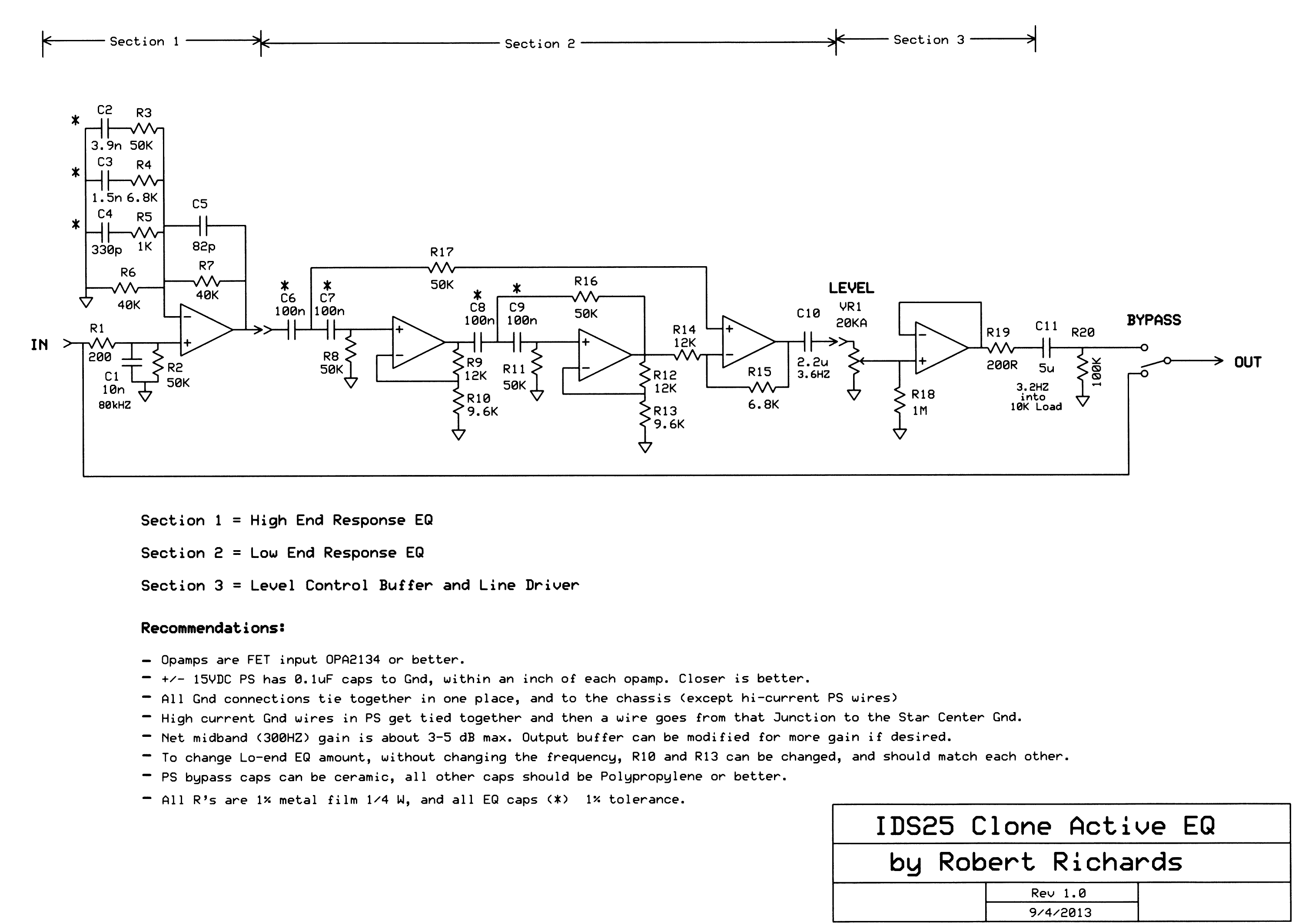

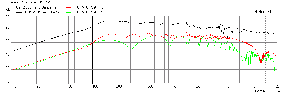

Cloning IDS-25s
Here was Bob Richards's circuit:

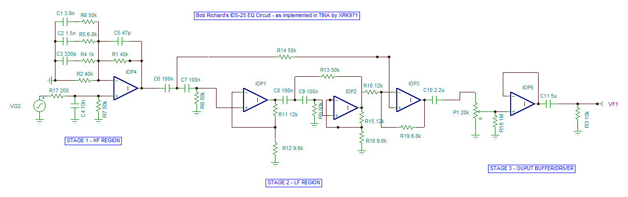

Here is my sim of Bob's circuit in TINA (before I switched to LTSpice):

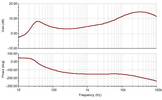

Resulting gain function:
The next task was to take a sim of a 25 driver array in Akabak and try to implement the op amp EQ inside Akabak...:
This was as far as I got on the circuit in Akabak:
But nowadays, we do all this in miniDSP or in Jriver as a convolution or PEQ banks and save our opamps for another use. 🙂

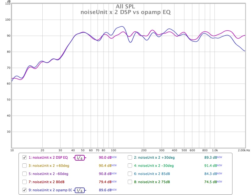

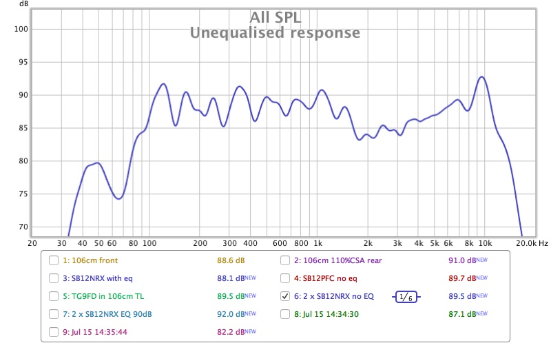

Here's a quick test of the real thing with my speaker.

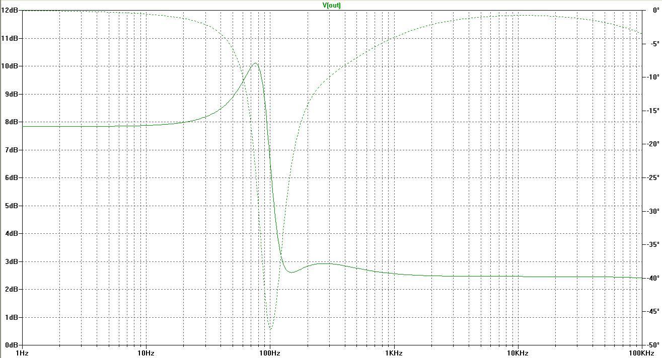

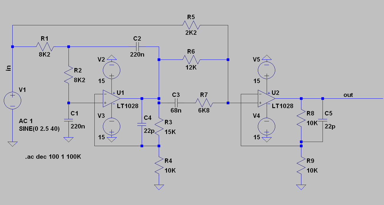

I've attached the schematic I ended up with to EQ this speaker - rather less bass boost was needed, plus a photo of the nasty prototype and the actual measurements, both of the prototype transfer function using my spec-an and tracking generator and finally a comparison of the correction I'm able to achieve with DSP vs that with the opamp circuit.
It gives me a reasonably accurate correction of the TL rolloff. There's a bit of a dip at 150Hz that's of rather higher Q than I can easily correct for, and you can see that my attempt to deal with it has left me with a bit of a peak at 120Hz, but on the whole I'm pretty happy with the circuit. It's amazing how many ergs you can squeeze from a poxy 4" driver.
