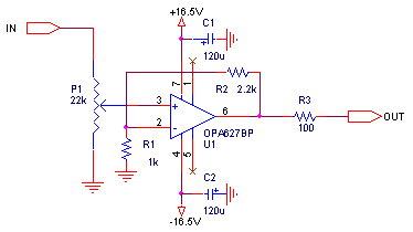

ok.. its sure im certainly in for some flaming with this.. but i cant do elsewise.. i have built an opamp preamplifier (that is, with ic's...) here it is: what can i do to get it better? (only gainstage shown.. supply ordinary LM stuff) resistors cheap metal films hand matched to 0.1% (holco's on the way), decoupling through Elna RJH. pot alps 27mm.. so?
I would recommend 10-100 nF polyester 63 V or ceramic, SMD as a complement to 120 µF. In fact it's more important with small high speed caps than big electrolytic. OPA627 is rather fast and therefore you need decoupling which is fast.
I could think of a few things....
Howzdat for freaky?
Basic design is an amalgam of stuff I played around with before but with a battery supply, PSU where also tried at some point in time, in a Phonostage. Circuit drawn by Carlos M.
Recommend placement of the feedback resistors (all Op-Amp's) as SMD Resistors soldered directly at the pins. Powersupply is per supplied chip, wiring between regulator out and supplied chip must be minimal and no supply decoupling should be applied. If critical apply a 100pF SMD COG Cap between the positive and negative supply of the amplifier chip.
Pot should be ideally 1K log which is difficult at such low values. Alternatively a 220 Ohm Linear should work okay with a 470 Ohm "build out" resistor, please use cermet track pots if you can, if not carbon. Also, then you need to compensate the gain loss. Maximum output Z with 470R & 220R Pot is around 200R, with 300R & 1K Log it is 230R, both at maximum volume.
Sadly, transformer based attenuators as passive linestage are notably better still....
Sayonara

Re: Re: a heretical preamp
why?
Kuei Yang Wang said:Hi,
........... no supply decoupling should be applied.
why?
Re: Re: Re: a heretical preamp
I thought that would be obvious. The individual Op-Amp used as "regulator" does not tolerate much capacitive load. Up to around 100pF will be okay, much more and the thing will oscillate at VHF frequencies....
Sayonara
why?
Sayonara
The schematics is slightly wrong. The LM431 is a little bit wrong connected. Cathode upwards and anode downwards.Kuei Yang Wang said:Hi,

sure, there would be a problem with capacitive load.. but i would put on as much as i could get away with say 68pf
also if u have time.. please discribe your thoughts on those input FETs

You are doing fine, costiss!costiss said:ok.. its sure im certainly in for some flaming with this.. but i cant do elsewise.. i have built an opamp preamplifier (that is, with ic's...) here it is: what can i do to get it better? (only gainstage shown.. supply ordinary LM stuff) resistors cheap metal films hand matched to 0.1% (holco's on the way), decoupling through Elna RJH. pot alps 27mm.. so?
Very good OPamp OPA627 (peranders has just bought some)
Metalfilm matched resistors
ELNA caps
ALPS potentiometer
And I am sure you will get a good Power Supply.
You already got the best boys as assistance!

Kuei,
Thanks for an interesting design. I have two questions about
the regulator part.
1) It seems reasonable that all the regulators share the
circuitry connected to the positive inputs (ie. the reference
voltage circuitry). Do you agree on this?
2) Would you consider it sufficient that they also share the
capacitors on the preregulated rails, or should these be
per regulator and as close as possible to them?
Just like a previous poster I am also a little bit curious about
the JFET buffer. I assume the purpose is to make the input
impedance invariant of the attenautor. However, I see that
they use a fixed Vgs of 0V and have no feedback. I assume
this particular topology is intended to be very linear, but I
do not quite see why or how (although it is a bit late and I
am tired, I admit). I also guess they have to be well matched.

Yes. If you need for example for a Phonostage two gainstages per channel you can use dual Op-Amp's, assuming the layout remains tight.
Doing this on PCB's almost literally means using two PCB's arranged with the two soldersides touching, locating each regulator chip output pin directly next to the supply pin driven by it. In short, think 3D not 2D.
The latter. The smalles (physical & value) capacitor closest to the chip then the larger ones. The PSU Reg Chips do need to be stabilised against oscillation by having their supply pins well decoupled.
Well, the input impedance IS invariant of the Attenuator, but as the circuit is following the SPEEDO Axiom and the INVERTING Axiom the input impedance is rather low. The two Idss @ 15V matched (and thermally connected) J-Fets simply buffer the low input impedance of the Op-Amp and provide a high impedance input, in fact pretty much as high as you like (1M no sweat)
Actually, the topology is not intended to be very linear, it actually is. Driving 3V RMS into 1k will give around 0.008% THD, or better noted -82db THD, and this THD is rather low order and thus of low subjective sonic impact.
Yes, one could have used an OPA627 connected as follower, but somehow this simple J-Fet buffer struck me as more "Zen", just as the J-Fet MC stage on the Phonostage that this linestage was matched with (namely the "analogue addicts phono") seemd a better idea than a gain of 20 AD797. I guess it's a question of "designers fingerprints".
Ciao T

Thanks for the answers Kuei.
However, on question number 1 I am still not sure if it is me
not understanding the answer, or you misunderstanding my
question? I repeat both my question and your answer here
to avoid potential further confusion.
After thinking for a while I came to the conclusion that you
probably assumed separate preregulated supplies for the
channels, in which case your first paragraph makes sense.
I am not sure how the second paragraph relates to this,
however.

No. The LM6181 used to "regulate" the PSU for the actual Amplifier (also an LM6181 of course) is a high speed operational Amplifier. It requires it's supply lines to well decoupled locally, hence all the capacitors on the supply line are per chip.
The pre-regulated supplies can be shared of course, as can be the references, though this makes layout akward.
Sayonara

That makes it clear, thankyou. It was the sharing of references
I wondered about. Since I know you pay a lot of attention to
details I did not want to take for granted that it would be OK
to share the references, although it seemed straightforward
to do so.

Perhaps balance the input impedances seen by the opamp´s both inputs.For more info look here:

I would like to suggest using a 47kohm log pot instead of 22k. 47k is the standard input impedance on audio products.
/Frez
/Frez
This would been have true 20-30 years ago. DIN-norm?frez said:I would like to suggest using a 47kohm log pot instead of 22k. 47k is the standard input impedance on audio products.
/Frez
With todays sources, read CD-standard,
I would use 22kohm or even lower!
NE5534 which is a rather old one OP, can drive 10Vrms/600ohm max.
2Vrms into 1kohm would not be much.
Not even two loads 1kohm parallell= 500ohm
would upset NE5534 very much.
The standard, soon to come will be <= 10 kohm.
That is halo's prediction.
47 kohm is long time ago outdated, in practice.
