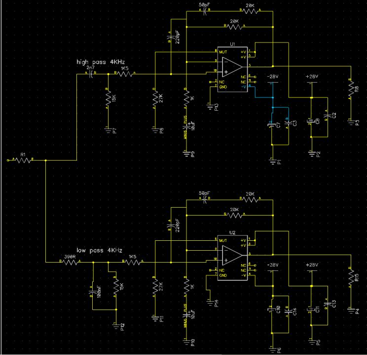

The intention is to allow other musical instruments to plug into the "guitar" amp, so after looking at my 12" speakers (up to 5KHz says the bumph), I decided to buy a set of mid-range drivers that go up to 11 KHz (says the bumph). Those boys (and girls) could plug a violin, a bass, a keyboard, a mic maybe - I had to allow for more than plain guitars and 5KHz sounded a bit limiting.
So I thought a split at around 4KHz was the proper place, maybe 4.5KHz.
The reason for using the LM3886 was that is is quick and easy. It can do 68Watts on a 4R load or 50 Watts on a 8R. So if I have two LMs I will be able to do over 100 Watts, maybe 135 Watts.
In the future I may build a discreet post amp, but I want the design to be mine, so that will take some time 🙂

I have 4 speakers in total. All are 8 Ohm. The 12" units go up to 5KHz and the 5.25" drivers go up to 8KHz. I was wondering what is the best way to wire them to the two LM3886s.
On the schematic above I had the idea of splitting the signal at 4KHz (ish) so that one LM drives the two 12 " put in parallel at 4 Ohms so I get 68 Watts RMS. The other LM can drive the two 5.25" again in parallel so I get another 60 Watts.
However I can see a problem with this design: 90% of the signal will be in the 16Hz - 2000 Hz range so the grunt of the work will be done by one LM3886 only while the other one will be sitting almost idle.
Alternatively I could wire it so that each LM3886 drives 2 speakers, a 12" and a 5.25" without a crossover. What would happen if say the 5.25" receives signals below 300 Hz (its bottom end) or if the 12" receives signals above 5KHz (its top end)?
You can tailor yourself a simple 6 dB/oct crossover with and coils and capacitors you ought to have on hand. 1mH and 22uF could be used. You can even try series crossover , the cap in parallel with the 12'' unit in series with the coil paralleled to the 5'' unit.I would have each amp driving a single loudspeaker or two same units paralleled , and focusing on the preamplifier/tone controls/active crossover section which could be easily made with two common tubes in classical Cathode Follower configuration ...or does 200-300 volts scare you?
