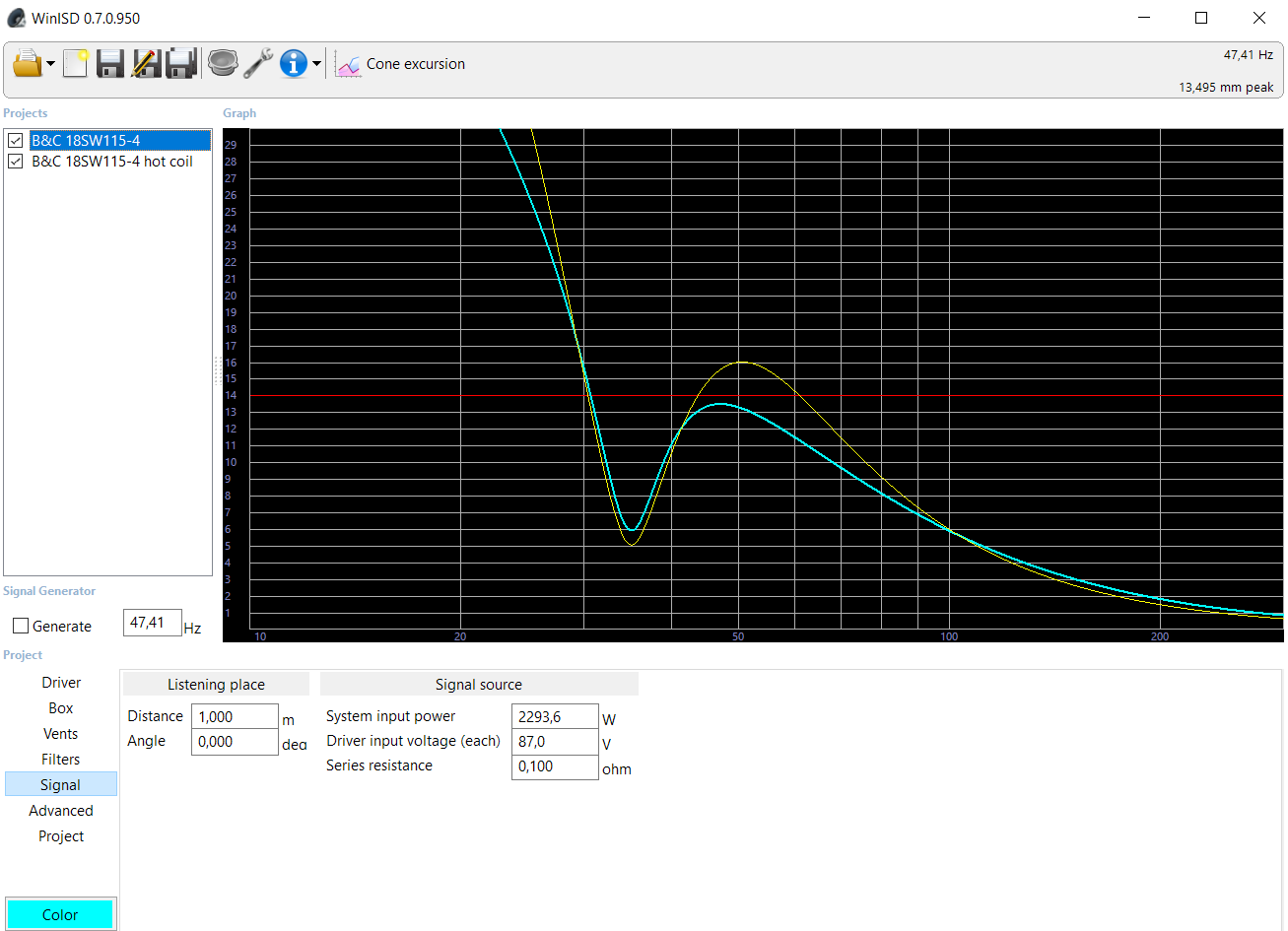

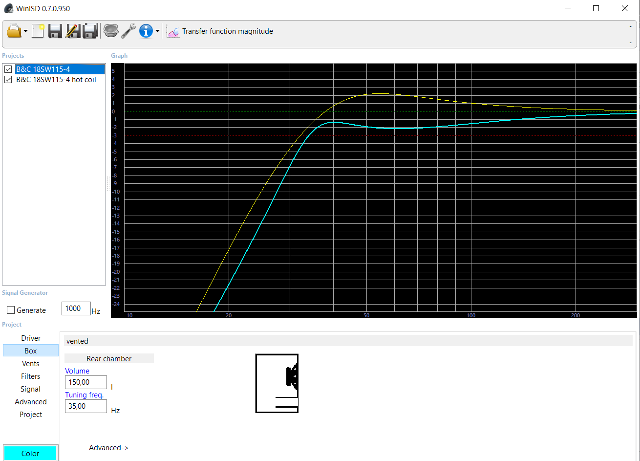

... when applied 87 volts to both cabs, which is what I feed them in my Keystones).
That is 1892 W into 4 ohms. They might take a bit more, as B&C claims 1700 W continuous power handling (2 hours, pink noise, free air, band limited to fs .. 10*fs) and music has a certain crest factor. I am not sure on this.
... with the 18sw115-8 I cannot seem to get a linear frequency response while making use of all the drivers excursion in, as far as my rather novice mind can make up, a satisfying way. Either the frequency response is linear and the excursion is way lower than what the driver is capable of (In a small box), or the frequency response is raising quite a bit when the box is big enough and appropriate filters are applied for the excursion to look good to me (when applied 87 volts to both cabs, which is what I feed them in my Keystones).
The 18SW115-8 is a modern PA driver. These usually are designed with a strong motor. A strong motor is good for efficiency but results in a rising frequency response, with increasing frequency. The rising response is supposed to be equalized to a target curve with a DSP. I see this is not exactly what is happening with this woofer in its recommended enclosure, but it is good to know that the raw frequency response is not that important. Maximizing sound output for a given packaging size and price tag is more important. Also keep in mind that the coil will be hot during use, which increases Re.
The recommended enclosure is 150 L, tuned at 35 Hz.
https://www.bcspeakers.com/en/products/lf-driver/18-0/4/18sw115-4
Thanks, as I've got the 8 ohm driver 87 volts should be about 1300-1400 watts if the Zmin of the driver+keystone combination stays around 6.5 ohm, which I'm not sure of. I've tried giving it 95 volts once for about 2-3 hours and it definitely kicked in a higher gear but I've not dared to try it again, it was super loud and clean however 🙂
Is finding a good balance between good excursion graphs and okayish frequency response a good preference, then Eq to taste? It's kinda sad to see low excursion figures from the 18sw-115 in small cabinets even with high power applied, isn't that throwing away the drivers potential to some extent?
