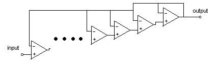

Cherry's work involved applying feedback spanning 2 consecutive stages... "nested" feedback, rather than Global feedback... between the Input and output stages of the amplifier.
"No Feedback" has been turned into a markeing tool and is clearing a misnomer. It is Impossible to design any practical amp with Zero ( Local ) feedback. Even if there is No external emitter resistor in a voltage gain stage, there will Always be an intrinsic emitter resistance of the device itself. This is what yield a finite voltage gain in a common emitter amplification stage.
Yes, as rightly pointed out, the Emitter follower ( buffer ) present in most "Zero Feedback" amps has 100% feedback !
"Zero Feedback" I believe is supposed to refer to feedback between the over all input and outputs of the amplifier.

Actually the feedback question is more complex than expressed here. There is also higher order distortion generated from lower order linearities and FM distortion generated by non-linear input stages within a feedback loop with low open loop bandwidth. Real audio designers take negative feedback very seriously.

.🙄 Feedback
Has anybody analytically proved that feedback makes the output any closer to input signal? For any music type of signal?
It is weel known, that feedback reduces non-linear distortion of a purely static memoryless system, rises freq. response of some (Nyquist criterion) perfectly linear systems, and reduces noise added to a wire with gain.
But what if these three interact? Term 'conditional stability' is born but not very much investigated.
We have some examples that feedback may make things worse when:
-any of stages gets overdriven, even by distortion component of the other stage or even noise
-the amp has low slew
-any of stages gets saturated
-one of above causes non-stability for a while
Anyone denies?
