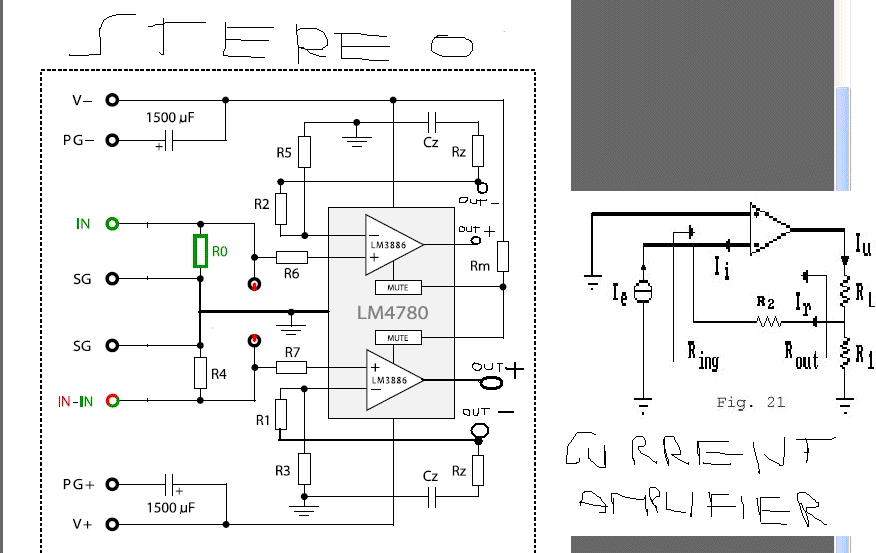

Attached to this mail there is a file with a my personal interpretation....of a current amplifier....
I don't have pspice or other software, so i don't know if this current amplifier is good...or not....
Is it possible to have an hand please??? 😉
in your opinion is it right? oscillate or not?
if is it right can you help me to determine the Output impedence, the current gain, the output current and the input impedence?
Do you like my idea?
i hope you can help me to reach this goal....
this is the original configuration (i use stereo mode)
http://www.audiosector.com/lm4780 amp.pdf
thanks
max

Download the free TinaTI circuit emulator and play with it.
http://focus.ti.com/docs/toolsw/folders/print/tina-ti.html
If you cannot manage the above you should go nowhere near
a real circuit with a soldering iron trying to change its operation.
And yes you can modify it to any output impedance you like,
including very high impedance constant current mode, as
opposed to the very low impedance constant voltage mode.
🙂/sreten.

...the last mail for today, sorry.....
this is an ipothesys of implementation of transconductance amplifier using the LM4780 kit that Audiosector sell.
this is a my interpretation.....
at the end we have to put a little resistor 0,5 ohm with big power in my opinion (20 W) connecting the negative pole of the speaker with this 0,5 ohm and not directly to earht.... as in the picture.
the 22K resistor (R1/R2) must be bypassed and R3/R5 must be disconnected.
in my opinion this is a transconductance amplifier with infinite output impedence.
is it right? in your opinion is it possible that it works well?
thanks boys!
max

at the end i think i will adopt the Elliot tecnique for transconductance amplifiers......thanks sreten!!!
i will use a 0,5 ohm impedence. The gain will be 16 on a load of 8 ohm with a constant current of 2Ampere with 1 volt input.
32 Watts on the load and 2 watt on the resistor.
With an input of 3 volts (very high input) The gain will be 16 on a load of 8 ohm with a constant current of 6Ampere.
288 Watts on the load and 18 watt on the resistor.
6 ampere is a a good current but is certainly under the LM4780 limit of 14 ampere (that's ok!)
max

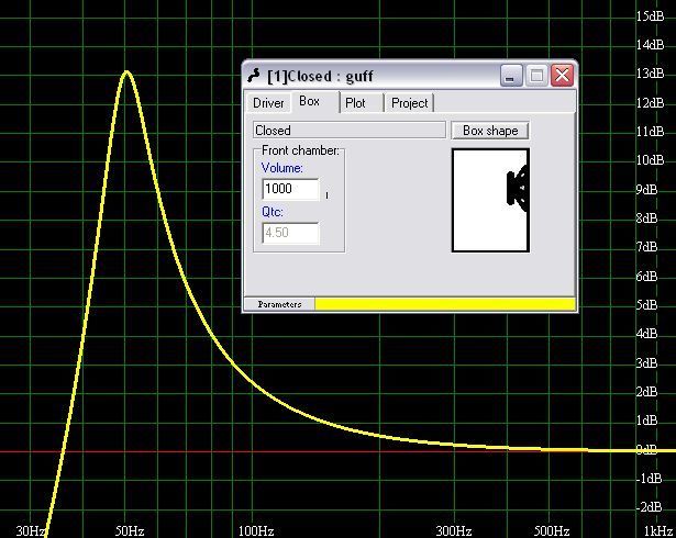

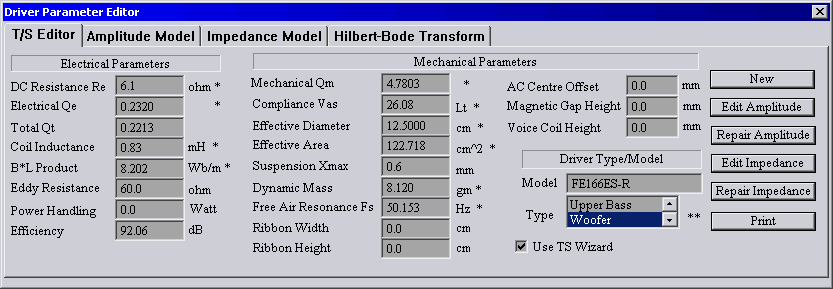

I will caution that with current drive for the loudspeaker:
Qts instead of being based on Qes and being slightly lower, will be based on Qms and be slightly lower due to a nin-infinite impedance.
What does this mean for a typical full range driver, e.g. Fostex FE166ES-R :
A pronounced treble lift, impedance should be RC'd at supersonic
frequencies to prevent pointless voltage swing. A bass boost :
Related to an effective Qts near 4.5, does not look pretty, needless
to say output impedance interaction with Qts means you need to set
it to what you can get away with, or at least add a parallel resistor.
🙂/sreten.
🙂/sreten.
