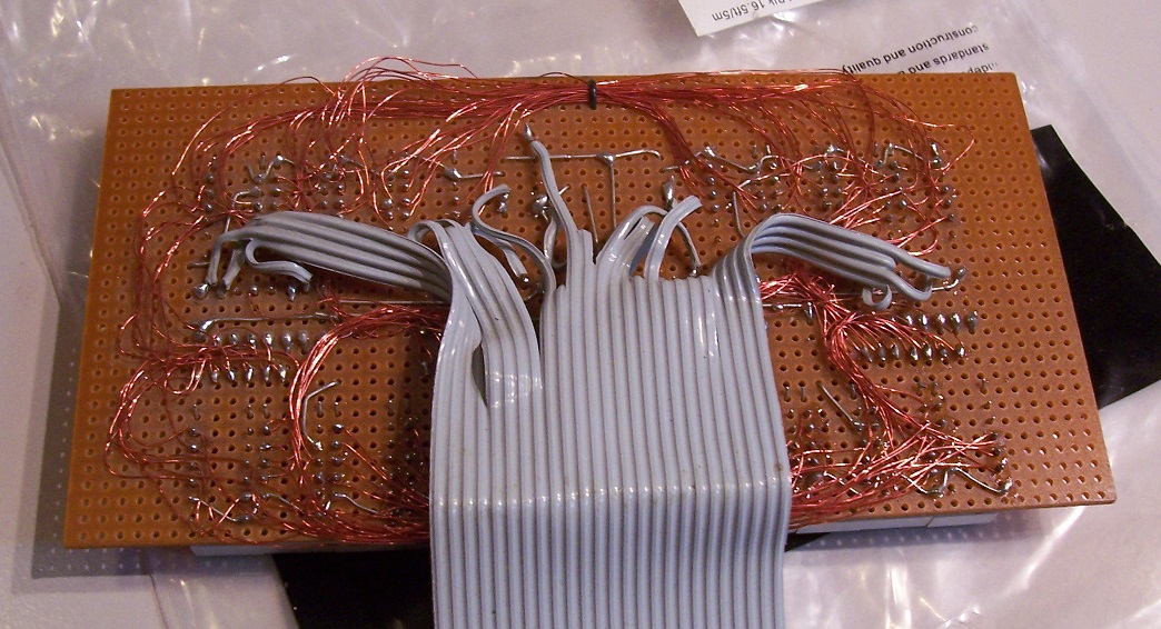

I need a very small tinning bath, because my "complex" digital prototypes are wired using the émafil technique:
Until now, I was tinning the wire ends with a soldering iron, but a bath is much more practical.

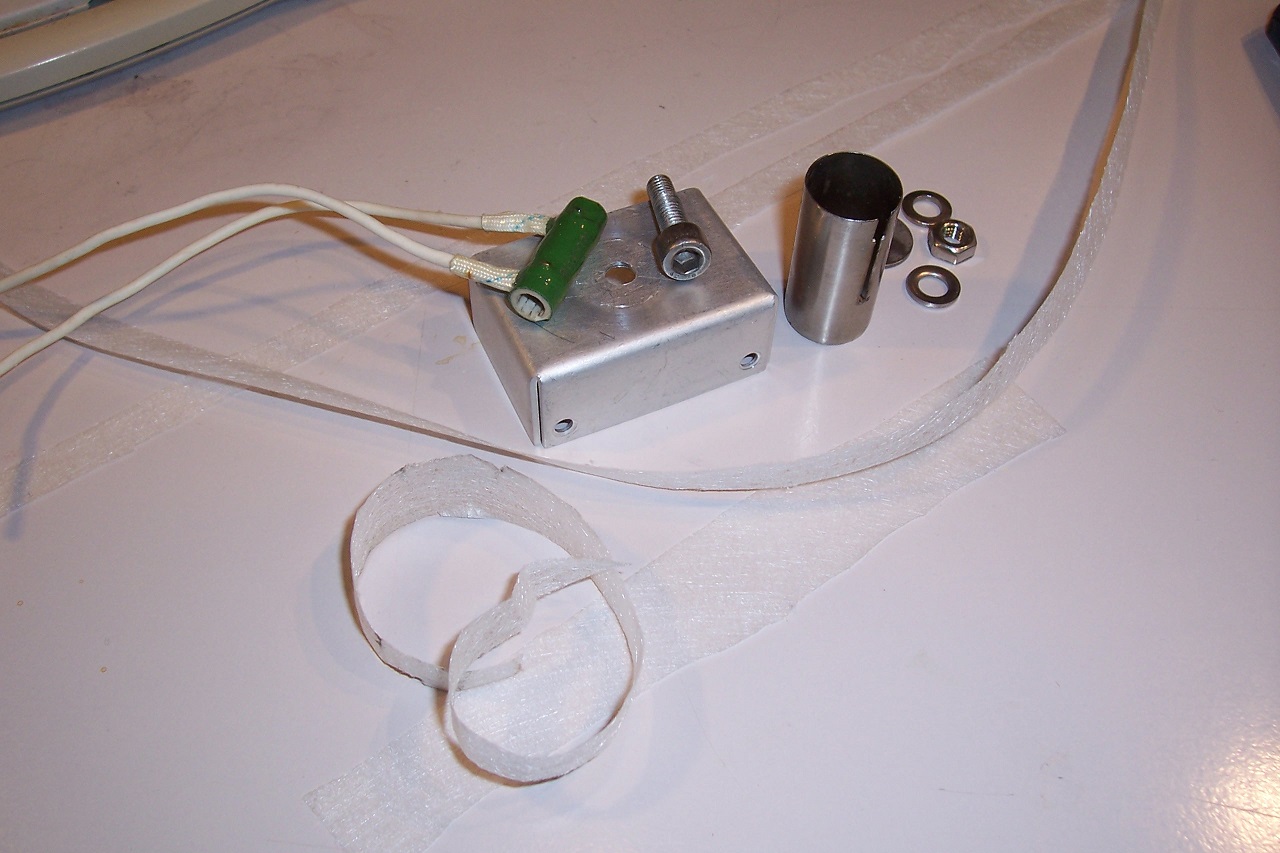

Here is a description of my build.
I started with a 82Ω 7W vitrified WW resistor, heat-resistant cable and tubing, a bit of non-woven fiberglass sheet, a 6mm metric bolt made of stainless steel (important), a piece of thin-walled stainless steel tube and a stand.
The end of the bolt has its diameter reduced to 5mm for a 7mm length, to allow the insertion into the resistor.

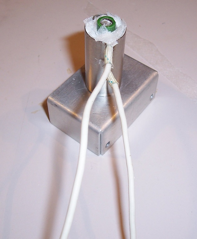

The assembled thing looks like this:

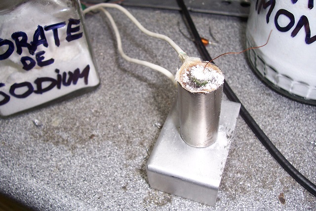

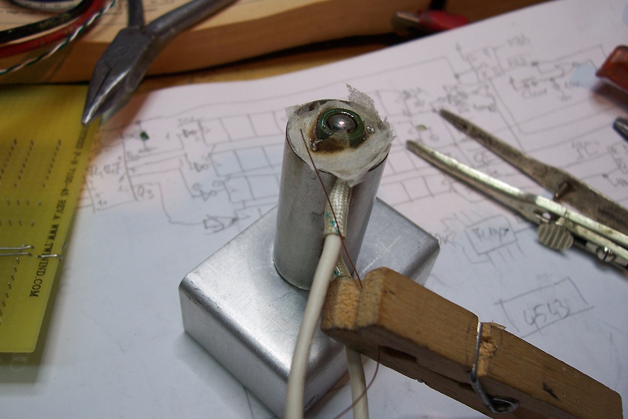

Here it is in action, fed by a 30V DC supply:
Afterwards, I found that I could protect the solder surface from oxidation using a mix of sodium borate and boric acid: they form a brittle and crumbly crust that is easily penetrated by a wire, even a thin one.
There are probably more suitable compounds, but it is a good beginning
