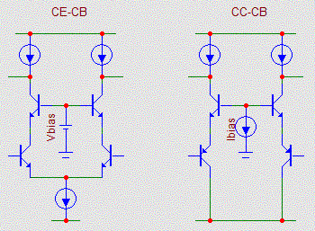

Virtually all differential input stages have a common emitter differential pair. This configuration suffers from the Miller capacitance multiplication effect, and has therefore low bandwidth.
Cascoding with a common base stage reduces the Miller effect, and increases bandwidth. This is straightforward and has been done often.
I was wondering why the common collector (emitter follower) "cascoded" by a common base stage is not used. The emitter follower inherently does not suffer from the Miller effect, but does not provide voltage gain. Therefore we use a common base stage, where the Miller effect is also absent, to provide the voltage gain. The emitter follower should be more linear than the common emitter stage...
Why has the CC-CB configuration not caught on, like the CE-CB cascode?
Has anybody any experience with it?

As noone here has experimented with this topology, would there be, from a theoretical point, any advantages of this topology compared to the common differential pair?
A few simulations I have done show quite greater bandwidth and phase margin at a higher open loop gain than a comparable standard diff input, when driven by a low impedance source. This sounds good. I don't know however how the linearity compares.
The drawbacks: biasing. Due to the large gain, bias point varies wildly with tiny changes in most components. I also couldn't figure out how to apply local feedback, like the degeneration emitter resistors used in standard diff pairs.
Any ideas or comments would be appreciated!

The circuit last posted by kyrgeo differs from the one posted first.
The latter one would be much easier to bias and implement with discretes (current source feeding collectors rather than bases !!). Degeneration resistors could easily be inserted between the emitters of each one of the two complementary cascodes IMO.

As I now see it, biasing is only difficult if you want both differential output and active loading. Single ended output with active loading (current mirror) or differential output with resistive loading are relatively easy to handle. A 10 Ohm trimpot should do the job of balancing any mismatches.
The real difficulty is to match the current of two current source loads to the current of the common-base transistors in the <1uA range. This is practically impossible...
Regarding local feedback, inserting a resistor between the two bases seems to decrease gain a bit, but it also alters the frequency response considerably, so I don't think this actually provides negative feedback.
Hi Charles, of course you can "replace Q1 and Q2 with a current output differential signal source". This is done in all normal cascoded differential pairs. The common emitter inputs have a quite high output impedance at the collectors, which are connected to the bases of the cascodes. The input impedance of the common base stage is low, so it can be considered current driven. Hope that this helps and that I have understood correctly what you meant.
I don't think it is important whether the bias for the Q3-Q4 pair is current or voltage. I used a voltage source in the simulations and it worked just as well.
Regards, Kyriakos

Hello Kyrgeo,
Actually, for cascode operation you must use a voltage source to bias Q3 and Q4. But then you lose the differential action. On the other hand, if you use a current source to bias Q3 and Q4 you will have differential action but now you lose a fixed voltage reference at the emitters of Q3 and Q4. This poses a problem for most current output audio DACs, if you were trying to make a differential current-to-voltage converter. They have a spec called "output compliance" whereby they only work properly when the output voltage is fixed within a certain range, which wouldn't happen if Q3 and Q4 were biased with a current source.
