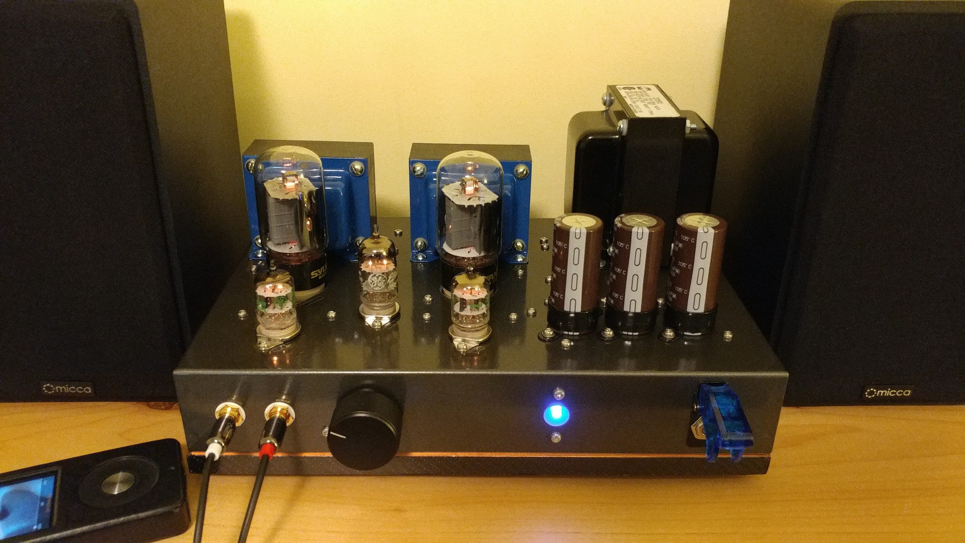

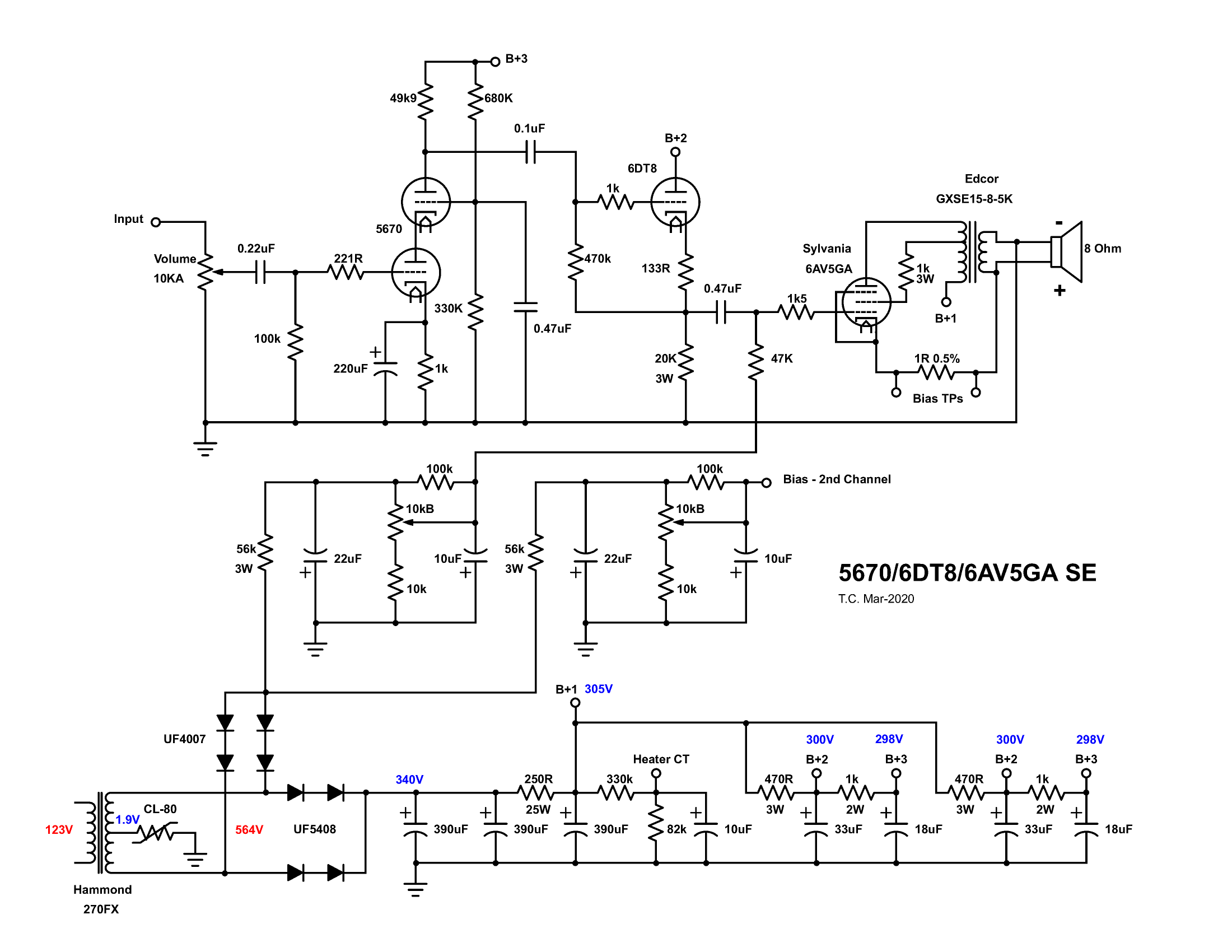

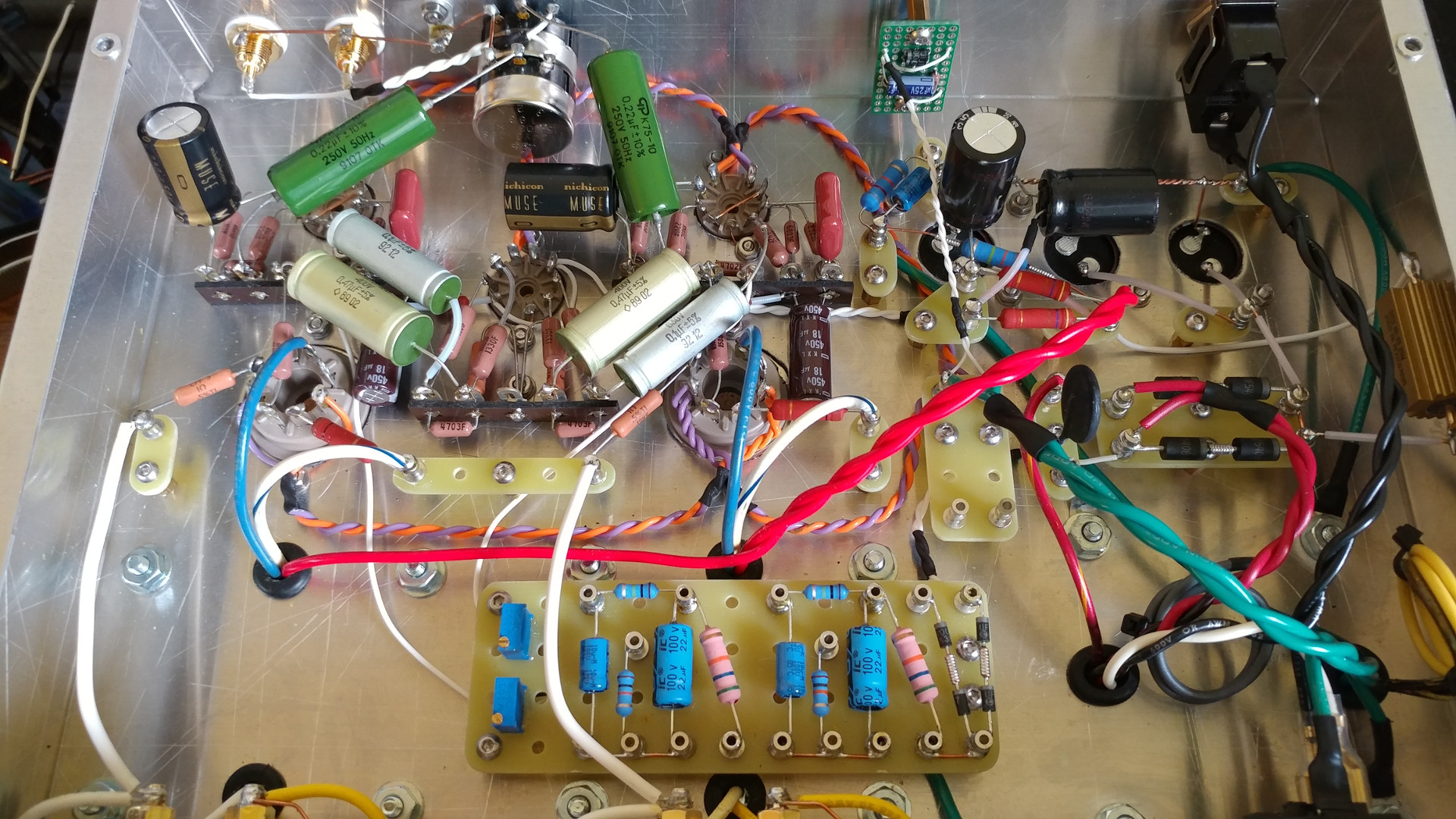

This is my second go around with a hi-fi-ish amplifier. The first one was one year ago, a simple 6SN7/6V6. I got a lot of excellent feedback from the forum, and I eventually converted it to an unbypassed 6SL7 with global feedback. Unfortunately, when my kid went off to school last fall, he fast-talked me out of it with the argument that I can build another one. I finished this amp about a month ago, and had been tweaking it. Much credit to @Tubelab_com, as the output section is directly cribbed from his website. I only have a rudimentary o-scope so I can't provide any advanced measurement numbers, but it sounds really good to my ears. I think I'm finally done, and would welcome any comments and criticisms.

I got tired of waiting for a pair of OTs from Edcor, so it's time to rip into an existing amp. I made a pair of socket adaptors to go from 6JC5 to 6AV5. I had to up the dropping resistor in the bias circuit to 100k to be able to bias the 6JC5 (56 mA). I could have just jumped the 10k resistor on the trimmer, but that would have pushed the power dissipation across the trimmer too close to the limit. I put in a parallel 100k resistor on a switch so I can go back to 6AV5 without too much hassle. (I tried a 75k resistor, but I could not get either tube to their proper bias.)

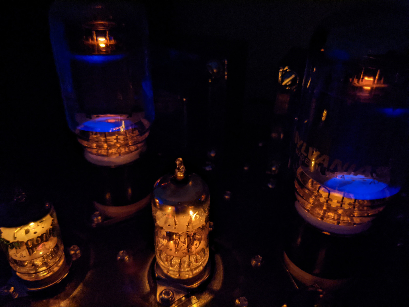

The 6JC5 is really surprising. The bass is noticeably fuller than the 6AV5, otherwise just as dynamic. It also has a nice blue glow.

6FW5 will fit the same socket as the 6AV5. No wiring changes.
175 mA DC rating versus 110 mA rating for the 6AV5. And 18 Watt rating versus 11 Watt.
The 6FW5 will give the lowest output Z in triode at the plate also:
6FW5 Ri 560 Ohm
6AV5 Ri 820 Ohm
6JC5 Ri 1700 Ohm
6JC5 will only do 75 mA DC.

I have a nice stash of 6FW5s too. That's a beefy tube. The Sylvania 6AV5GA, at least physically, look exactly like the GE 6FW5. I ran them very conservatively. 300 V at the plate, 60 mA.
The 6AV5, when triode wired, closely resembles the 6B4G DHT. Sylvania did that trioding (internally) to fulfill a military contract. Overall, the triode wired sweep tube might not be as "sweet" as a genuine DHT, but hum will not bite your bottom.
I remember encountering these 6AV5s with the screen hardwired to plate. I guess that means its safe to not use a 100 ohm screen grid suppression resistor if Sylvania just shorted the pins internally.... Still, my experience with triode wired beam tubes is that the screen grid resistor prevents oscillation.
