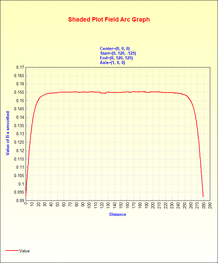

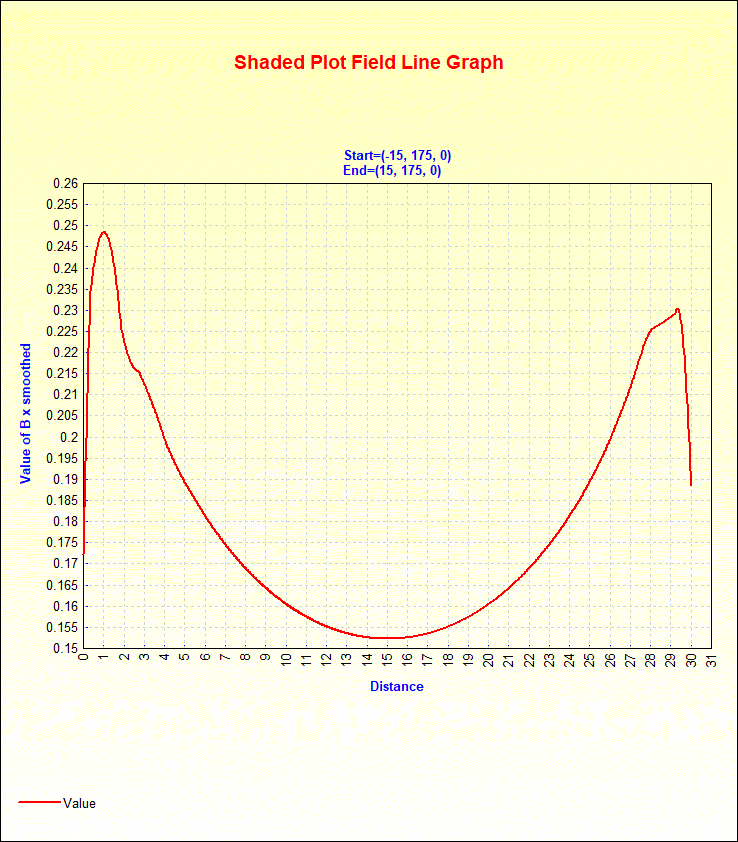

And I obtained the graphs of the magnetic field on a longitudinal central line and a transverse central line
Bx longitud
Bx transv
The value of the field is low, but still a little higher than in the ribbons built previously.

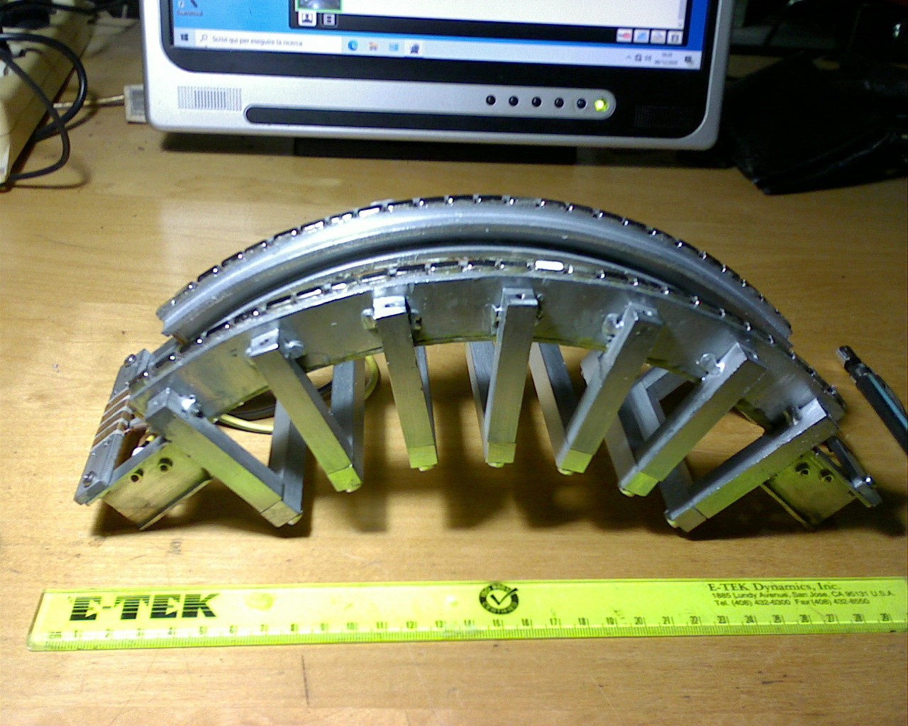

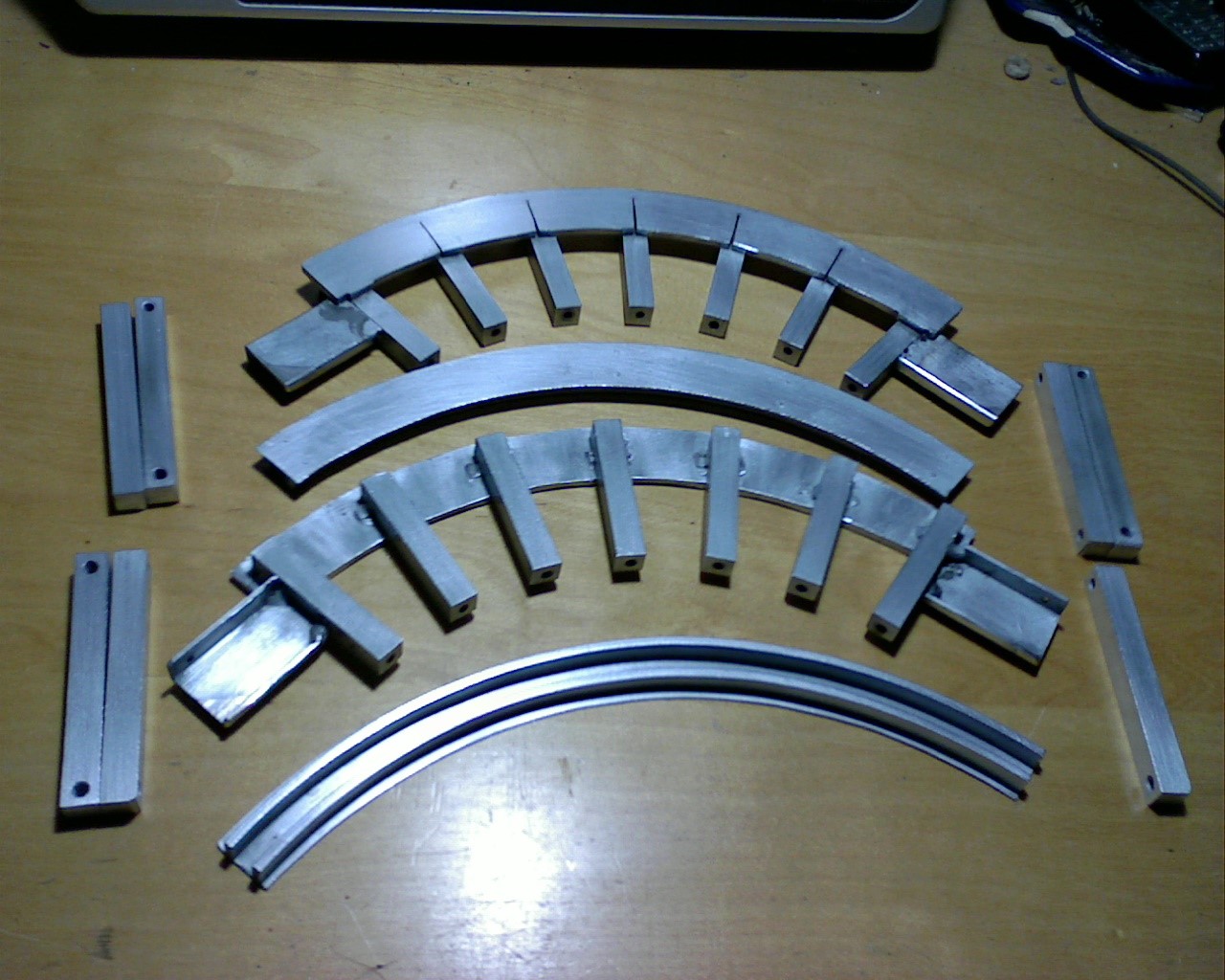

So, having bought the iron, I put my hand to the miter saw and the arc welder and I built the polar expansions and the magnetic field closures. After flattening the contact surfaces to the magnets, I galvanized everything to avoid corrosion problems.
iron elements

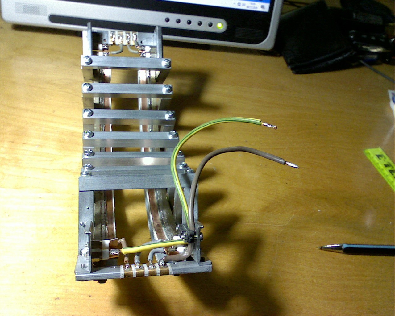

I made the return conductors with 0.4 x 6 mm copper strips and glued them with epoxy under the paper-insulated pole pieces.

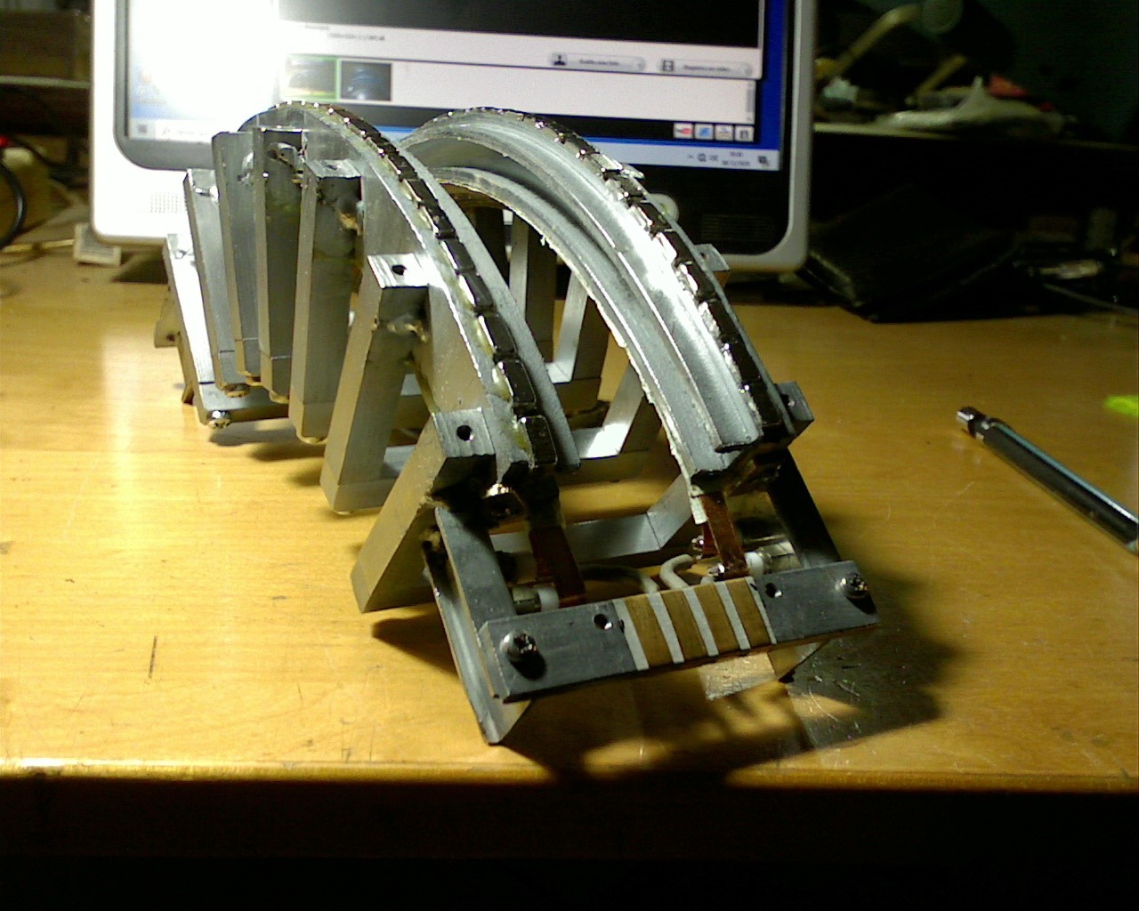

After having assembled everything with neodymium magnets grade 38, dimensions 5 x 10 x 25 and having put the copper contacts, previously gilded, here is the result:
engine
engine 1
motor 2

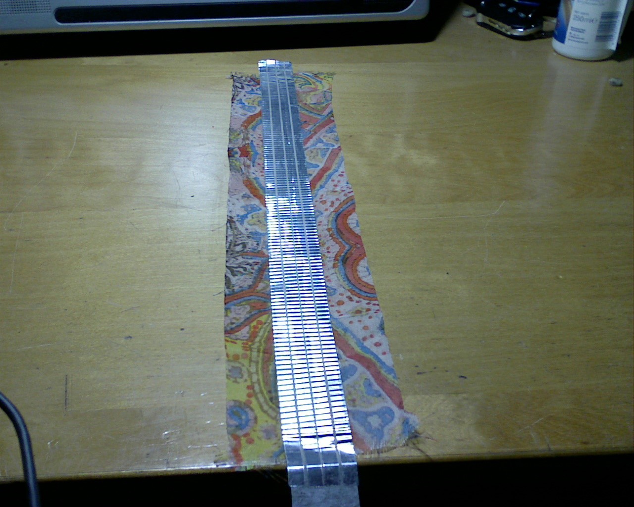

Now I am building the ribbon, 27 mm wide, of 36 um thick aluminum, divided into 4 strips 6 mm wide each, supported by 12 g / m2 model aircraft paper glued with very diluted bostik. On the sides of the ribbon I glued 2 strips of fabric, 30 g / m2 chiffon, for the side suspensions, 3 cm wide to be trimmed later. This chiffon is made of polyester and therefore thermoformable. Up to this point the construction is the same as for a straight ribbon
Rib phase1_v

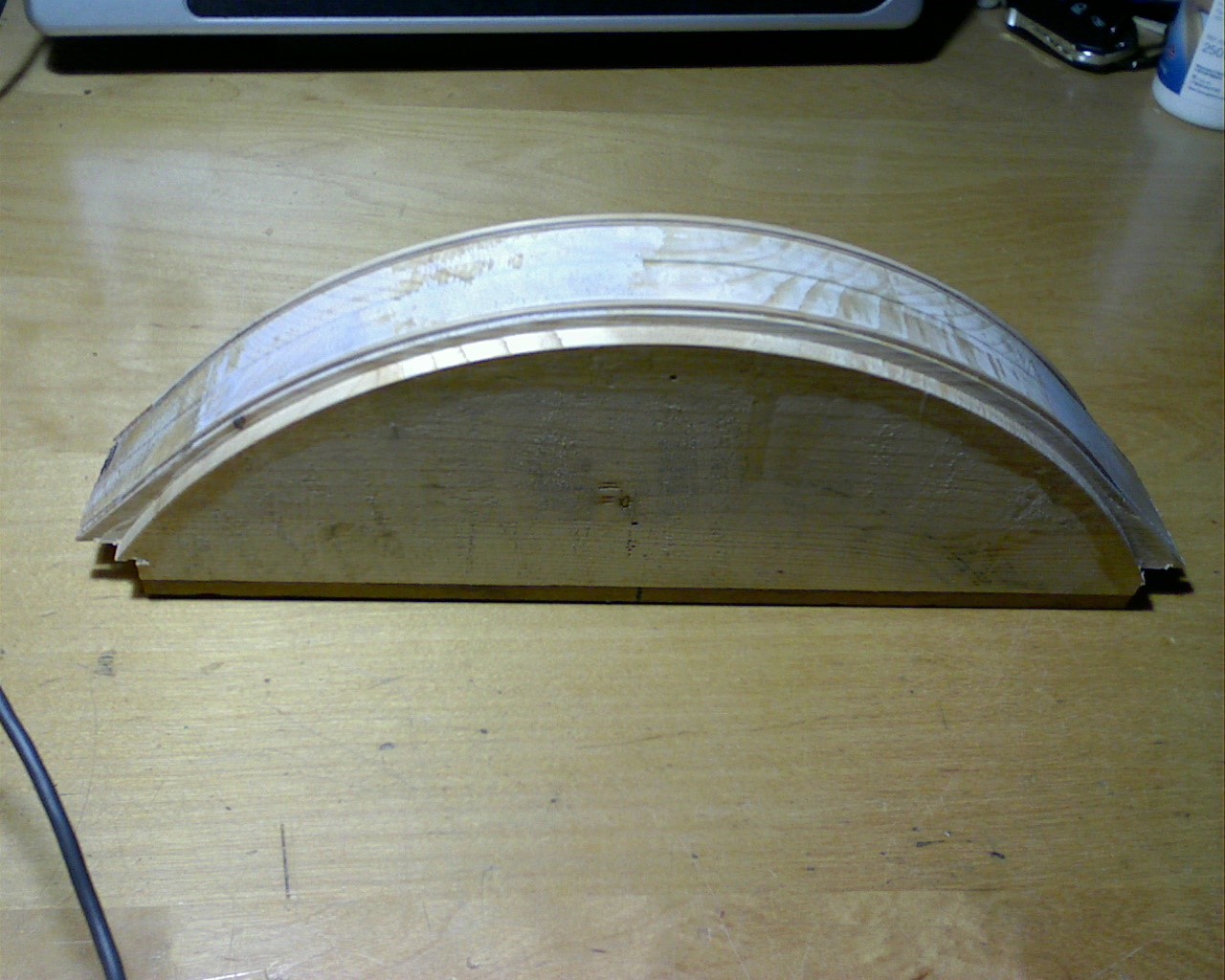

I corrugated the tape to give it longitudinal elasticity, as I want it to behave like a pulsating cylinder and not like a rocking cylinder.
I built a wooden form to lay the tape on it, with the same curvature of the pole pieces and with the desired profile for the corrugations of the side suspensions
Shape_h
iron elements
engine
engine 1
motor 2
Shape_h

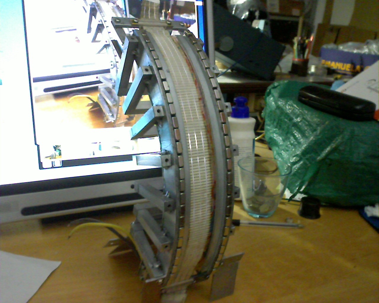

So I laid the ribbon over the form and used copper wires to force the fabric to follow its profile. I heated the fabric with the heat gun, then attached the Velcro hook strip to the outermost part of the fabric. Since the adhesion was not good as the fabric released lint, I first had to impregnate the fabric with liquid bostik (only in the part that had to adhere to the velcro), and then the velcro adhered well. Having freed the ribbon from the shape, I moved on to the chemical section to nickel the aluminum where it had to make contact. And here I realized the mistake, because I had to do it first of all. In fact, by handling the tape to put it in the baths, the corrugation is damaged and the shape of the side suspensions has also lost precision. This was an unexpected mistake, however I patiently remedied it, revising the corrugation and redoing the side suspensions. Here is the assembled ribbon
Ribb on
Ribb on

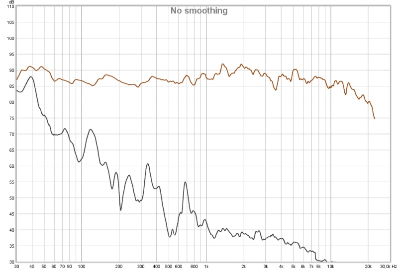

I am not satisfied with how it turned out, because the curvature is irregular, the ribbon is not exactly in the center of the magnetic field and furthermore the corrugations of the lateral suspensions are too deep for the +/- 4 mm of expected displacement.. However, before doing another I want to do some measurements.
This is with 0.2W and calibrated umik placed 6cm from the ribbon
SPL C0
The SPL graph is not bad, considering that the driver was resting on the table without any tricks, but the distortion starts to rise below 800 Hz, while I expected that it would be acceptable from 200 Hz and up. Maybe it is due to the construction defects that I found, but I will only know if I can make a precise ribbon. I calculated that the SPL at 1W, 1m should be around 80dB which is absolutely low, but still good for my purposes.
I also did listening tests, in comparison with my long ribbons, with music and singing without low frequency content (so as not to stress the ribbon), and I found confirmation that the directivity in the vertical plane it's not good for the presence effect, at least in the conditions of my room. .
