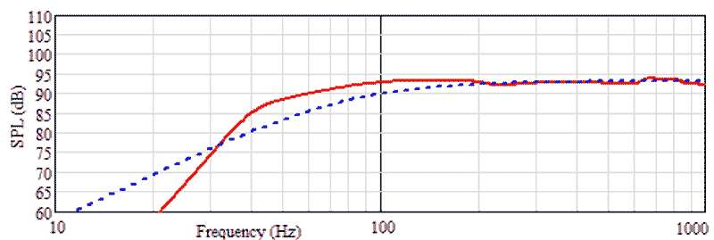

Example is a MLTL I'm currently testing (an experiment) where the drivers Fs/Qts ratio is 86, Fs is 40 (run in, 41.5 static) and the Qts is ~0.49 and a Vas of 29.5 liters
Another example.
Fs/Qts ratio is 172, Fs is 91 and the Qts is 0.53 and a Vas of 2.3 liters.
With room-gain, in a Woden designed ML-TL into the high 30s, low 40s. Anechoic sim attached. I am very pleased with the performance of these little 4" Peerless.
Another example.
To evaluate a woofer, i don't pay attention tothe numbers, but look at the sims... i have been surprised more than once.
dave
It is quite surprising, astonishing at times, roving through a zillion sims of potential candidates. It's that, now wipe that grin of your face and cut some wood already, kind of feeling 🙂
