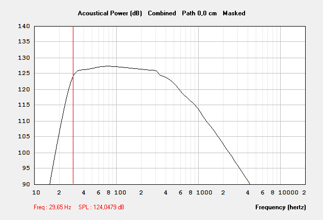

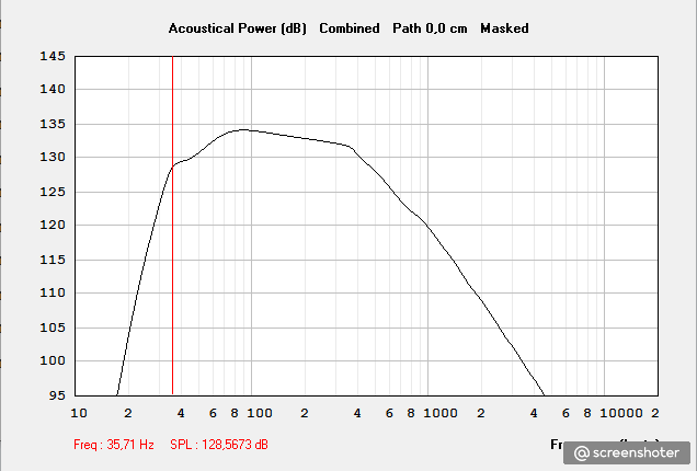

I've modelled a couple of drivers, namely Faital 15PR400 and Beyma 18LX60V2.
For those two drivers venting is not enough, i need to apply a boost of 4-6db in order to extend low end to 35Hz.
Here is how this driver maxes out with 6db boost applied at 35Hz and xmax at 9mm in 0.5Pi configuration at 250W into 8Ohms:
949505d1620370750-corner-sub-midbass-synergies-beyma-18-png
And here is Faital 15PR400 in the same kind of enclosure (90 liters) and about the same boost maxed out with 6mm xmax:
949506d1620370750-corner-sub-midbass-synergies-faital-15pr-png
- Do you think any of these two drivers will fit the bill?
- Am i going to have problems with room modes due to subs being located in the corners (an audiophile dogma?)?
- Any problems integrating with hanging synergy speakers at about 120Hz?

And then there is Beyma SM-115 N, which, in a vented enclosure, can produce this kind of SPLs (0.5Pi radiation) with its almost 15mm xmax:
attachment.php
This driver i can get the cheapest.

The two drivers you have selected have less xmax than I would look for in a sub driver, I'm guessing your based in EU from your choices and are looking for a relatively low cost driver. I would look at something like the B&C 15TBX100 or 18TBX100. Beware that Faital pro uses a different xmax formula to other manufacturers thats more optimistic.
If you don't need the maximum output of the 18" subs then I would tune them lower than 35 Hz and EQ them flat. Just beware the pipe mode of very long ports.
No, i am only looking at what's possible at about 30-35Hz at maximum xmax/power. Beyma's 18" is 4dBs louder than an 15" driver at this frequency (124 vs 128dB). I think that will be more than plenty for me. Hopefully, corner loading will lower FM distortion.

I doubt you will use the full output of 2*18" drivers most domestic rooms develop annoying buzzes and rattles if you get anywhere near 128dB.

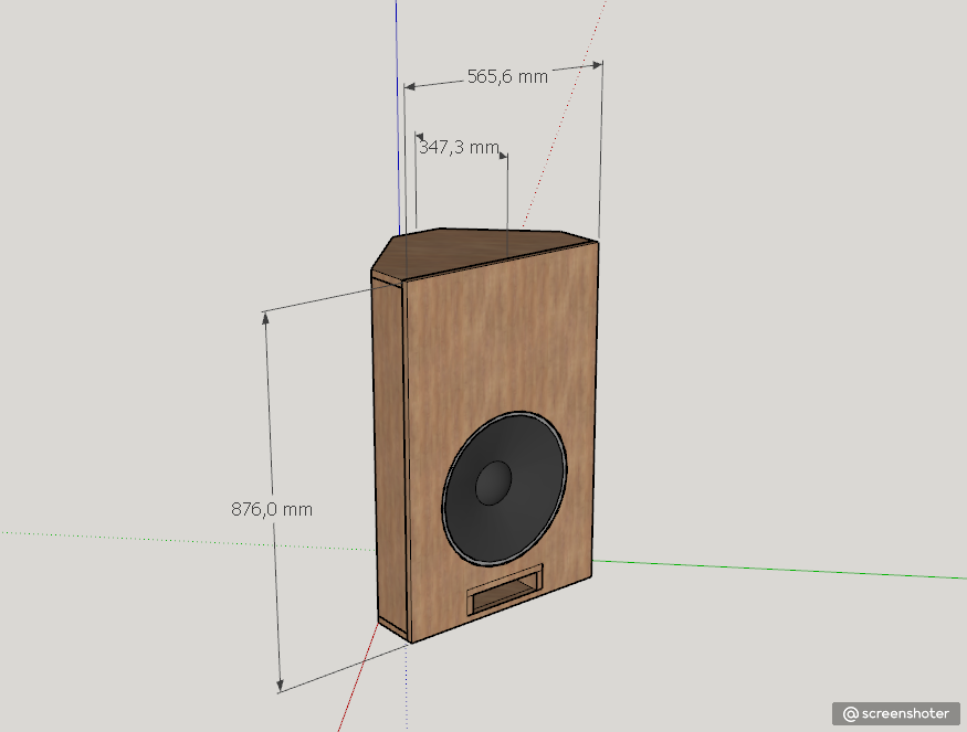

My experience has been, the port being close like that will effectively lengthen it.
And probably should add, rectangular ports have measured longer / tune lower, than the sims predicted (for the same round-port area).
yep the port will be tuned lower than expected. Also as there is no flare on your port you will have to keep port air velocity lower than a flared port to avoid port losses and and noises.
Any rule on how far from the wall should vent be located? Does bending a port sound like a good solution?
Yeah, i aim for no more than 17m/s or air velocity at maximum SPL.

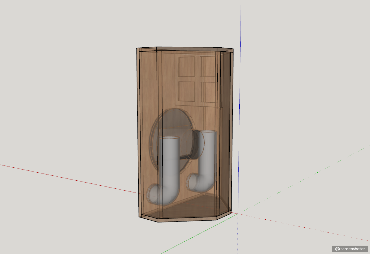

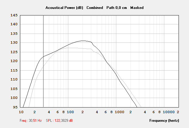

Well, let's use pipes then:
attachment.php
WinISD and Hornresp give slightly different resonant frequencies for two tubes 100mm dia and 400mm length. WinISD estimates at tuning at ~30Hz while Hornresp at ~27.
About 75W may be fed into the driver before it reaches XMax with 9db boost applied at 30Hz Q=1,2 (eights space sim):
attachment.php
Whats the air velocity for this port? you can see this in Hornresp by selecting just the port output and then the option to see the particle velocity at input and output of the port becomes available.
If you build the first sub with a panel screwed down before you glue you can adjust the length of your pipe ports to get exactly the tuning you want.

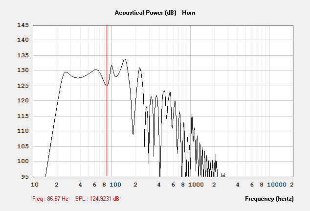

Found another driver (although, used) - 18Sound 15LW1401. I use this driver in an open baffle setup already.
This is how it compares with Beyma SM115 in an 8th space:
attachment.php
Although it has higher resonant frequency (42Hz vs 35Hz), it has higher xmax. Some other parameters might be at play as well, since response is not falling as dramatically as with Beyma.
Hm. Another idea is to use 15LW1401 in a THAM-like box. Here is a quick sim in Hornresp:
attachment.php
Goes a bit lower - to 25Hz. But has a dip at 86Hz and some ripple up to 150Hz.
Will it be possible to cross with mains at about 120Hz? Or should i stick to a vented box plan?
