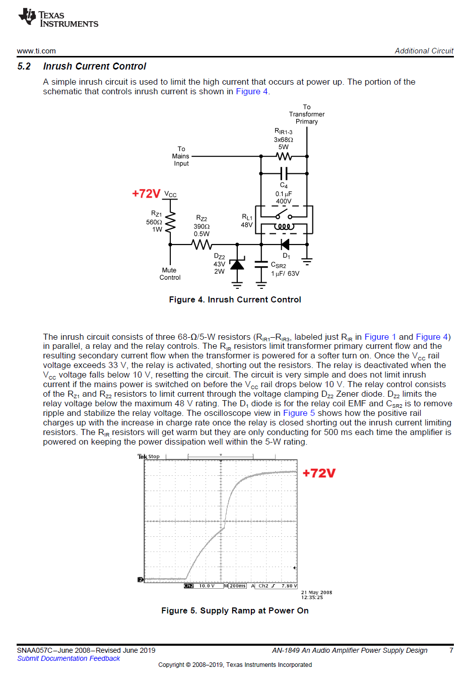

Here's the inrush current limiter circuit ("soft start") from Texas Instruments app note snaa057c . It has three 5 watt resistors in parallel, limiting current to the transformer primary. When the rectified and filtered DC supply named "Vcc" reaches a certain voltage threshold, the relay coil pulls-in and shorts out these resistors; they are "bypassed" and current limiting ends. Notice how few parts they use for inrush limiting.

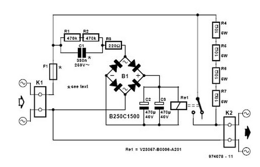

I had above circuit built and connected to a 1KVA transformer years ago. It starts softly just fine. But sometimes if I made mistake, power was turned off and tuned on again within a few seconds, it will blow fuse. This is due to C2//C3 do not discharge quickly, the relay still conducts for a few seconds when powered off.

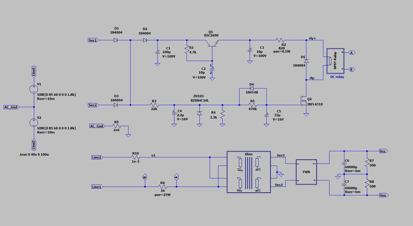

Try this circuit out. It features asymmetric turn-on and turn-off times, the former being approx 16 seconds, and the latter being ~40 ms. If power is removed, even temporarily, the circuit will still generate a 16 second turn-on delay. Component values are not critical, with 5% resistors and 10% capacitors being OK. It does require access to the transformer secondary, and the relay coil voltage should be slightly less that the rail voltage. R2 is selected to drop the voltage to the desired relay coil voltage. The circuit shown utilizes an FWB across the transformer split secondary; however, the circuit will also work with a single-ended rail
