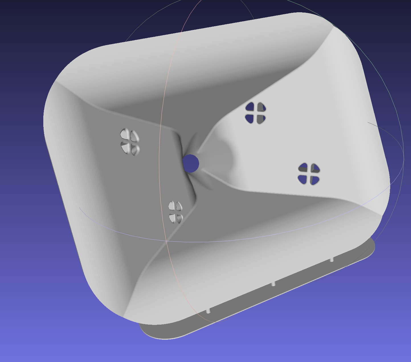

Here's a big ol' waveguide that I made about four years ago. About 20" wide by 8" tall.
I could swear I posted measurements of this on diyaudio somewhere, but I'm having a hard time finding them. If anyone stumbles across them, please post the link.
The waveguide is assembled in three pieces.
The waveguide in the picture didn't turn out so hot, and I had to "weld" it together using a soldering iron and patch it using mortite. But that was because I was printing PETG for one of the first times, and didn't have my 3D printer sorted out.
I think I have the 3D file for the woofer enclosure, I'll post that if I find it.
There's one little issue - I'm not 100% sure what woofer was used on this project.
If you are going to print it, you may want to load the STL into Fusion or whatever you like, slice off the woofer mounting plate and add a new one.
If memory serves, I used a BMS 4552 on this horn, so if your compression driver has the same bolt pattern you should be fine. I believe I also measured it with a Celestion compression driver.
The woofer may have been this: W4-1320SIF - 4" Paper Full Range - TB SPEAKER CO., LTD.
But I'm not 100% sure.
When I say "the waveguide didn't turn out so hot", I mean the print quality.
I can't find the measurements so I'm not 100% sure how it performs.

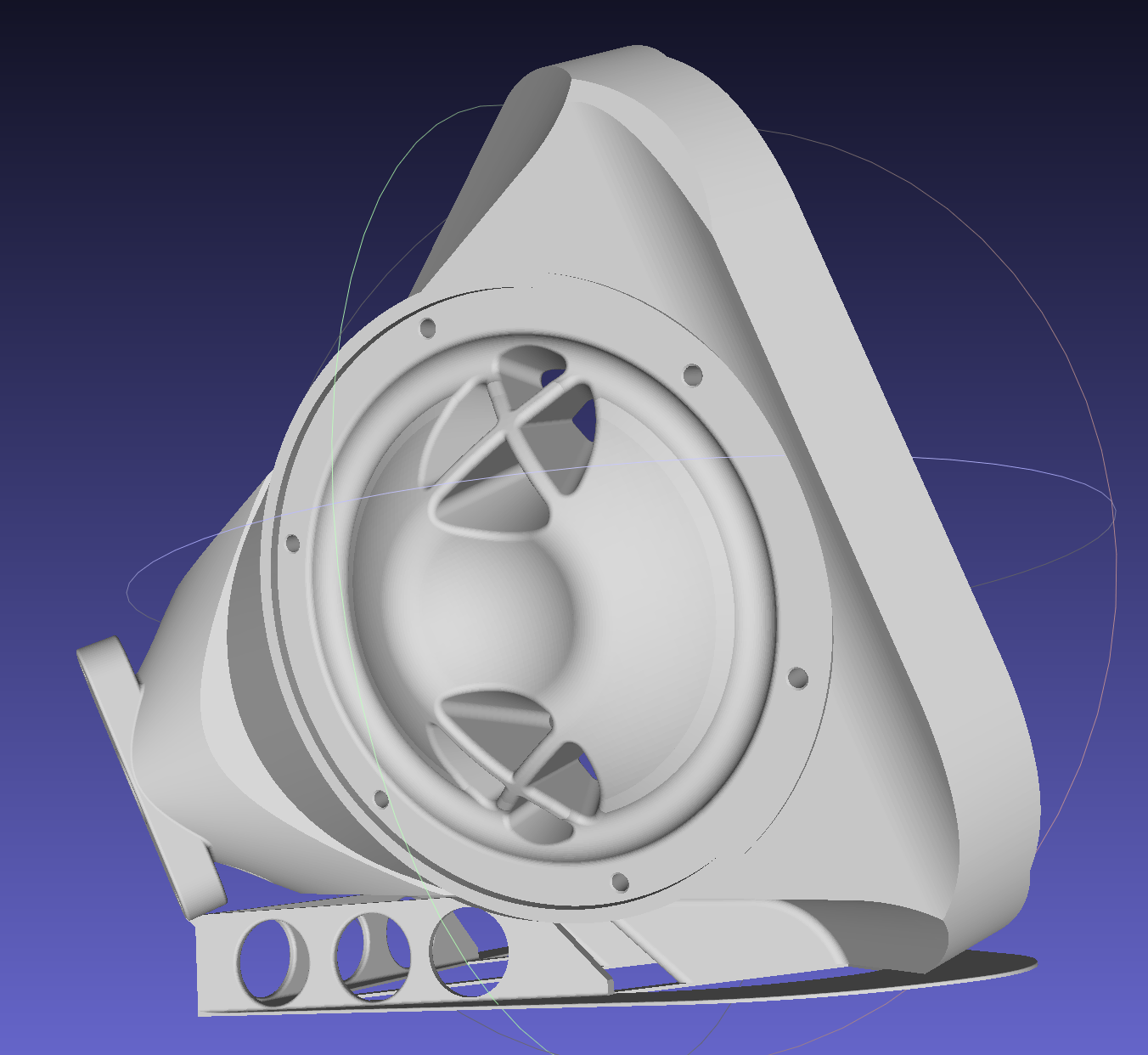

Here's a two-way Unity horn from late 2017. I don't think I ever posted anything about this one. It appears to use the Aurasound Whisper, available here:
Aurasound NSW2-326-8AT 2" Full Range
I am especially proud of this project!
