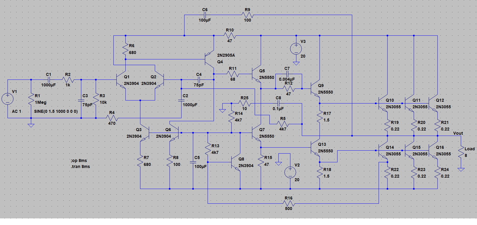

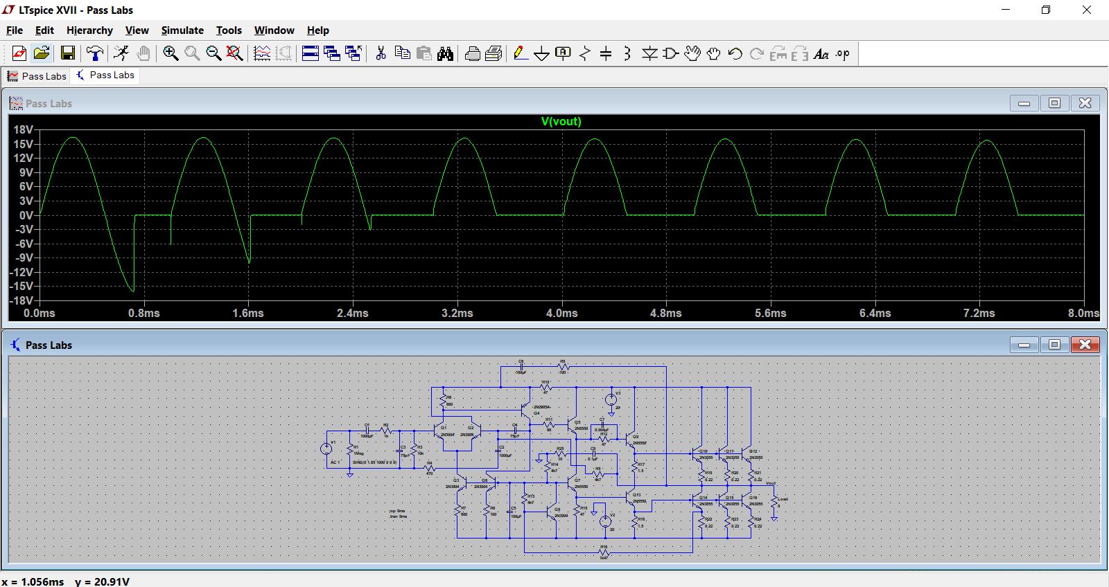

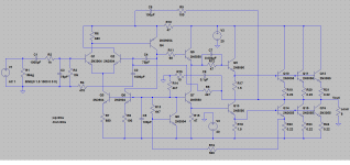

Hi, I've been trying to find a good transistor set, for old Pass's design, http://www.firstwatt.com/pdf/art_classa_20.pdf.
And I've gotten somewhere with it in my simulation but it seems that my configuration is either doesn't have proper substitute transistors, there could be a design flaw or unreliable simulation setting.
I could use some help getting further with the design but I'm stuck figuring out where to go next.
MPSL01 = 2N5550
RCA1A16, RCA1A15 = MJE15030G, MJE15031G
2N5877 = 2N6341G

I suppose its just a preference, what you have got used to using really. I'm afraid I've never used Multisim but perhaps someone who has can help out. The basic circuit doesn't look as though it should be critical on semiconductor models.
What is it doing, not doing?
The plan is straightforward. For simulation, the exact transistors are probably not critical. It sure should come to a DC solution even if the huge POWER transistors are faked with tiny 2N2222. (My sim does not complain when I put 50 Watts in a quarter-Watt part...)

Bob Cordells excellent book 'Designing Audio Power Amplifiers' has several chapters devoted to LTSpice and there is a detailed description on creating basic spice models.
This (attached) list of Bobs own models will cover 95% of generic audio circuits such as yours. The MJL21194/3C complementary pair seem suitable candidates.
Also search for Ian Hegglun's excellent lateral FET models.

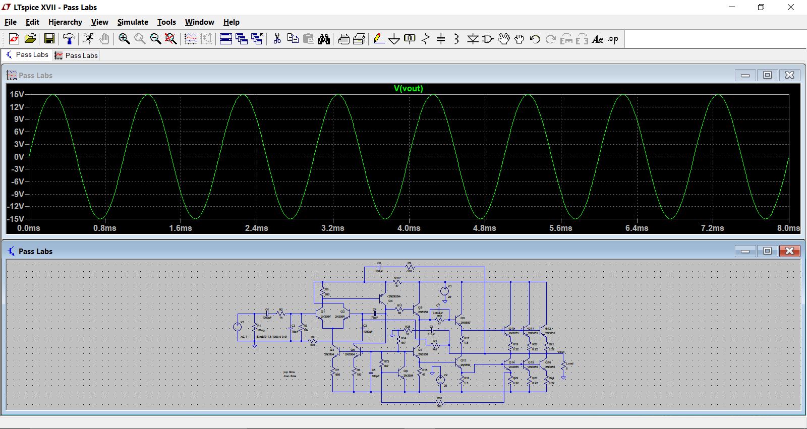

Well, technically doing fine and dandy but after Q5 the signal is incoherent mess.
I've been trying using
Q4 is a MJE15031G and Q5,6,7 MJE15030G.
If these don't lead me forward I'm checking next
D44H11 / D45H11.
So I'm not stuck on getting the signal to pass from the OPamp to end-stage to be finally amped up.
I'm guessing it should work on 14... I'll try it. I just made an educated guess without reading Nelsons work.

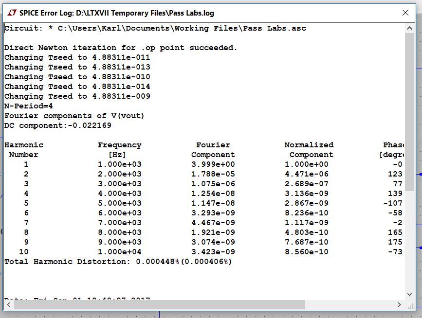

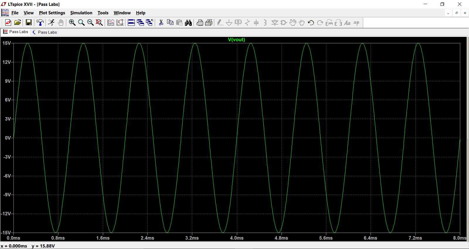

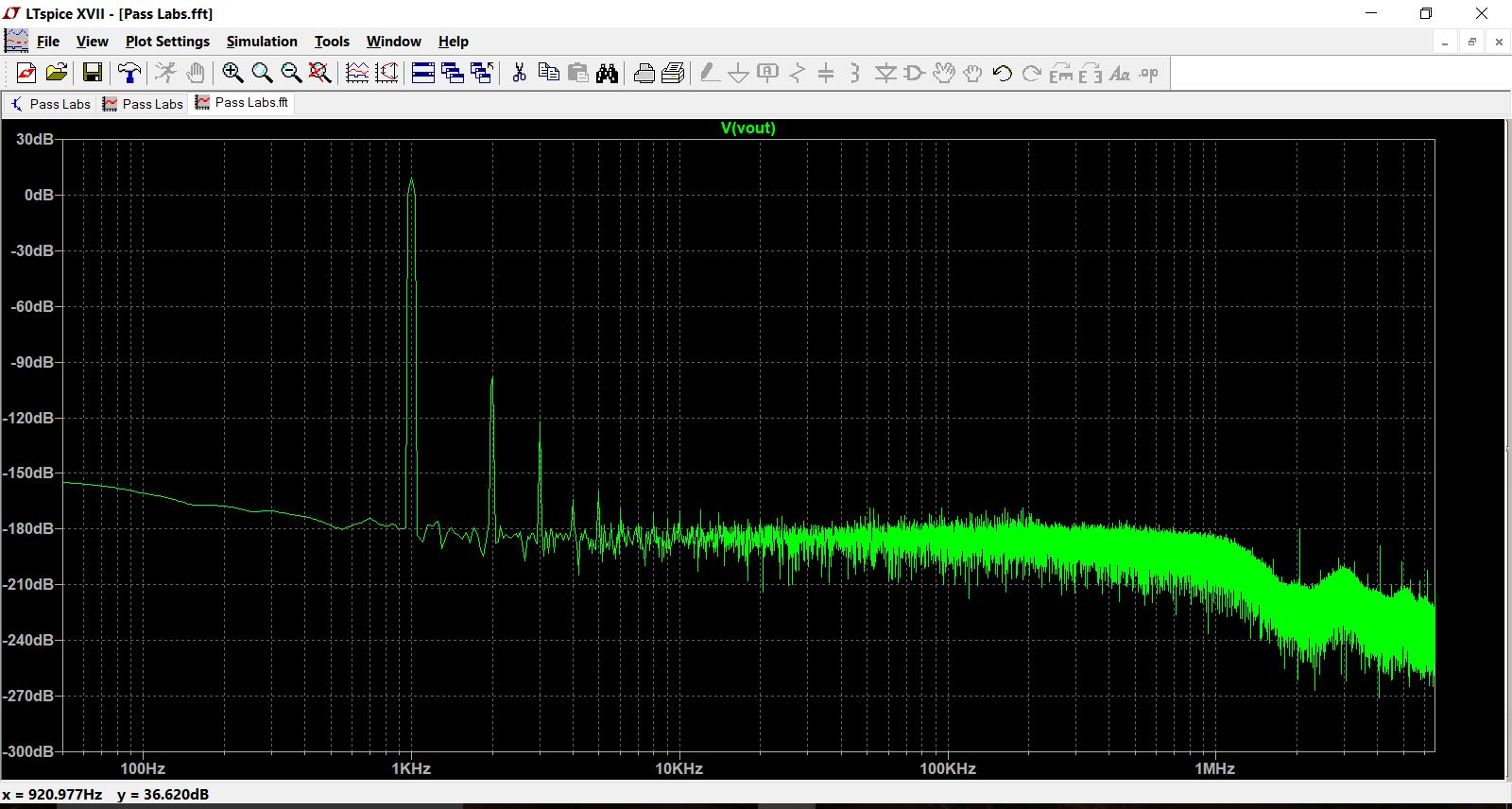

Its fine 🙂 May as well show some of the other gory details 😉 FFT and distortion at 2.83vrms output (1W/8ohm)

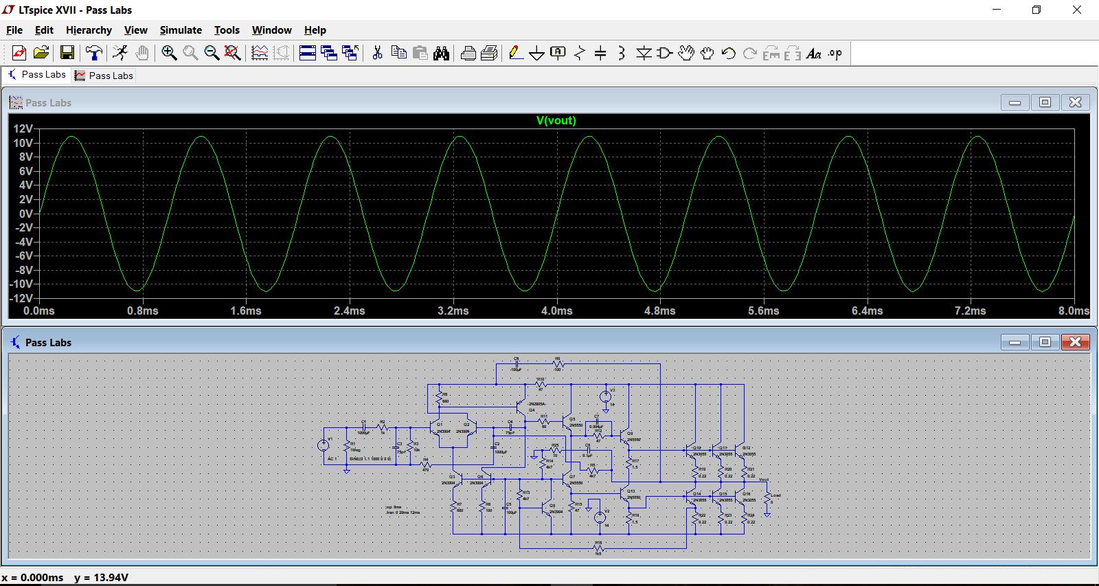

I'm just reading Nelsons write up on this and that shows a 14-0-14 volt transformer which would actually give around -/+20 volts dc if we ran it at near to its continuous VA output rating.
I've set the preset as per the instruction and that gives a current of just over 800ma in each output pair. Driver current is nearly 500ma giving around 10 watts dissipation in the little drivers :rofl: but hey, this is LTspice with the indestructible transistors.
This is where using more suitable (hi beta) devices for drivers and outputs would pay dividends.
Also the bias preset is incredible critical in simulation. This shows the result of going from 1k45 to 1k47. I wonder if the real build is as critical and behaves like this ?
