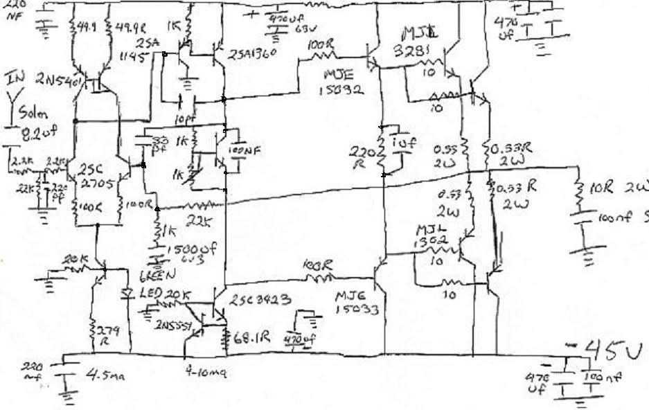

Hi vynuhl.addict,
That is a similar topolgy to Douglas Self's 'Blameless', but it does not follow Self's closed NFB loop stabilisation strategy.
Your circuit does not have the single 100pF Miller connected C.dom which so slows VAS control of the output devices when driving real world loudspeakers.

vynuhl.addict,
As pointed out correctly by Graham, the Vas transistor needs protection - you could take the cue from D.Self's many circuits.
Taking the cue from Self a little further, why not use bootstrapping for the input like he did with his Load Invariant Amplifier?
Your schematic does not show the transistor types for the Current Source and Vbe positions. The input stage decoupling resistor value is also not shown. (Can the same resistor not be replicated in the negative rail as well?)
The 20K resistors to ground from the current sources on the negative rail can be split into 10K+10K and the junction can be decoupled with caps.

Graham, overcurrent potection such as a 10ohm resistor between emitter of vas and rail?. I took a hint in one of Hugh Deans posts to try out bare minimal lag, and secure with lead comp, needless to say this made a difference that was no less than stunning in sound quality differences, gone was that well documented solid state hardness. Even when I built the oiriginal blameless i used a 47pf cap instead of 100.
Carlos, you points on the original blameless are very valid, It is clean, very clean but unable to allow long listening without breaks.
The input stage decoupling resistor is 10ohms 1/4 watt. The VBE bjt in 2sd600k Sanyo, current source bjt are 2n5551 nos motorola. my goal was still aimed at simplicity while constructing, and in dougs designs he only decoupled one half with a resistor also but i am not sure of his reasoning. The original reason i did this was because i saw it done in the trimodal .. I suppose it could be replicated in the other rail but as far as tweaks go with this amp it sounds very finished. It is currently being run from a dual mono supply but using one 300va transformer and 24000uf per amplifier. The Rails sag very little at high levels(not ear bleeding), less than a volt +/- 500mv or less variation.

Hi vynuhl.addict,
I would suggest half the value used in the opposite sink, which comes out closest to 33R, and use the voltage dropped across this to drive a current limit with emitter to rail and collector to the base of the 2SA1145. Use a very low capacitance PNP small signal transistor for this.

It is an amplifier, with a gain of 23 or 27db.
Another question for Graham, for the the overcurrent bjt the smallest capacitance bjt i have on hand is 2sa1145 with a 50ma rating, would this suffice??. I want to use something that will have no detrimental effects on sonics at this point ..I originally blew a a1360 when first built after accidently shorting the vbe multiplier to the heatsink and subsequently ground (due to a very small shard of aluminum after drilling the heatsink), you are right in the respect of it will take it out instantly, but the output stage is very robust with mje15032/33 and mjl3281/1302..
Colin
Colin
2SA1145 with a 50ma rating is fine.
All this transistor needs to do is sink the differential tail current.
Cheers ...... Graham.

Hi vynuhl.addict
I agree with your objectives but wonder whether the circuit you posted really works as it says.
First point I'd make is that the 10 pF is a lot smaller than Self's 100pF -as Graham already said. This puts the "Miller" effect ten times higher in frequency (i.e. less effect on audio) than in the blameless.
Second point does it oscillate? Simulations using BD139/140 VAS, drivers says it does. Not badly (just a little, so maybe not noticed) Perhaps your 33pF can be made smaller....maybe only needs to be 15 pF with MJL3281 etc.
Maybe the circuit is OK with the transistors you specify. I have not got models for those, but BD139/140 seem representative of many HF transistor types (ft ~100 MHz). If the VAS is slower, maybe already slows down the VAS without Miller capacitor ?
