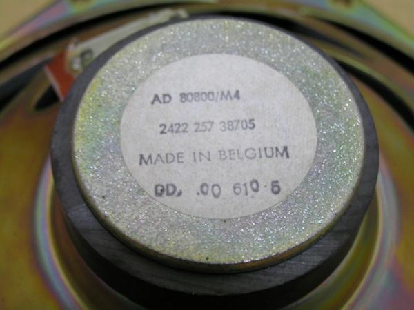

The official spec sheet (T/S parameters not included) is published athclisen said:Philips AD 80800/M4
http://www.audiodiskussion.de/foren/fullrange/msg.php?idx=12277
The diagram shows SPL and nonlinear distortion. This is a run-of-the-mill-fullranger, nothing special. Someone in the thread above recommends 5-7 l closed as enclosure - though without much bass. Sensibility is 93 dB.

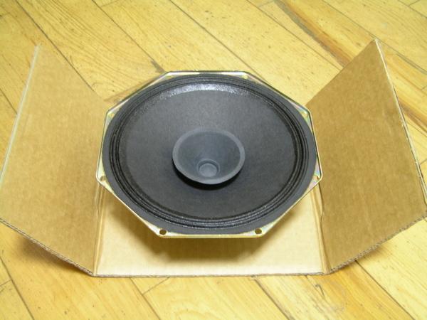

I have a pair of this stuff laying a round, I've not known how to build the box for them. Anyone suggest me please.

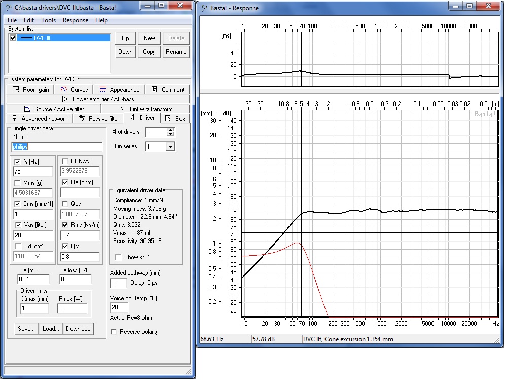

open baffle midrange - This is the measured response of the actual drivers i have on an open baffle.
i should explain, the thiele small params are measured, the simulation is just that a simulation in reality i would cross them to woofers around 150hz or so. The wizzer cone gives extension out to about 18khz but its nasty personally i would cross them to at about 2khz if you can as this is where the whizzer kicks in giving major hf boost about 6db or more above the midrange level. Hook them up to an amp and listen to them with a frequency sweep you will hear a sudden rise in db level around 2k or so.
