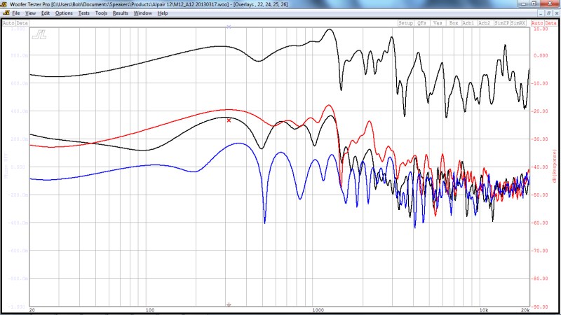

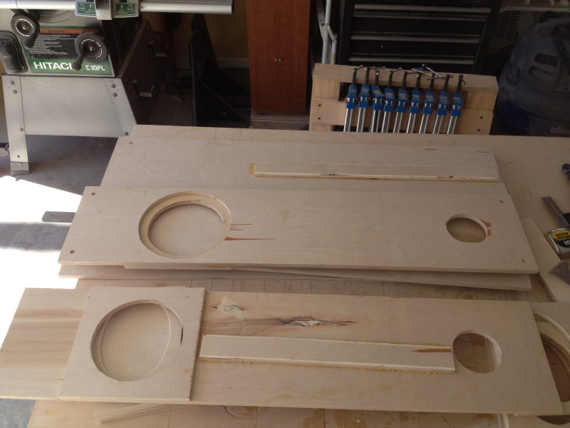

I have never been a fan of extreme bracing schemes. I understand the logic of tying all of the panels together with cross bracing, but I have always wondered if the result makes an audible difference. I also have a problem with obtaining decent sheet goods out here in the hinterlands.
Second issue first. I can get decent ¾” cabinet grade plywood. 5-ply with decent birch/oak/maple veneer. What I would like to get is real Finnish 13-ply 18mm plywood, but it simply isn’t available to me in small quantities. A skid? Yes. Half a dozen sheets? No. What is available is “TigerPly”. 11-ply kiri core with a microscopically thin birch veneer. The veneer chips and tears with any machining. See pictures below. My other option is 12mm Russian birch in 5’x5’ panels. This stuff is pretty good and I have used it successfully in smaller projects.

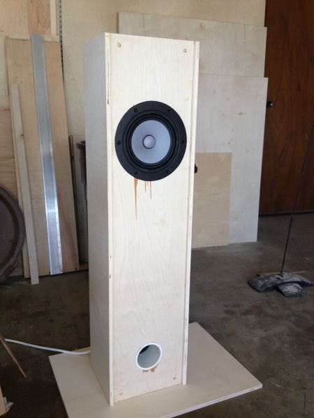

This leads to the first issue. Can I build a fairly large cabinet out of the 12mm Russian birch without suffering unacceptable panel vibrations? I designed a MLTL for the Alpair 12P and here is the build story. I used 12mm “TigerPly” because I had a couple of sheets in the shop. I have a brace above and below the driver, 2”x12mm stiffeners from the second brace to the bottom of the cabinet, a doubler behind the driver, and the top panel is doubled (24mm). It is a happy circumstance that the driver rabbet is 12mm, so rather than glue up a double panel and route out the rabbet, I just cut the appropriate holes and glued the doubler behind the baffle. I lined the entire cabinet with 5/8” fiberglass and screwed on the fourth side. The cabinet, by the way, is 9”x7”x40” i.d.
The driver only have ~20 hours on them, so “how does it sound?” is not yet an issue. I did want to know what kind of noise was passing through the sides of the box. I made and RTA of the driver close mic’d and used a 5.5ms gate. Then I made RTA’s positioned ¼” from the side at the driver level and the back both at the driver level and half way between the second brace and the bottom of the cabinet. Note that I did not change the amp volume between measurements. I did scale all of the plots by the same number so that the driver plot would be somewhere near 0dB. Build pictures and the RTA’s attached.
Enjoy.
Bob
( Upper black=driver Lower black=back Blue=lower back Red=side)

Fig 12 is really the key for the BBC paper. It claim that above 400 Hz resonances has to be supressed by 30 dB to be below audiability threshold. Below 400 Hz less is needed, by about 9 dB per octave. So thining the walls will bring down the resonances below 400 Hz.

The BBC research into this issue is worth looking at, although their approach was the opposite of a stiff cabinet. However they found that the difference between 9mm and 18mm wall cabinets at certain frequencies was negligible.
