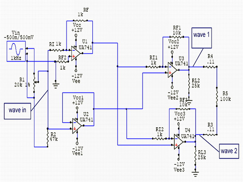

I will post some graphics of signal to observe phase and levels....those signals have title and are referenced in his first post.
Input is called wave, inverted and non inverted is called wave 1 and wave 2

so what is this for? single ended to balenced output? RI, RI1, RI2, and RF seem small. a biasing resistor is in place for U1, but not U2. are U3 and U4 needed?
- Chip Amps
- A bridge circuit, made by our forum friend Rodolfo, from Tamaulipas.
