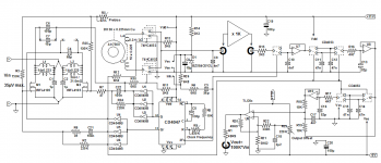

After a number of iterations and tentatives, I ended up with this circuit:
It is far from perfect, but it works and would even be usable if properly cased, connectorized and supplied.
The components are completely ordinary and non-critical: mylar and X7R caps, commodity ICs, and the transformer is built from home-made twisted wire and a bog-standard, suppression-grade ferrite core.

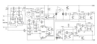

The beating heart of the circuit is its master clock oscillator, based on a CD4047.
Why the 4047?
It is easily available, cheap, and does the job perfectly well, since the clock doesn't need to be particularly stable or jitter-free.
In addition, it has low skew, complementary outputs and also a 2*Fo output which comes handy in this circuit.
As I didn't know what frequency I was going to adopt, I made it variable from 3 to 60kHz.
The main outputs are buffered by 3 CD4049 each, more to be able to face all possible situations than to meet a specific need.
The outputs drive the modulator MOSfets through 1.5K resistors.
Their role is two-fold: they slow the signal edges thanks to the gate capacitance, and combined with the two 4.7K resistors, they shift the level so that the low level is just under the threshold voltage.
This reduces charge-injection considerably, because most of it takes places when the MOS is OFF.
As soon as it is ON, the drain is shorted to the source (=GND), and injection is practically completely shunted.
It would be possible to do even better with temperature-compensated, individually adjustable voltages, but I didn't feel the need to go that far.
Cross-connected capacitors C4 to C7 compensate charge injection to the first order, with R6 R7 as a final refinement.
These compensations remain relatively crude, and are far from sufficient to recover a half-clean signal at the output of the demodulator.

The modulator uses a half-bridge (push-pull) rather than a full one, because it means only one Rdson in the path, and much less charge-injection effects: two of the MOS would be floating between the input and output arms.
The transformer is of a peculiar construction: it has a single 20 turns winding, but it is multi-strand: 38 exactly.
Two times 14 are used for the primaries and are parallel-connected, and the remaining 10 are series-connected to form the secondary.
This arrangement results in exceptional performances: the total secondary-referred leakage inductance is only 10µH, to be compared with the 300mH magnetizing inductance.
This transformer is overdesigned, to be able to cope with various clock frequencies and various configurations: in particular, the number of turns of 20 is not a coincidence, it is a multiple of 10.
This means that, in theory, I could use a 2 x 2 turns primary to reach a "voltage gain" of 100.
In principle, it should be possible: milliohm level MOSfets are widely available. Would it find an actual use?
I doubt it, but who knows...
Why the 4047?

The supply arrangement is a bit unusual: the total voltage is 11V, to lower the channel resistance, but this means that Vss has to float 5V below Vdd.
The 0V is also the signal ground, which would normally not be acceptable under normal circumstances, but since the maximum signal excursion will never exceed 1mV in positive or negative, it is a perfectly acceptable expedient here.
This also means that resistive translators are required for the control inputs.
As the demodulator is a full-bridge, it could, in principle, be used to cancel the noise of the secondary's resistance. That is not the "core business" of the synchronous mod-demod, but it could in principle do it (within the limits allowed by the theory, of course).
It is probably not a good idea though, and I didn't attempt to use it (the winding resistance is 3Ω): here, the ratio of the clock frequency to the max signal frequency is low, and anyway, it would generate more out of band noise to filter.
The input windings are outside the protection of the synch. process: the two windings are separate, meaning the LF noise generated by their resistance is uncorrelated.
The transformer-based transfer means that galvanic isolation of the input and output is implicit, but I didn't make use of it, something I bitterly regret.
I reasoned that for an experimental circuit, the (minor) complication of isolating the digital control signals was not worth the trouble, but I was completely wrong: at this sensitivity level, interconnections and ground loops become such a headache that any relief is welcome.
It must be noted that the mod/demod section has no protection against aliasing, except C1 and C2 which attenuate the HF components of the input signal in a rather informal way.
Ideally, a true LPF should be used, but given the level of impedance and the sensitivity, it wouldn't be easy, and if the source impedance is really low and unwanted HF components are expected, the simplest solution is probably to increase the value of the input cap.
A cursory look would suggest you could use a FET bridge and optodrivers or a transformer to drive the FET bridge. Since this is essentially a form of sampling you could use a sample and hold to capture the desired value at the optimum time at the output of the second bridge and ignore the transients. I hope I am understanding this correctly.
Davida showed a neat trick using an ADC plus a DAC as a sample and hold.
Do you mean as the input modulator, or later in the processing?A cursory look would suggest you could use a FET bridge and optodrivers or a transformer to drive the FET bridge.
The current half-bridge configuration works satisfactorily, and the total resulting resistance is ~70 mΩ, much lower than it is required
Later in the processing, there is a filter-and-hold and an alternate resampler.Since this is essentially a form of sampling you could use a sample and hold to capture the desired value at the optimum time at the output of the second bridge and ignore the transients. I hope I am understanding this correctly.
The demodulator is a kind of sample-hold too, with C9 as Hold capacitor.
At this level, I have attempted to introduce a small dead time, of a few µs, to discard the instants just following the switchings, which contains most of the transients.
However, the cure made the problem worse, because of charge injection effects.
This is before the LNA, and the level is extremely low: well under 1mV.
The strategy I used was to amplify the whole, and make the process at a level 1,000x higher.
The first part is the filter-and-hold, gated by the 2*F clock signal: it leaves out the first half of the cycle, and conducts for the latter part, when "the dust has settled".
This is followed by the alternate resampler: each capacitor C10 C11 is alternatively written and read, and the output always sees a clean, steady signal, taken in exactly identical cycle after cycle.
This completely eliminates clock-related artifacts, provided the two half cycle (and thus the input circuits) are perfectly symetrical, which is achievable.
In principle, this should be sufficient, and I managed to have it working perfectly, but in the end I decided to add another resampler, because of weird effects.
First, the balancing is possible but finnicky, and if it is imperfect, the result is a leakage of the clock frequency in the output: one resampler is sufficient to eliminate all even multiple of the clock, but not the odd order ones, including the fundamental itself.
When the transformer is exposed to external magnetic fields, it has a flux-gate like behavior, and also leaks the fundamental.
I couldn't find a satisfactory explanation, but the effect is present and quite annoying.
For these reasons, I added a second resampler, and the outputs are continuously and accurately averaged by R18 R19, thus eliminating completely the fundamental and other odd order components.
The result is spotlessly clean, very robust, and does not require accurate adjustments.
