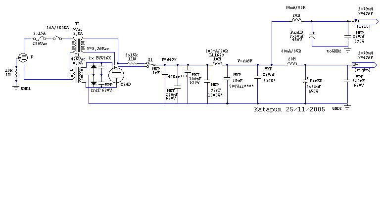

Some time ago I build a tube amplifier. Since then amplifier has a “little” problem.
ONLY when I turn power ON I listen a BIG SCRATCH in my speakers (95dB).
Any comments or suggestions are very welcome (and sorry my English).
Tube amp details:
1 x 274B
2 x 300B (2 x 60mA)
2 x 5842 (2 x 10mA)
itot=140mA+/-
B+=430Vdc+/-
PS: I only have one 274B tube. I listen nothing when I replace it by a GZ37.

I think you should check your schematic rather carefully, especially the connection of the diodes to the transformer (all of them!) - the way they are drawn in the diagram makes no sense and in fact the vacuum diode makes a short circuit every other half period of the AC.
The 274B is a directly heated rectifier, and will warm up quickly. The GZ35 is indirectly heated, and will warm up slowly. (Your schematic show the symbol for indirctly heated diode, but on the GZ34, the heater and cathode are joined at pin 8. I think this is just a symbol inaccuracy).
So, just to confirm what I understand:
With 274B there is noise,
With GZ34 there is no noise..?
If the power supply is the cause:
I think the "scratch" noise may be because of the ringing caused by the 2 * 10H chokes and the capacitor combination 1u + 270n + 100n + 33n.
If this is the case, try adding 220K 2W resistor across each 10H choke.
Of course there could be many other reasons, especially some instability in the amplifier as it warms up. This is just my "gut feeling".
The scratch you're hearing is probably from the rectifier arcing over internally at start-up, causing interference in the circuit via the 2 10H chokes. The 274B is a delicate tube, and quite prone to arc. Look at bright white sparkling spots on the filament during startup, this is usually a first sign of arcing, and a warning sign for more trouble. If you see this happening, quit using the tube in this application immediately, as the rectifier may fail in such a way that it takes other components with it.
I had the same problem with a 5U4G in a choke-input application (which should be easy on the rectifier during operation). The Russian version lasted longest, but eventually also started to sparkle and then arc. Directly heated rectifiers heat up so fast that the voltage rise caused currents to flow which saturated the input choke, which in turn caused the current to increase even more. With a GZ34 or GZ37 in the same position, measured current increases gently towards its nominal value as it heats up, and it comes nowhere near input choke saturation current (which, in my case, is about 500 mA) . As you have an input capacitor of only 1uF, your problem might be similar to mine, pushing the 2*10H chokes close to their saturation point.
There are two solutions: either a soft-start, that switches on full load after all tubes have warmed up properly, or a slow heating rectifier such as a member of the GZ family. The 274B reportedly sounds very nice, but it's too fragile to use without precautions.

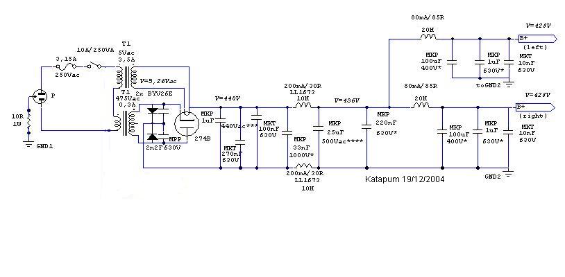

Hi all,
If the power supply is the cause:I think the "scratch" noise may be because of the ringing caused by the 2 * 10H chokes and the capacitor combination 1u + 270n + 100n + 33n.
I simulated all PSU with PSU2. PSU2 shows graphic without ringing problems.
274B looks ok at start up.
When I replaced tubes I didn’t change socket connections. Is GZ37 a DIRECT replacement to a 274B? If not how could I connect a 274B with two transformers (main and heater) without centred taps?
I fixed PSU schematic. Is it ok now?

QUOTE]The usual rectifier pin-out is pins 4 and 6 each to an anode, not anode and cathode as drawn.[/QUOTE]
Circuit Maker software doesn’t have more tube symbols. If you don’t like the tube symbol look only pins numbers.
Katapum
If you have wired the rectifier as indicated in your circuit, that's the proper way to connect the GZ37, as it is an indirectly heated rectifier with the cathode tied to one leg of the filament at pin 8. This is where the HT should be taken off the rectifier.
Now I'm still wondering about this scratching sound. Ringing in the powersupply could cause some artefacts, but not scratching or cracking sound. What kind of 300B's do you use? And do they look OK when they start up? Because this scratch could also be caused by the filament of your 300B when warming up. As the GZ37 applies HT much later than the 274B, any scratching caused further downstream during warmup might be masked by using the GZ37. It is good to know the exact cause of your scratch sound and cure it, rather than simply suppress the symptoms by substituting a rectifier.
A simple test would be: remove the 274B from its socket, and turn the amp on. Wait for about 20 seconds and *gently but quickly* put the 274B in its socket. If you still hear the scratch, you have strong evidence of a rectifier problem. If you don't, you know you should look further downstream.
