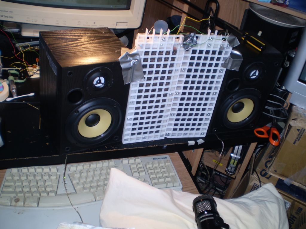

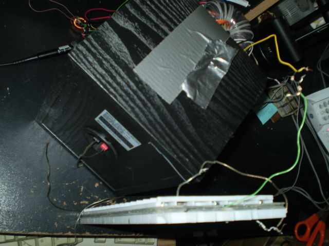

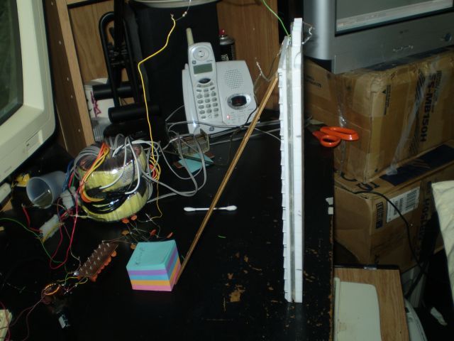

Basicaly what I did was lean the little panel against the corner of the little sony speakers that I used as woofers only (duct tape on the tweeter works good) and shoved them back in the cubby holes where the upper shelves are and is wide open.
Right now there is a monitor in one of those spaces so I may have to move the monitor or change it out for one of my smaller ones.
jer 🙂

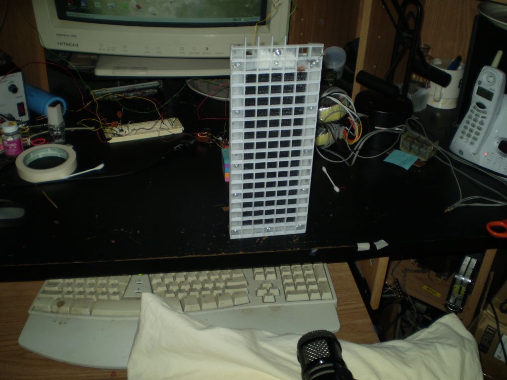

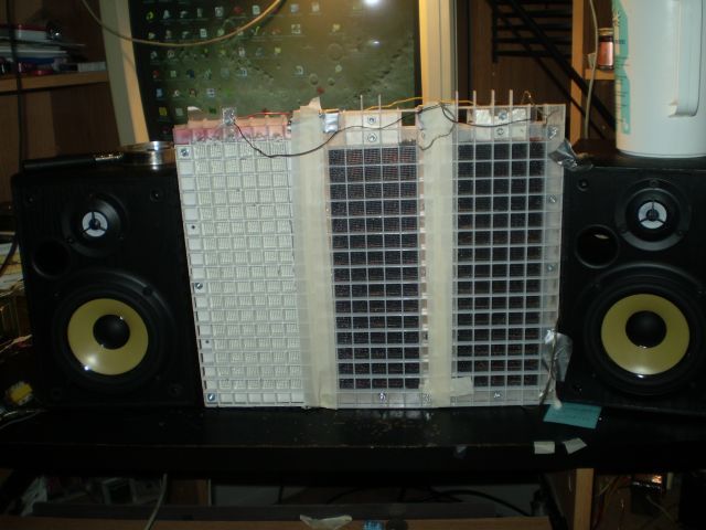

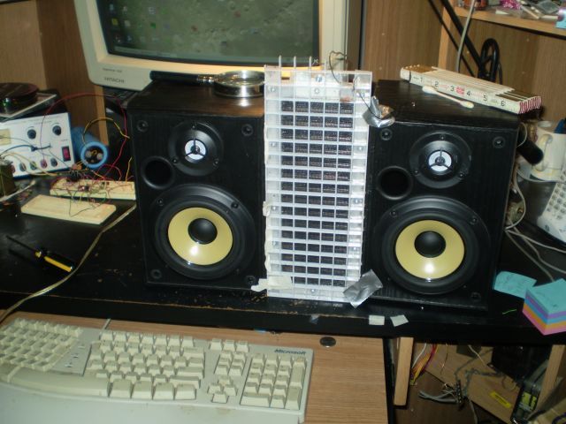

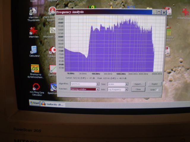

Here are the pictures that I had posted but couldn't find.
I was working on three things here,
1# Canceling the back wave,but no pictures of the fiberglass insulation or top baffle.
2# The effect of multiple panels and their angles.
3# how many panels it took match the same output level of the 5.25" woofer box at the same power level,it took 2 but 3 was even better.
This was before I had gotten my big amps back from Florida.

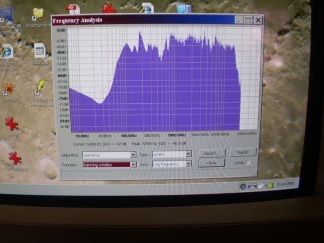

The frequency response curve are no EQ and EQed for one open panel.
The measurements were done with a Peavey PVM-520TN and a Phillips PSC706 16bit card.
The irregularities I am sure where from room reflections as later I had gotten a ruler flat response with no EQ with the panel at a different position in the room and added some room treatment to dampen the mid and high frequency reverberations.
I will be doing this measurement again as I now have a Gina24 24bit 96khz card and a Dayton measurement microphone with the calibration data as well as a SPL meter.
jer 🙂

The midrange hump in the frequency curve was most likely the refelctions off of the monitor as that distance is roughly the same as when they were set back into the cubby hole listening position.
As well as the early high frequency roll off may have been caused by the measuring devices limits.

My very first listen of an ESL was the MartinLogans just before I had finished my 8" X 22" panels.
Then I built my little panels modeled after my very first panels made out of some perforated aluminium material that had a very low open area and poor performance because of it .
The idea between the two sizes was one was 4 times larger than the other and I wanted to see if this actually would be 6db more efficient.
But the struggle of not having some decent transformers had set me back a bit until two years ago when I got back into it.
But I did have a good coating system down as I had built two sets of little ones,one using spray paint (one of those got lost) and the other set used powder coating,and what a world of difference the extra open area made using the PC method not to mention being able to run a much higher bias voltage.
But all in all they all sounded the same as the ML's that I had first listened to.
With the exception of bass extension they added no coloration to the sound and are clean and crystal clear.
So much so that they even fooled my dog into thinking it was raining and storming outside and refused to go out because of it, When the moon was out and shining brightly with no cloud in the sky.
I was listening to a tape of forrest sounds,Yes, A cassette tape!
He,he,he you had to be there to see that one !!!
This completely amazed me for such a smal set of speakers.
And for what it is worth I liked the narrower panels more because they were less beamy than even my 8" wide panels.
