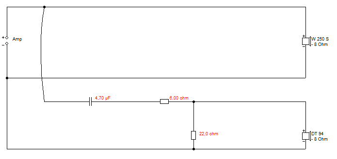

murphy, first order crossovers are incredibly rough and ready. You could fiddle with them endlessly, there is no optimum solution. 😀
Generally speaking, -3dB crossover is determined by the RC time constant. This is the product of the capacitor value and the load resistance. In the Dynaco A25, it seems to be around 4.7uF X 18 ohms.
18 ohms comes from the typical 12R series resistance and 6 ohms DC resistance of the tweeter in series.
Now I'd guess the SEAS 27TFFC is not going to be anything like as efficient as the old SEAS H-087 tweeter. So you are going to be reducing the attenuation.
You'll be using an attenuator here after the capacitor. As the overall load impedance gets smaller, the capacitor will need to get bigger. I think you'll need about 8uF with an 8 ohm attenuator which presents an 8 ohm load to the amp. How it works is hard to say. That tweeter is being driven very low IMO.
The circuit below is the basic layout. The values are to be determined.

WHO says it's an exact replacement? 😀
It's not. It's a smaller dome for one thing. But it is a modern ferrofluid design with far less Fs resonance. So it might work well enough.
It's a bit irrelevant to talk about crossover points with the sort of gentle slopes of first order filters.
But I expect 10R series with a 4.7uF might be a good start, if what you say is right.
Have a bash. Nothing will break if you don't overdrive it. And be prepared to fiddle with the values. 😎
FWIW, I used to have a SEAS H-087 tweeter in a B&O speaker on a second order filter. Nice sound.
